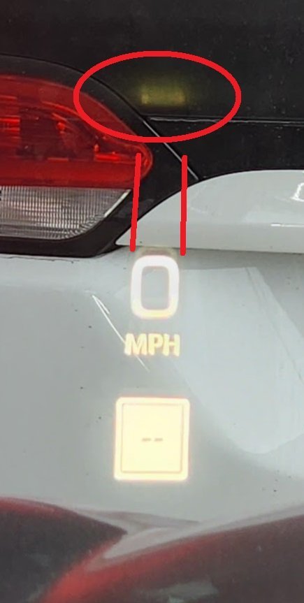

Just wondering if anyone else has bought a recent GMC Sierra platform with a HUD and if they have seen these "reflections" from inside the HUD.
I worked at a different company that made HUDs and IPCs for GM, Ford, and others and know a bit of why this is happening.
It's a surface somewhere on the inner mirror assemblies that isn't perfectly matte and is reflecting some light in an unintended path back onto the windshield. It's not the bezel at the top on the dash.
Not super obvious but enough to annoy me. I find if I adjust the height just to the top where it starts to cut off, the anomaly gets cutout and removed but any head shift vertically will start to impact HUD image appearance.
Maybe I just got a COVID unit....? Don't really want a dealership ripping my brand new truck apart but wondering if all HUDs have this (imo very low quality) issue.
20221212_123029.thumb.jpg.8f513fbc5057de3c6258316a69fa56a6.jpg20221212_123003.thumb.jpg.1a95292652e8e8ec1dc5c281951b8bbd.jpgJ
