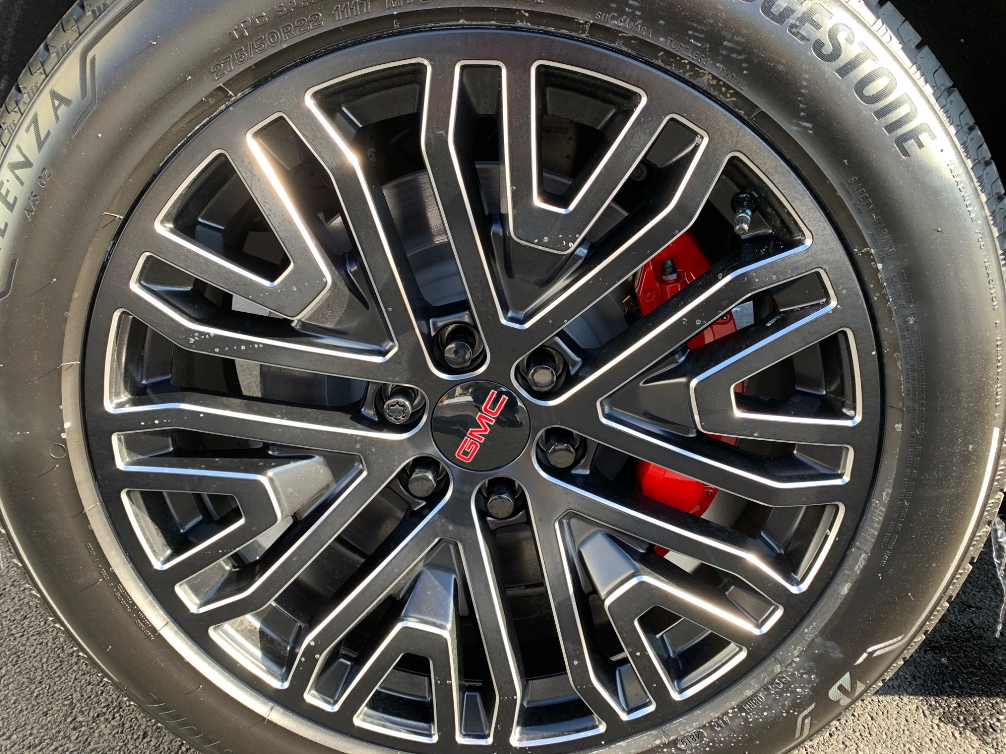

77BA309D-8AB3-427C-9A79-13EC52D34D96.thumb.jpeg.f727b9c8dda39a02fa319385aaea3b6c.jpegThe 6 pistons are when you get the Performance brake option, with Brembo brakes. I have them on my 2020 Denali, with factory 22” rims .
