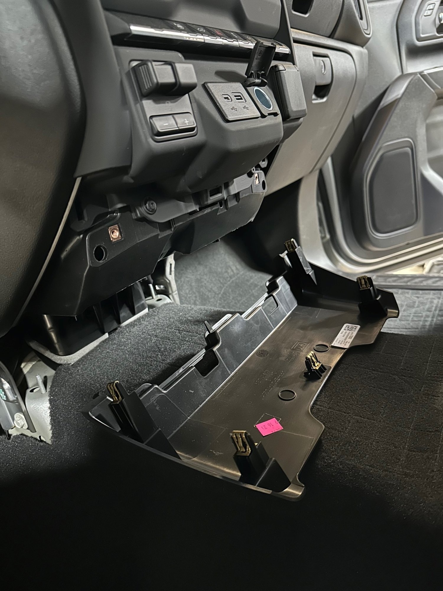

Started out by removing the lower dash trim panel.  1 7mm bolt on drivers side and 4 metal clips hold it on, and pulls off.
There is a 2nd trim panel that pulls straight out that is held on by I think 6 metal clips.

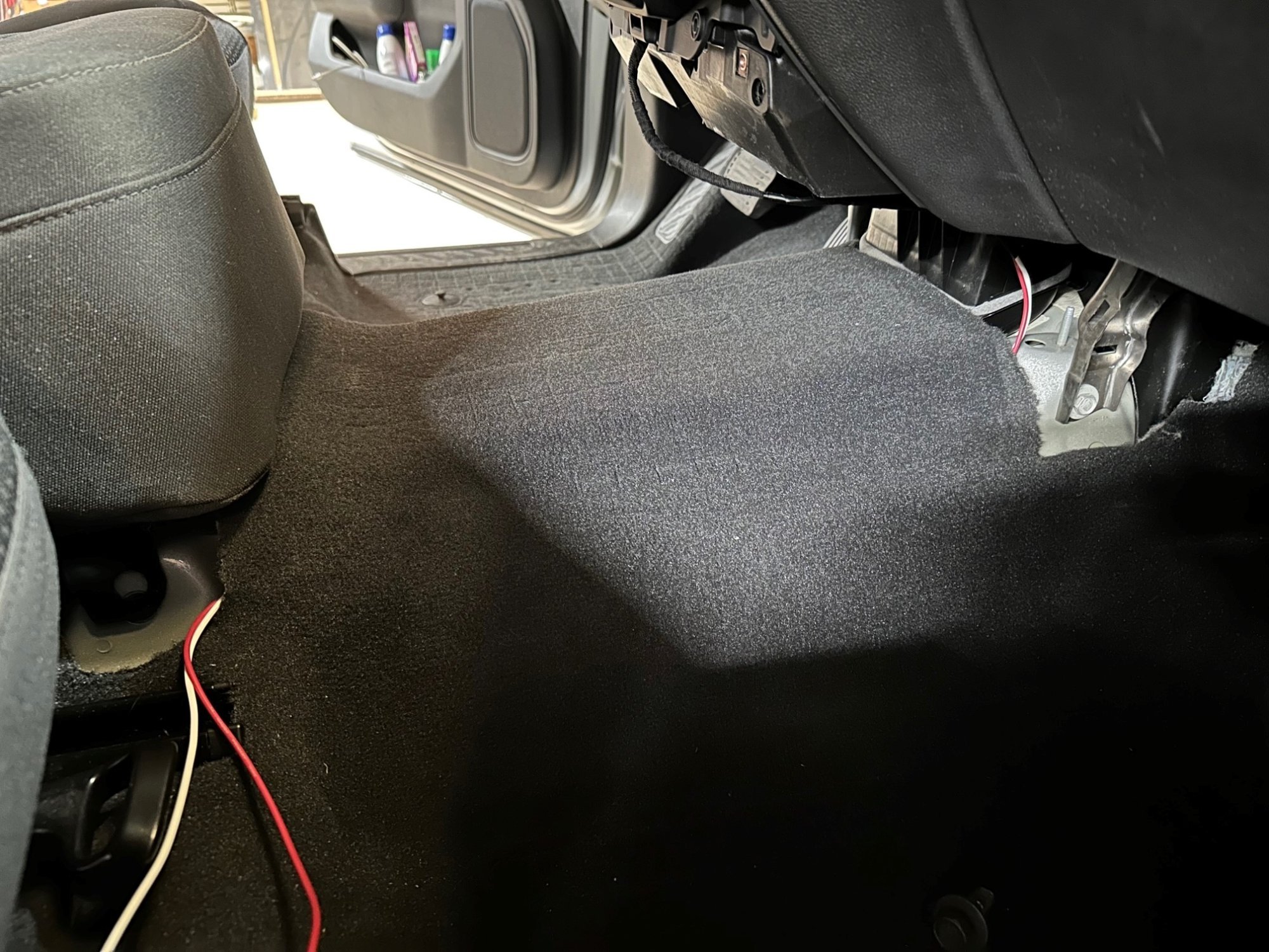

I then ran a red and white wire from the dash, under the carpet in the center hump, back to the jump seat.  Once I had the wire back to the jumpseat, I moved to the backseat area and popped the back panel of jumpseat off.  This is done by using trim tool to pop the side panels off first, then the center panel pops off as well.

install only took about an hour.  Hardest part was fishing the wires under the carpet.  My wire tool kept hitting the ductwork and binding up.  Our long road trips will be much more pleasant now without the kids constantly wanting stuff plugged in up front.  We got to the point where we were running an extension cord from the front 120v outlet up front, to the back so they could plug in (yes janky I know, but it worked).  Now they can simply plug in themselves in the back.  This is one install I'm glad I was able to get completed.  Such a simple, yet missed accessory missed on the Custom model.
