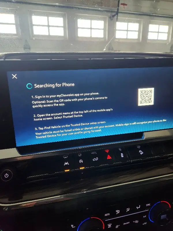

There are two things that might help that I can't figure out.
1. I changed the default assistant to alexa when I set that up. I can hear text messages through android auto so I'm hoping to change the default assistant back to Google. Anyone know how to do that? I can't find the setting.
2. I might have to set up a trusted device.  I have went into the mychevrolet app,  but I can't find anything about trusted device.

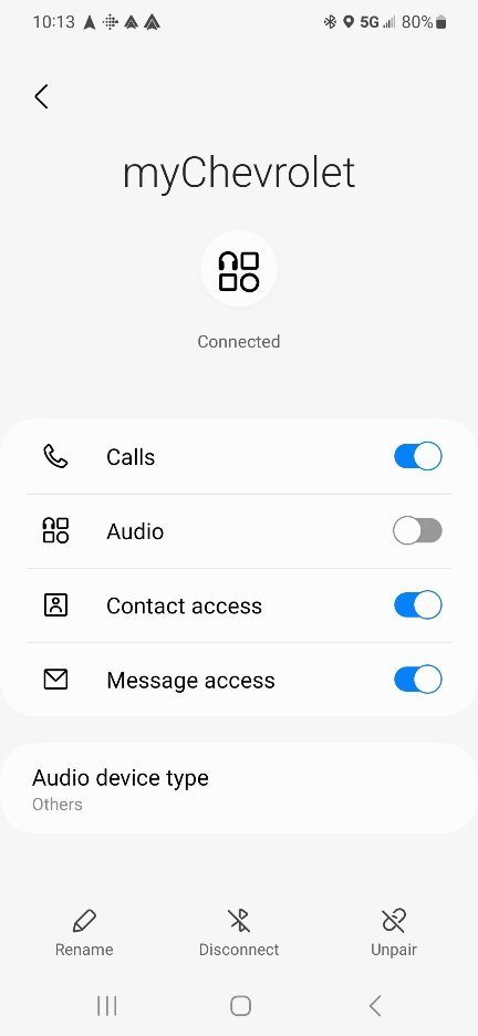

I feel like I'm making progress slowly on this,  but the feature is still not working.  I disabled alexa so Google assistant is now the default.  This caused a notification access screen to show up where I selected Google assistant to be active.  However when looking at the Bluetooth connection,  audio is unselected.  I have tried to select it but it keeps automatically unselecting.  Maybe this is my issue?
Looks like playing text is now working.   I believe that alexa may have been the culprit.  I disabled alexa so Google assistant is now the default.  This caused a notification access screen to show up where I selected Google assistant to be active. After that it seems to be working.  I told the dealership as well and they were glad to hear.
