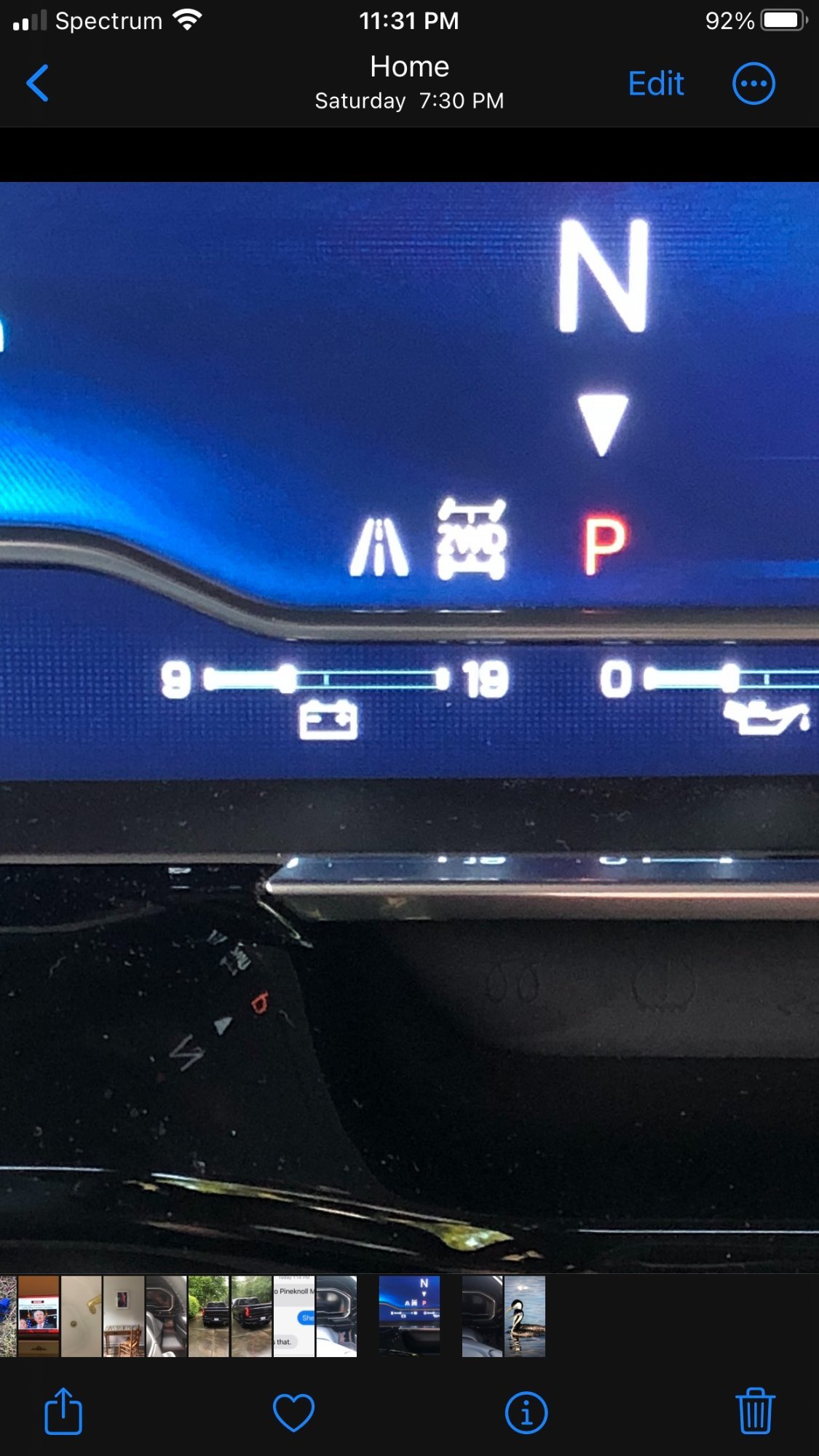

I drive the truck every day or every other day at the least.  Truck does not sit for more than a few days.  Trips are mostly short around town.  I'm wondering if running the A/C with the auto shut off isn't draining the battery and it doesn't have enough time to recharge on these short trips.  I'll turn off the engine stop for short trips and see if it recurs.
I did notice that the battery indicator is frequently below the middle of the indicator since the dead battery.  I never really looked at it much before.   I didn't see anything in the manual about what it should read.

4CC9CCA5-28FF-4B17-A30C-BB2E07AAF5CF_1_102_o.thumb.jpeg.393d2e9129f2724ad309a04b3bf227a6.jpeg
That pic tells the story IMO, infrequently driving it and using more battery than the charging system is putting back in. Take it out and drive it 50 miles without shutting down.   I been going round and round with my cousin who has same problem with her Jeep that sits for weeks and then she drives to post office and store about 10 miles and parks it for another couple weeks.   Jeep is 3 yrs only and less than 3,000 miles and never driven more than 30 miles in any one day.  Then she parks it for the winter and goes to Florida for 6 months and can't understand why she has battery problems.
Edited by elcamino
So what’s the minimum? Except when I drive my trip vehicle east our trips are short with the battery staying charged. My wife drives her Genesis 6 miles to town, starts it there. Drives fine miles to swim. Sometimes 3 miles to the store. Then five miles home. Her battery is 6 years old. My avalanche drives 5 miles, then starts again drives home. About 3 days a week. The other 3 the odyssey does the same. I think the problem is the truck.
