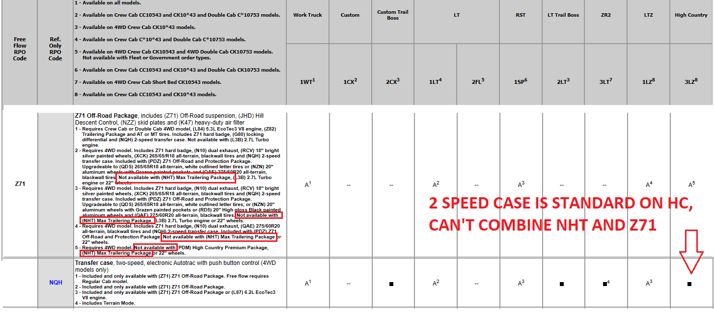

16 hours ago, DubVBenz said:
The only two speed transfer case solution with max trailering is Z71 on the High Country. So you almost confirmed my point, but are wrong about the Denali option, at least on the refreshes.
Its just the transfer case, not Z71.  Can't combine NHT max trailer and Z71 suspension.  Its either or.  Been this way since 2010 when NHT came out on the 6.2 trucks back then.  You could order a 6.2 with Z71 or you could order with 4x4 and NHT but you could not combine Z71 and NHT because of the shocks/spring rates.
I did forget that you can't get NHT or X31 on Denali.
From the 2023 and 2024 order guide:

IF you can find one on a lot, it will be on LT, RST, LTZ and High Country trim levels in Chevrolet, SLE and SLT in Denali.  If payload is important and you really still want the 3.0, the lower trims will offer better payloads and actually the crew cab 5ft8in typically payload higher as well.  Still, its not going to be past 1600lbs by much for a 4x4 3.0 max trailer of any configuration due to engine weight and emissions equipment (heavier exhaust, DEF tank).
Also, you won't be able to order one as its no longer available to order with the diesel for the rest of the 2024 model year at the moment.  You can order a 3.0 but you won't be able to order with max trailer and the 3.0.
