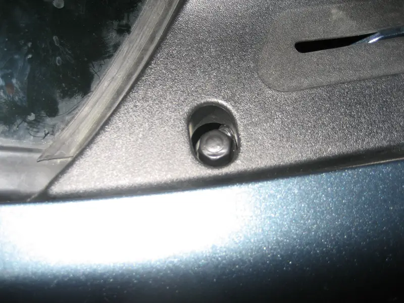

I just did this to my NBS and the reception is every bit as good now as it was before. I do live near the city though so I can't speak to how it may behave in the more rural areas.
I used 10GA wire and two loop connectors, although I did have to Dremel them out just a bit to fit. I found a 7mm nut and bolt and used the nut, along with a flat and lock washer on the post, and the bolt with both washers on the antenna. I did, however, zip tie the antenna under the lip of the fender rather than the above it as in the pictures in this thread. I wrapped a little electrical tape around the antenna anywhere it was in contact with the body and applied a few coats of Plasti Dip over the exposed nut and stud and let it dry before replacing the cowl piece. I also used heat-shrink tubing on the wire I made. With the recess and small size of the hole in the cowl, most people would never even know there was supposed to be an antenna there. The Plasti Dip should keep the corrosion away. BTW, the cowl piece just pops off. No screws or fasteners.
Daddy
EDIT: Added the pics. I was just being lazy before. Please excuse the dirty ass truck. It's been nasty around here lately.

the cowl piece that pops off, do you mean the piece around the antena hole? Broke my antena and was wondering how to take that piece off to get antena base off? Just kinda glanced at it and it looks weird.

Yes, open your hood and begin lifting the side farthest from the fender and it should pop right out.
