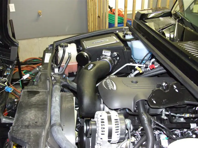

OK. So I went ahead and ordered the Volant PowerCore CAI. Has anyone had experience installing on the 6.0 V8? Was it difficult?? Please share your experience. Thanks!
Maybe too late to hepl you, but it pretty easy putting one in my H2. Only took maybe thirty minutes. Results were a slight increase in noise, but none in seat of the pants performance. I can't say it was worth the $600+ I paid for it and the MAF it included.
The product itself is the real deal. A no-kidding CAI, unlike the myriad of others which are actually hot air intakes such as the K&N parts. Perhaps there is some increase, and that would be found on a dyno. Thinking about it a 5 HP increase on a 5,000 pound truck will be lost, so consider the bang for the buck impact of this purchase.
I couldn't agree more. Not much noticeable hp increase unless its above 3k rpm. Mine is a 7K lb truck and I need more lower end torque. I'm going with a westers custom tune next so hope this will wake her up. Right now she is still a little lazy
I put the Volant on my 2004 Sierra SLT PU but removed it after 1 yr and about 15,000 miles if use. Several things bothered me about it. The think made so much noise when you were giving it gas, a loud drone that made the truck sound like it was straining to move. Another thing was I had the Ram Air tube and every time it would rain hard it sucked water up into the air box and soaked the filter. Once on a long drive from Minneapolis to da UP in rain the truck was stumbling at cruising speeds. Did not know at the time that water was the problem but on a hunch the next day I discovered lots of dirt in the bottom of the box as well as moisture and a wet filter (before Powercore). The Volant came off that day.
