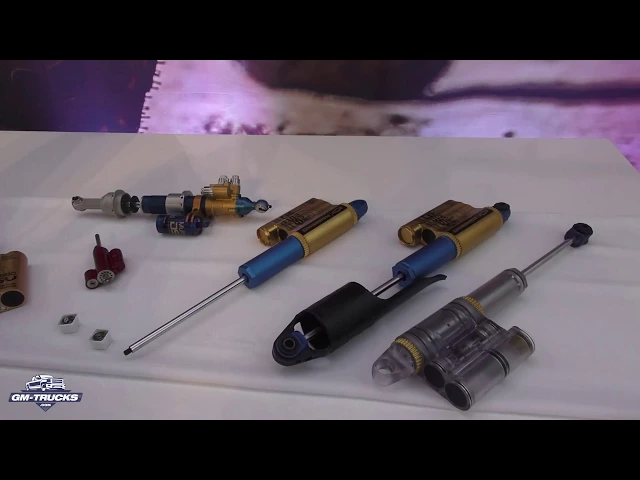

So these two valves, we can show you, we have, there's actually three in total in the damper
1:43
We have a cutaway, or a plastic transparent damper here, so that's just a plastic version of that guy
1:51
And the two main small valves, one for rebound and one for compression six
1:56
in the central chamber The outer chamber is just a gas reservoir It happens to be an incorporated all in one piece but that could be a remote reservoir but it all attached in this one So we got the two in the valve body

to recoup underneath the piston. Once the piston passes these holes, so you can actually
3:01
see this at some point, see the piston goes past those holes, I can see that, but the piston's
3:09
passing it. And once the piston passes those holes, the oil is trapped between the piston
3:15
and the bottom of the tube. And the only way place for it to go is back through the piston
3:20
So there's a third independent small valve inside the piston itself that controls the compression
3:25
forces towards the end of stroke. So that valve is a lot stiffer than the main valve
3:30
So as you approach end of stroke in a big off-road event, it absorbs a lot of energy in
3:35
the last third of the stroke of the damper. So that's the position sensitive bit, the PSD as it's been, as we call it

So taking the spool technology from the Camero and applying it to the gear
5:59
and how it works is when you driving on the road the piston is moving up and down in the middle of the damper So it doesn get to the extremes When you can press the damper over bumps the piston gets pushed all the way to the bottom of the damper
6:19
Our architecture allows the damping characteristic where the piston is down here to be different
6:24
tuned, and optimized just for that region, separately from driving on the road
6:28
So the oil flows inside this range, out these transfer ports, through the angular space across the bridge and through the valves
6:39
And then in a rebound, it's going the opposite direction. It's coming up the inside tube and out between the two tubes and back through the valves
6:47
the rebound valve. But when you end up bump, the piston goes past those transfer ports
6:52
There's nowhere for the oil to go. So it would be hydroly for lock except that we added that third spool valve on the piston
6:58
which becomes active under the forces past the port transfer ports. and then it's tuned optimized just to manage the loads of the huge challenge
