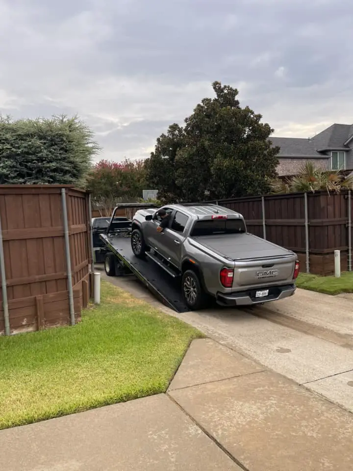

Some owners have woken up to a dead truck in the morning. Others have come back to a dead vehicle after driving it somewhere. Many have ended up having their vehicles towed to dealerships because even jump-starting isn’t a guaranteed fix.

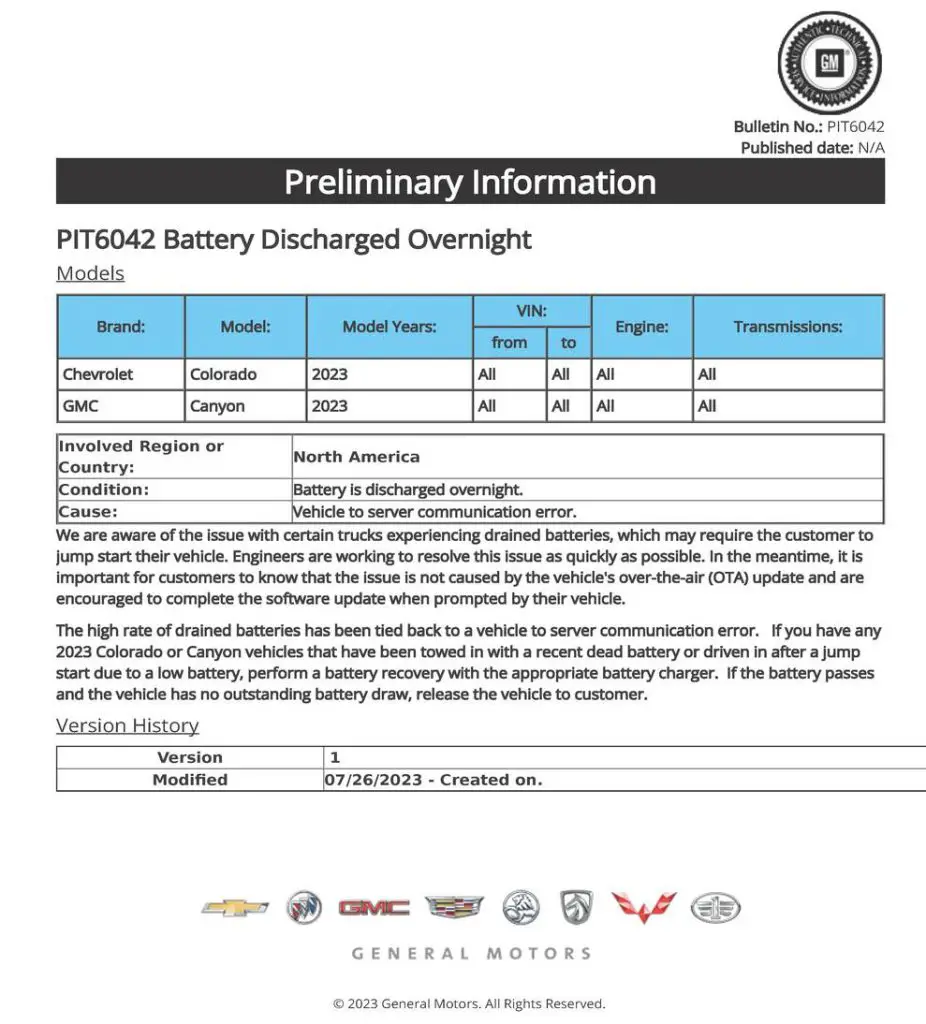

2023 Colorado / Canyon Dead Battery Service Bulletin
In July, General Motors released PIT6042 detailing how “we are aware of the issue with certain trucks experiencing drained batteries…” How many trucks are “certain trucks?” Well, we’re not exactly sure. However, the issue is related to Over-The-Air (OTA) updates and server-to-vehicle communications not being completed in the correct manner. The OTA either doesn’t finish or doesn’t disconnect from GM’s servers when finished, and the vehicle’s battery drains at a higher rate until it’s dead.
The fix in July that doesn’t seem to work for today’s problems is to simply charge the battery. In July dealerships were told to charge, check and see if the battery is still good, and send customers on their way. GM also recommends that customers apply every new OTA update to make sure they are running the latest software to prevent this issue from happening again. However, as we now know, the issue is still happening. We also know that charging the battery after it goes dead may not fix the issue or resuscitate the vehicle.

“Thought I was safe from the dead battery issue. I’ve had my TB since 6/25 and it’s been fine until yesterday afternoon. Completely dead, had to open door with the key and then jump it with a boost pack. Truck was undriveable, no power steering, no brakes, and about five other less critical error messages. By the time the tow truck came about two hours later it was fine. Started right up and no error messages. Had it towed anyway, will know more tomorrow at some point. Only good thing is that I was home at time, not stranded somewhere.”
“My Denali did the exact same thing Friday morning. Towed to dealer, they found a bad cell in the battery and replaced it. Same thing also happened to me in July, and then the battery tested fine. I really question if that battery is the issue since sooooo many owners are having the same problems.”
“Well my truck did the same thing went to the store and when I came out a dead battery again, I tried jumping it know such luck, it’s getting to the point to get rid of it, we all need reliable transportation that we can count on, not wondering if my truck will start or be stranded somewhere else vice at home or store. I think GM rush into this 3rd generation vehicle, with all the issues everyone is having it’s frustrating for me.”
“Same boat went out last night to go to the store and truck was DEAD had to use the key to even get in. Charging the battery now hope she starts with no errors or fixes it’s self quickly.”
