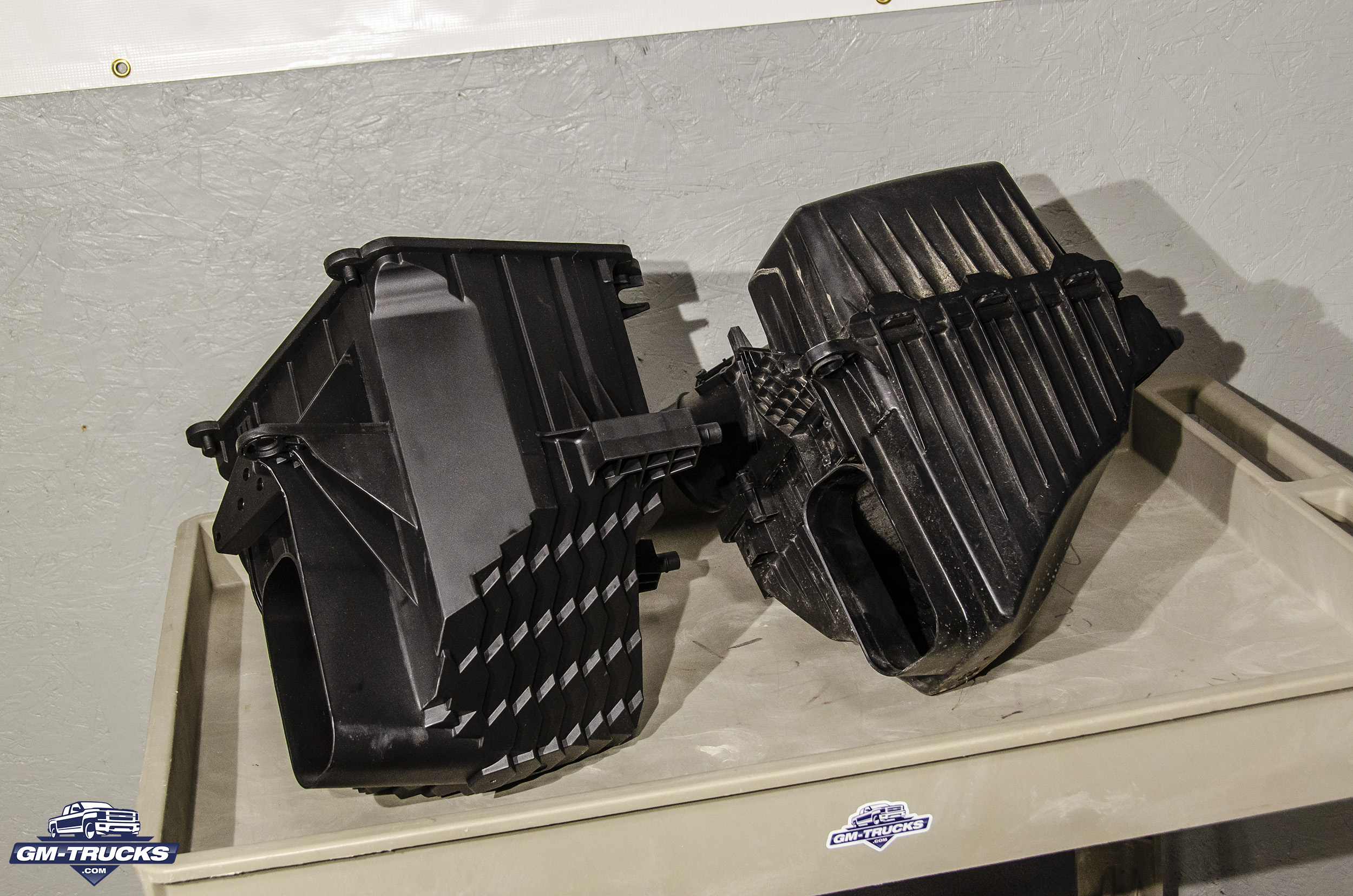

Chevrolet Performance Cold Air Intake
The new Chevrolet Performance Cold Air Intake box is on the left – Our stock Silverado intake box is on the right.

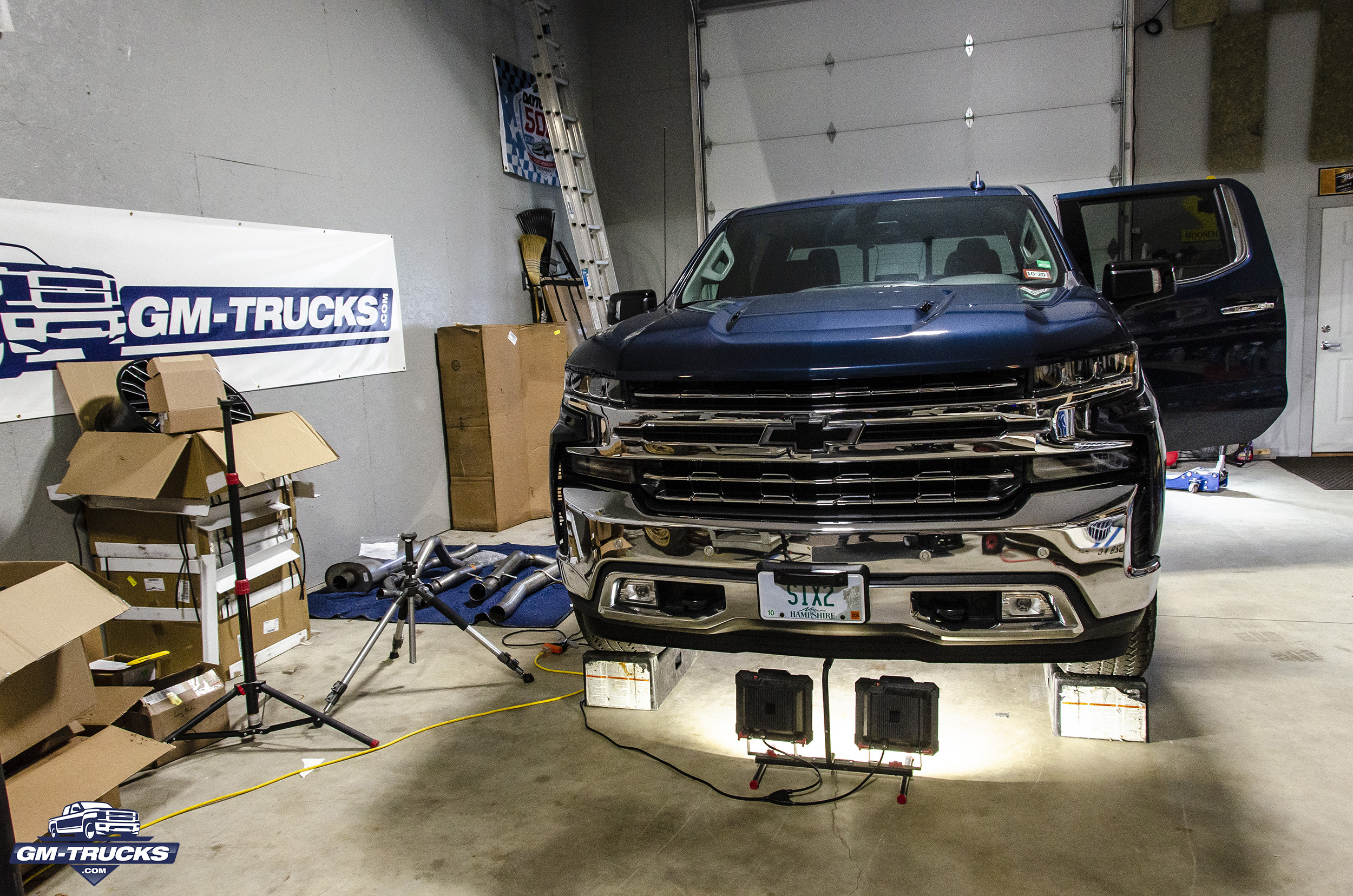

Chevrolet Performance Intake & Exhaust Install
We don’t own a lift. So we made to make due with two ramps and two jack stands. We had no problems!
You cut the old exhaust out. This is the route we chose, because it was really quick, super simple, and we don’t have a two post lift. In fact, we didn’t have any lift. So our install was dependent on our ability to take the old exhaust out and slap the new exhaust in using only two ramps and two jack stands.  Sure, you lose the ability to re-install or sell the stock exhaust but who cares? Used stock exhaust systems are unfortunately not worth the money for the effort. We saw cutting our factory unit out as the most efficient route for our situation.

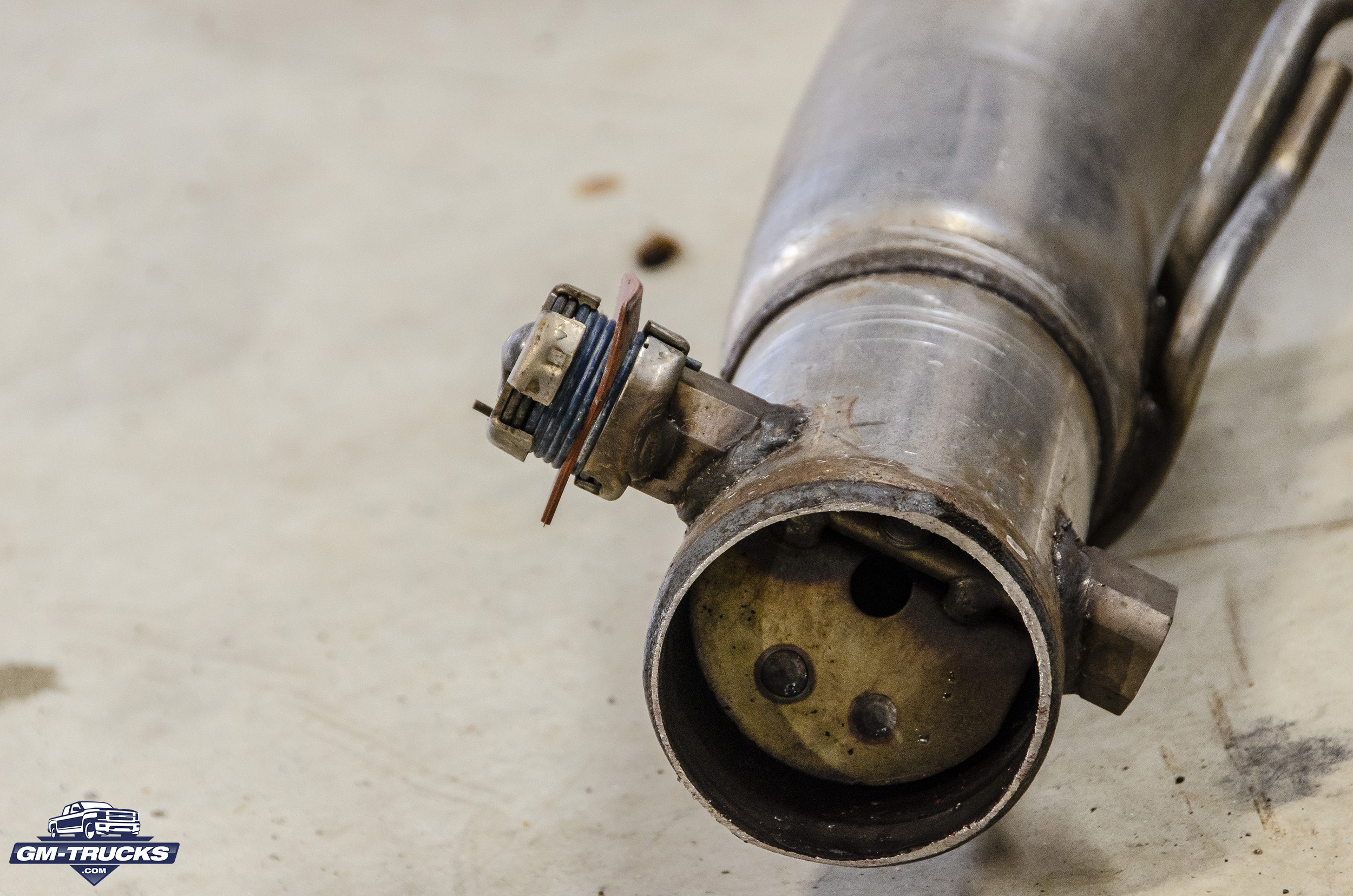

2019 Chevrolet Silverado Stock Exhaust - Passive Valve
Our Silverado’s stock exhaust has passive valves that quiets the sound and the performance.

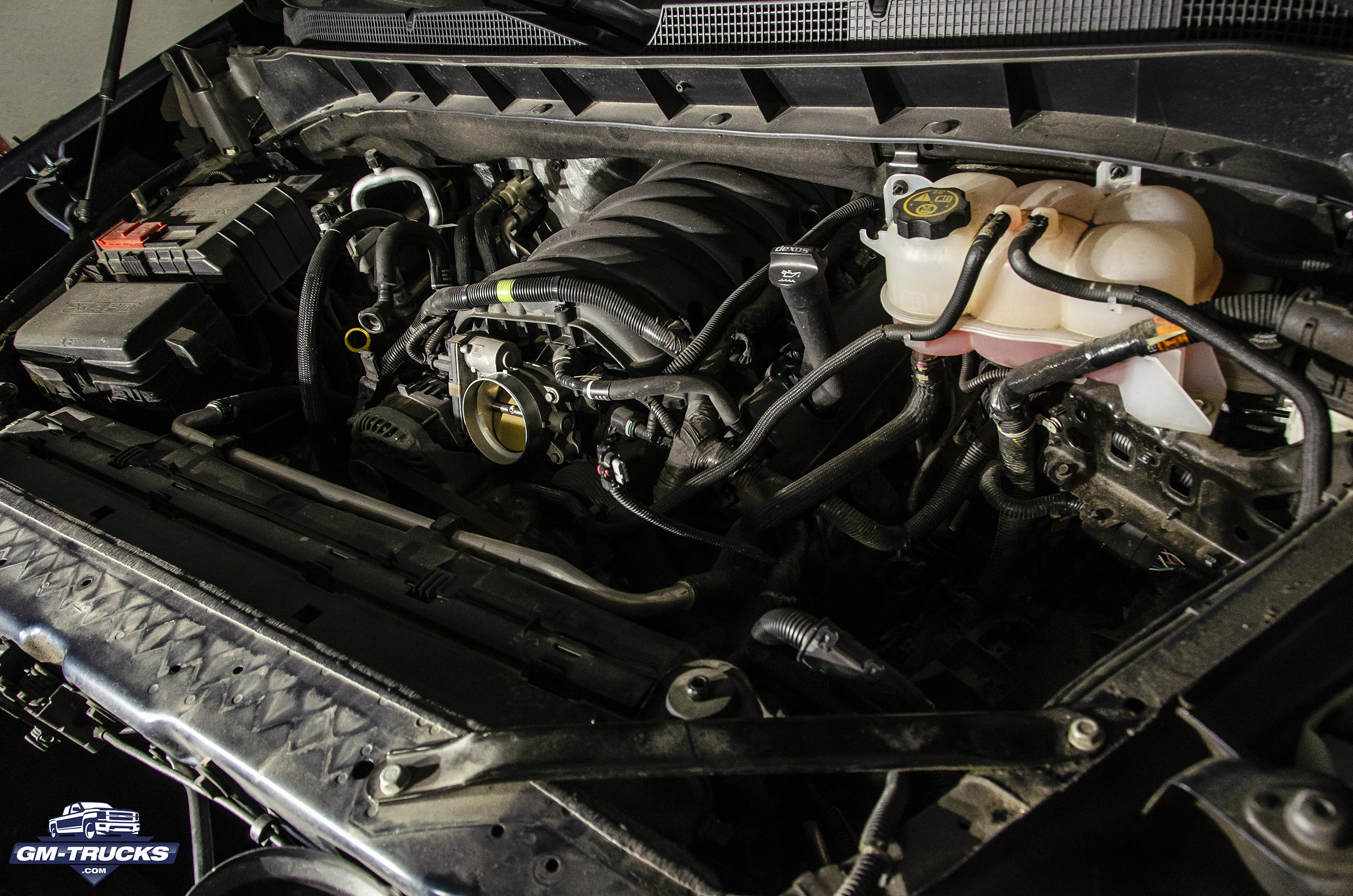

Chevrolet Silverado Engine Bay
With our factory intake removed we were ready to get started installing the Chevrolet Performance Cold Air Intake
First we removed our factory air intake. To make this whole install easy we recommend a torx bit set, an interior trim removal kit for the push pin fasteners, a nitrile glove to protect the mass air flow sensor, a set of screwdrivers and a standard socket set.
We put our mass air flow sensor inside of a nitrile glove to protect it while it was outside of the vehicle because this sensor is a very important part of your engine. Any damage, dust, dirt, or oils you get on the MAF will most likely cause a problem. The MAF sensor measures how much air enters your engine and almost every calculation the engine computer makes is based off how much air is metered. A non functioning or poorly functioning MAF sensor is bad news. In fact, Chevrolet Performance has computer calibration that needs to be applied to your truck after the Performance Cold Air Intake is installed to ensure the MAF sensor knows what’s going on. More on that later.

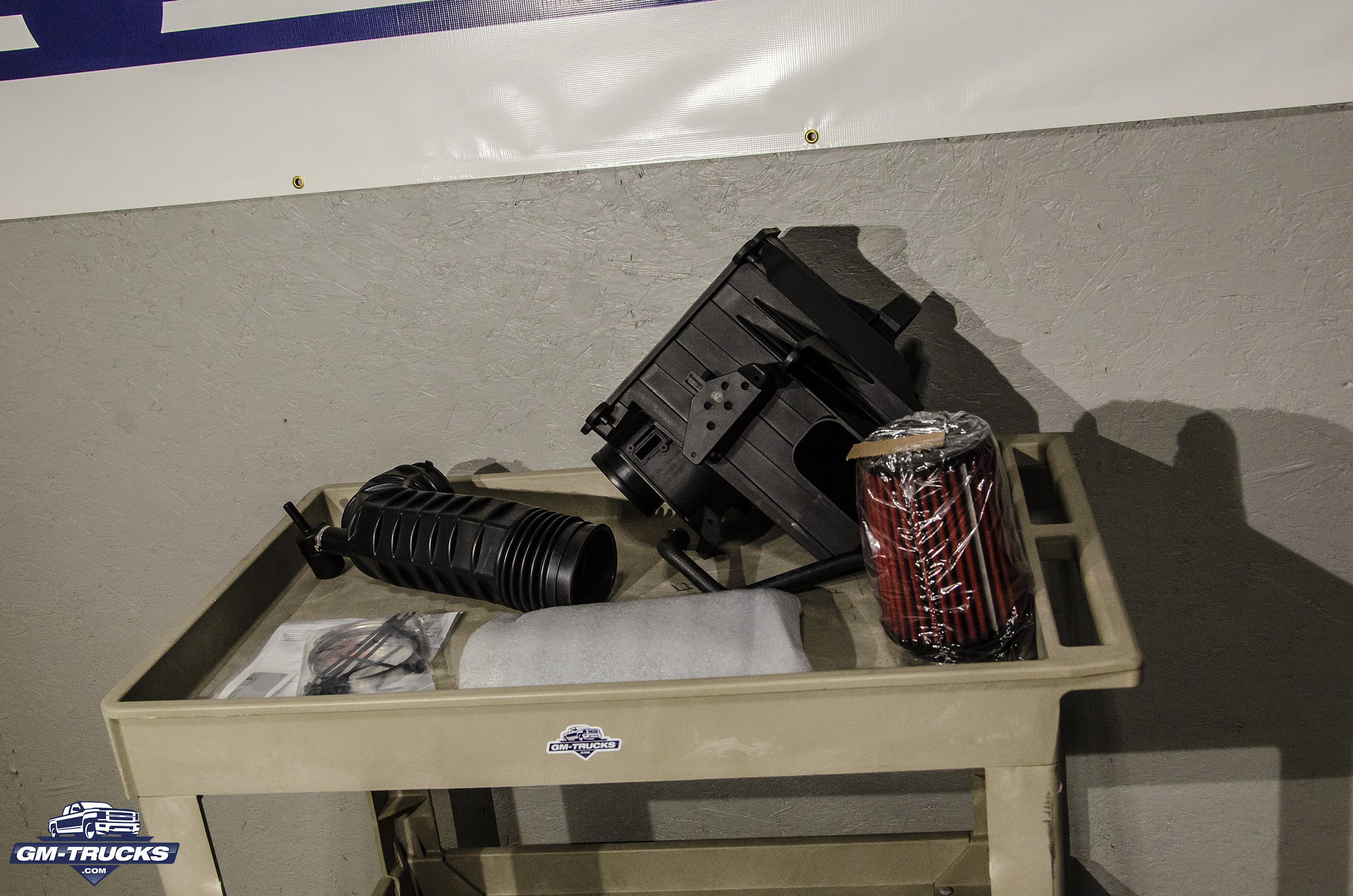

Here’s the entire Chevrolet Performance Cold Air Intake Laid Out before installing
Once the stock intake is out we started assembly of the performance intake. First, we transferred some rubber grommets from the stock intake to the performance intake box.  Then, Chevrolet Performance wants you to install the air filter into the intake box and secure the clear cover before you drop the intake into the engine compartment. The filter needs to be inserted in a very specific way, so be patient and pay attention.

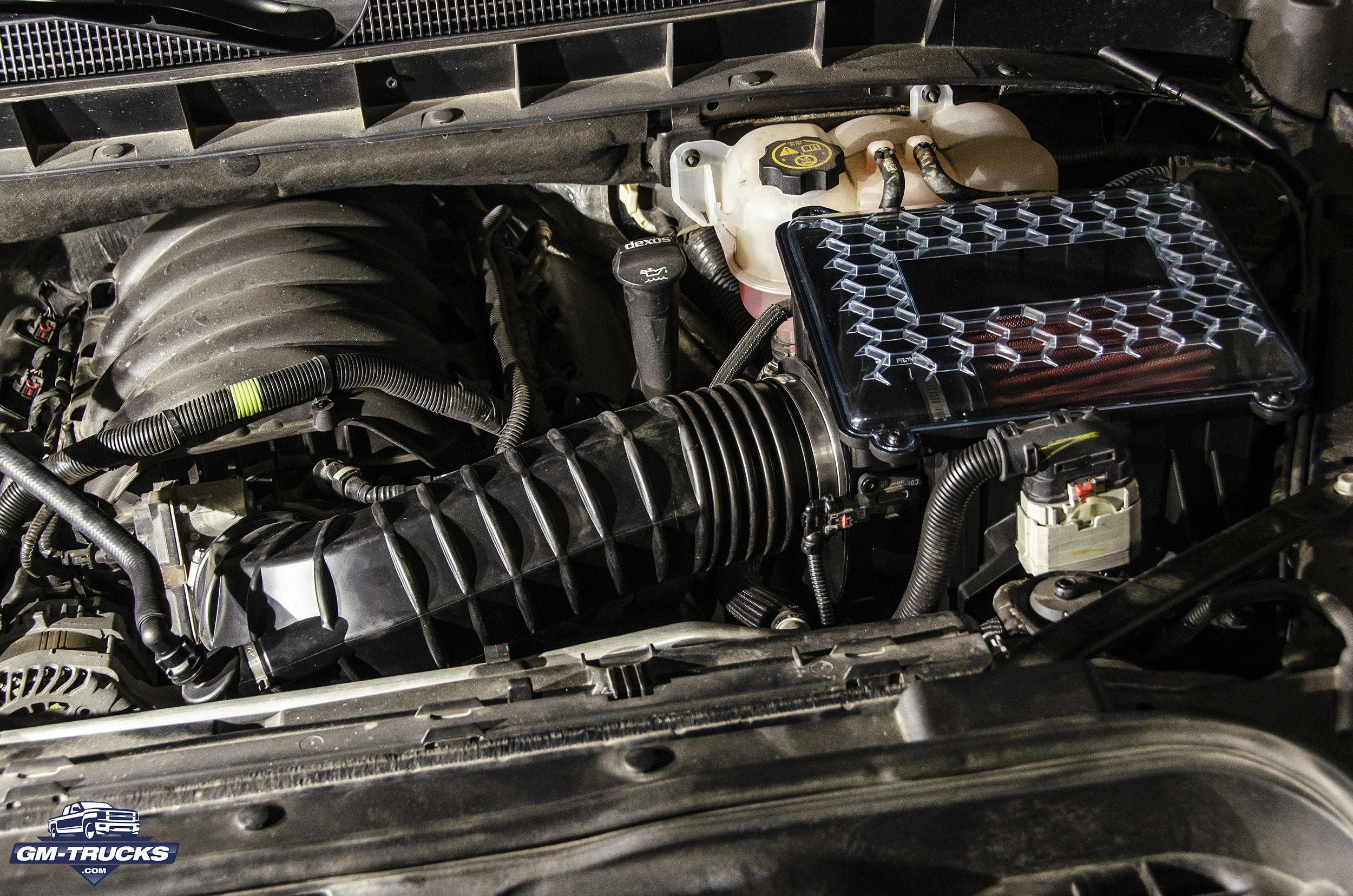

Fully installed – Chevrolet Performance Cold Air Intake
Once we had the performance air box assembly together it was time to place it in the engine compartment. The box doesn’t drop directly down into the space the old air box vacated. It’s also a little bit taller, so while fitting the performance intake it’s best to take your time and not force anything. Watching the video that goes with this review, you’ll see it took us a little bit of time to figure out how to best insert the performance intake box. However, with only a little bit of fuss we were able to get it in without problem. Remember, you won’t need to force anything- just find the right angle by watching our video.
Once the intake box was in we were almost home free. We just make sure the intake snorkel was lined up and fit tightly with the intake box. Then we slipped the hose clamps on to the intake tube and fit it into place.

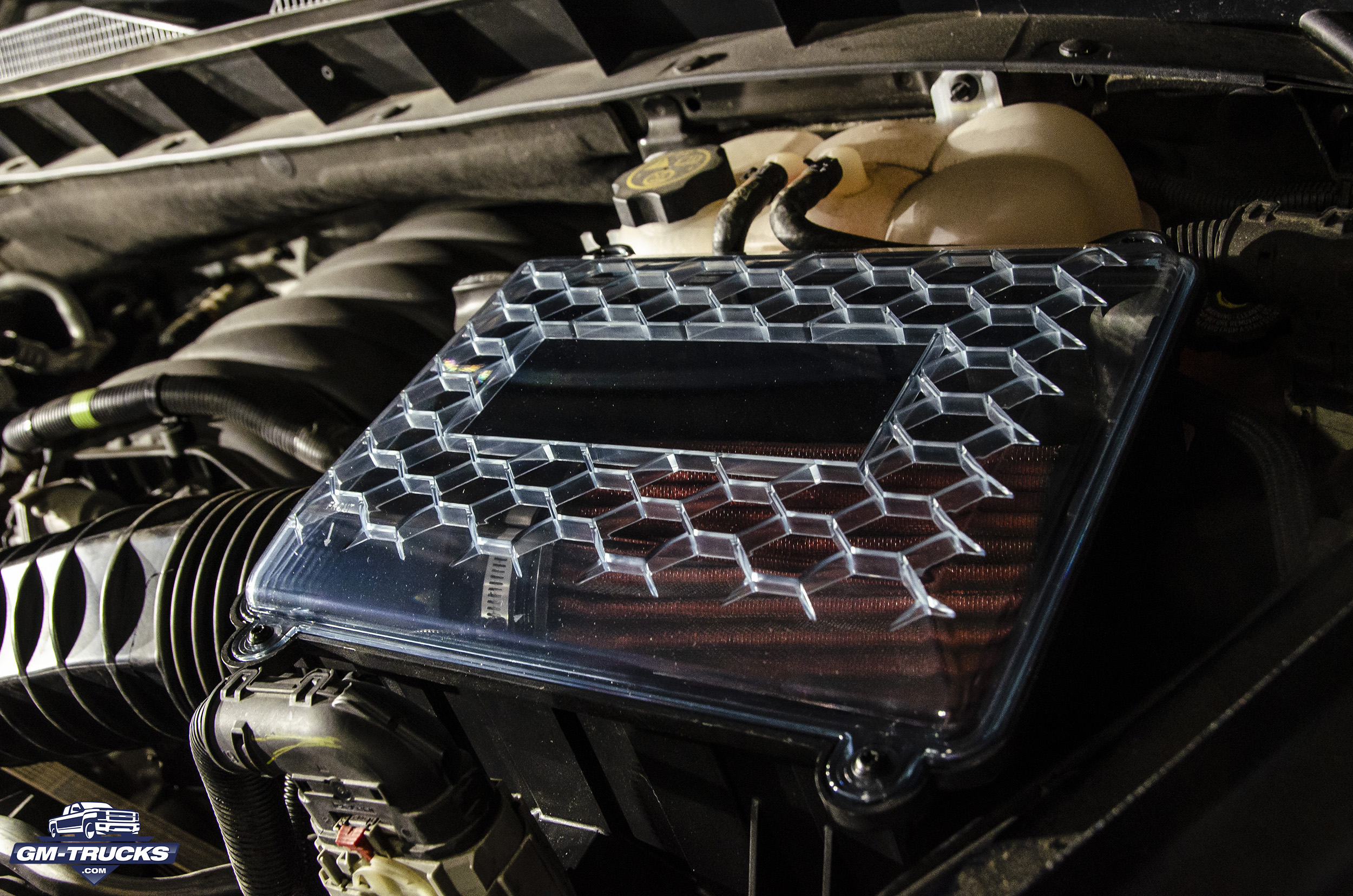

The Chevrolet Performance Cold Air Intake looks way better than the stock intake. No debate.
With another performance intake we’ve tested in the past, the intake tube was hard to wiggle into place and get lined up between the throttle body and intake box. The Chevrolet Performance Intake did not have that problem. Within a minute we had the tube installed and tightened down into place. A quick change of the stock intake “breather” hose with an included longer version and our intake was complete.

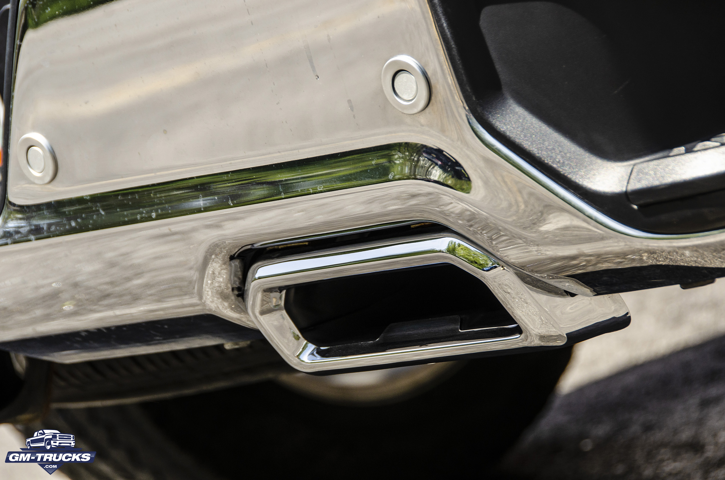

But while the intake is hidden under the hood most of the time to be forgotten about, the The Chevrolet Performance Exhaust is divine and a defining characteristic of our Silverado. Louder than stock but won’t annoy your neighbors. Throaty but pleasant to the ear. No annoying drone.
Since the Chevrolet Performance Exhaust uses our stock bumper outlets, it’s hard to tell anything is different by eye… but by ear our truck is 100x meaner.
