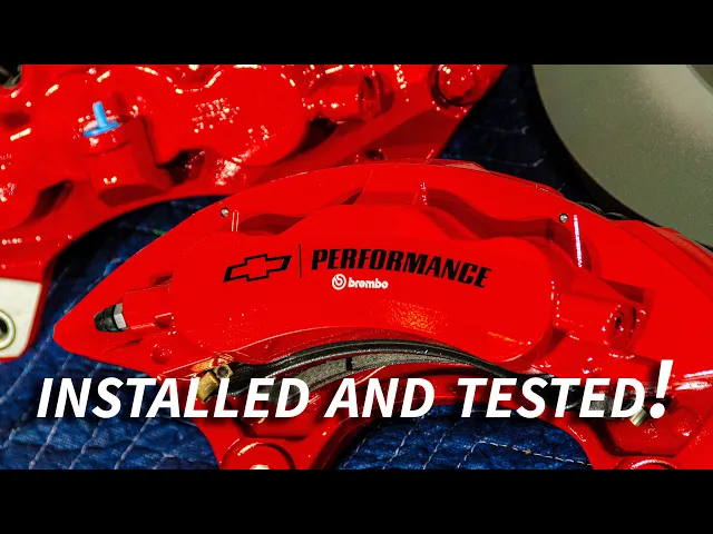

Hi, I'm Zane Mirva from GM-Trucks.com, and if you've taken a look at the Chevrolet Performance
0:05
catalog after buying your 2019 plus Silverado, then you've probably seen a lot of really
0:11
cool stuff, including the Brembo brake upgrade package. No doubt you've taken a look and seen that big price and your eyes have gone wide
0:21
You know, if you're like me, you've always wanted to put a Brembo brake package on your
0:25
truck or car, but the cost has probably been prohibitive. Now Chevrolet Performance is offering a turnkey upgrade for your truck that fits exactly like
0:35
a factory set of pads and brakes would, and is just as easy to install as a normal brake change
0:43
So let's take a look at the Chevrolet Performance Brembo brake upgrade, what it's all about
0:48
how much it costs, what it gets you, and is it really worth the price
0:55
The Chevrolet Performance six-piston Brembo brake kit is eye-catching, massive, and costs
1:01
more than your typical upgrade. It's also available in any color that you want, as long as it's red
1:08
The package is split into two options, front and rear. The real performance gains come from the front set
1:15
These are real six-piston Brembo-sourced and designed calipers. They come with huge 16.1-inch rotors, and everything seamlessly replaces your stock hardware
1:27
Out back, the rear calipers are painted the same bright red, but mirror the configuration
1:32
of the stock rear brakes. Compared to the factory setup, the difference is striking, if not a little comical
1:40
But when you find out the Brembo upgrade increases pad surface area by 90 percent and rotor area
1:46
by 20 percent, it all makes sense. In fact, the size increase is so large, Chevrolet Performance warns buyers that vehicles they
1:56
are installing the Brembo upgrade on must have at least 20-inch wheels for everything
2:01
to fit. That's okay for us, because we're running BFGoodrich KO2s on our factory 20s during
2:07
the winter and have a set of Chevrolet Performance 22s for the summer
2:12
But we'd be remiss if we didn't mention the cost for the Chevrolet Performance six-piston
2:17
Brembo brake upgrade, which has a list price of $2,895 for the fronts and $575 for the rear
2:28
This is no doubt steep, but as you'll see, worth every penny
2:32
So here it is, the Chevrolet Performance Brembo brake upgrade. What does it cost
2:38
What does it get you? How hard is it to install this thing? We're going to take a look
2:42
We've been driving with this upgrade on this truck for the past few months, and I
2:46
can't wait to tell you all about it. So first off, let's take a look at what it looks like coming out of the box, and then
2:52
we're going to see what it takes to install these parts on your truck
2:57
The first step is disconnecting the battery. We do this because the Silverado's brake controller can sense a loss in brake fluid
3:04
even when shut off. We installed the Chevrolet Performance six-piston Brembo brake kit in our garage over the course
3:12
of two days. If you had more experience in tools, we think you might be able to do it in one
3:18
If you have no experience or tools, your local Chevrolet dealer can also install this upgrade
3:25
Up front, installing the Brembo calipers starts by removing all of the factory components
3:30
and disconnecting the brake lines. That's easy enough. Once the stock rotor and caliper were out of the way, we also had to remove the front
3:38
wheel bearings to swap out the factory dust shield for a larger Brembo dust shield
3:43
That wasn't as easy, but still wasn't too hard. After carefully retightening the wheel bearing and axle nut, we assembled the brakes back
3:51
in reverse order. Rotors first, then calipers and pads. Finally, we reconnected the brake lines
4:00
The rear upgrade kit is even simpler. Just swap the red rear calipers, which include electric parking brake actuators, to match
4:07
the red front calipers. We reused our factory rear rotors since they had almost no wear on them
4:14
The calipers come with new pads. So there you go. Now you've learned about what the Chevrolet Performance Brembo brake package consists
4:22
of, what its benefits are over the stock brakes, how much it costs, and what it's like to install
4:28
So let's get these wheels on and get out on the road and talk about the practical benefits
4:32
and what you can expect if you invest in this upgrade. After power bleeding our brake fluid and reconnecting the battery, we bedded the new
4:40
rotors and pads through a few hot stops and cooling cycles before normal use
4:45
And just like that, we're ready to enjoy our Chevrolet Performance six-piston Brembo brake upgrade
4:55
Behind the wheel, what can you expect with the Chevrolet Performance Brembo brake package
4:59
Well, the way I see it is it really slots into three different categories
5:04
Safety, towing, and performance. You're going to see improvements in all three areas
5:09
One with safety. Emergency braking situations are now no big deal. With 90% more braking area on the front brakes, you get a really nice grip when you first
5:20
get into the brake pedal, and sports car level performance when you really hammer into it
5:27
No car stopping in front of you or truck is going to catch you by surprise, and you will
5:31
always have enough braking distance with the Chevrolet Performance Brembo brake upgrades
5:37
Towing with the Brembo brake upgrade is a pleasure as well. Not only does it give you better stopping power and more confidence, but you can trailer
5:46
heavier loads as well. It's nice to be able to know that your truck can stop whatever you have behind it and feel
5:53
confident at the same time while you're driving anywhere, any situation, with any amount of
5:59
weight behind you, of course, within your truck's ability. One of the reasons you may want to get the Brembo brake package is just the sheer increase
6:08
in braking performance. Instead of a full-size truck level of braking performance, you're going to have sports car
6:15
level of performance, similar to a Camaro, which is hard to believe from a full-size
6:20
truck, but that's what you get with the Brembo brake upgrade. The Chevrolet Performance Brembo brake upgrade is not only going to give you 90% more braking
6:34
area in the front pads, but it's also going to upgrade you from a four-piston setup to
6:39
a six-piston setup on the front brakes. That increased braking pressure is going to give you more confidence in everyday activities
6:47
from towing to driving, performance. You're going to have a lot more confidence in your truck, and that it's going to be able
6:54
to perform whenever you need it to and bring you to a stop safely
7:01
So while I was never disappointed in the stock brakes of our 2019 Silverado, the Brembo brake
7:07
upgrade is truly impressive. Off the top of my head, I'd say it gives me twice as much braking force as the factory brakes
7:16
It gives me a lot more confidence to come to a stop when I need to
7:22
When you think about upgrades for your truck, brakes may not initially come to mind, but
7:26
let me tell you, it's worth a look and at least a consideration before all the other
7:32
stuff you may put on your truck. Brakes, you interact with them every day, all the time while you're driving your vehicle
7:39
You're using the brakes or need the brakes or could need the brakes, and you want them
7:43
to work really, really well when you need them. And the Chevrolet Performance Brembo brake upgrade is going to give you that performance
7:51
when you need it. Although there could be many options for brake upgrades, there's only one brand that offers
7:58
it through your local Chevy dealer, and that's Brembo. And they've partnered with Chevrolet to offer this brake upgrade
8:05
Completely works with your truck, absolutely no modifications, no interference. It just works as if these were the brakes that your truck came with from day one
8:17
You might be thinking with a big upgrade like this, what is it going to do to my new
8:21
vehicle warranty? Well, don't worry at all. The Chevrolet Performance Brembo brake upgrade is fully covered under your vehicle factory
8:29
warranty and can be serviced and fixed at your local Chevy dealer
8:36
So let's give these brakes a shot. We're about going about 60 miles an hour, and we're going to hammer them down and see
8:42
how she does. That was crazy. We basically locked everything up
9:04
So there you have it. That's everything you'd need to know about the Chevrolet Performance Brembo brake upgrade
9:10
Yes, it's expensive, but we feel it's worth every penny. From increased performance, added stability while towing, and that extra safety benefit
9:19
of a shorter braking distance, we feel it's worth every penny. If you like this video, please hit that like button, subscribe to our channel
9:27
I'm Zane Merva. You can read more about this truck and the Brembo brake upgrade, including all the other
9:32
Chevy Performance stuff we put on this thing, at GM-Trucks.com. I'll see you next time
