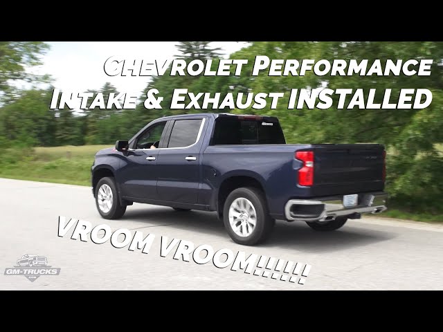

But you want it to sound like this. Then keep watching. So the project ahead of us today is installing the Chevrolet Performance Intake and Exhaust
0:23
We want a little bit more from our truck, a little bit more performance and a little bit more sound
0:29
If you watched our live unboxing, you know we're at the beginning of a major phased upgrade to our 2019 Silver Auto-LTCZ
0:40
With so many performance parts in our garage, we're going to start out with the easiest and most popular
0:46
The Chevrolet performance intake and exhaust. So sit back, relax, get yourself a drink, and watch us install these two performance parts

performance, intake, and exhaust. Turns out the pair was really easy to install. We really
18:26
appreciated that the fit and finish look exactly like stock and everything just went together
18:32
We did unfortunately have to take a trip to our dealer shortly after installing the intake
18:37
because a check engine light came on. Now we knew we needed to reflash our computer in the truck
18:42
because the software update comes with the intake, but we thought we could just get around to it
18:48
Our mistake. The check engine light came on, but after a quick trip to the dealer, a free trip to the dealer, our Silverado is running better than ever
18:57
The exhaust is only mildly louder than stock, and our neighbors don't hate us. It's pretty easy to live with on a daily basis, but if Chevrolet Performance made an even louder option, just even a little bit louder, I don't think we'd complain a bit
19:09
Overall, these two products, the Chevrolet Performance intake and exhaust, have made our Silverado exponentially more fun to drive
