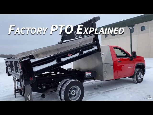

For this case right here, we're in stationary mode. So you would set the park brake
2:19
This button right here is actually the power takeoff switch. You can see it's the four wheels, and you're actually diverting power out on the side
2:26
So we'd engage that. You can hear it kick on. You can also see there's a light on the dash that shows the power takeoff
2:34
In this condition right here, so right now we're sending power through the power takeoff
2:38
through the hydraulic pump that we've assembled onto the vehicle. And from right there, it's sending hydraulic fluid back to the dump bed
2:46
From there, we easily operate lifting the bed up and down. It's a bit weird to get some picture from outside, but we easily run the bed up and down

So with a dump bed, you might be depositing stone or salt or something as you're�
3:54
Right, whatever. It's amazing how many different uses we get with these
3:59
In this case, stationary, you're going to drop your backup, drop whatever you have, set the bed back down
4:05
and then either you shut off the PTO to drive away, or actually if you hit the brake, it will also kick off the PTO
4:10
So you can hit the brake, go to drive, and drive off if you dump the load. Okay
