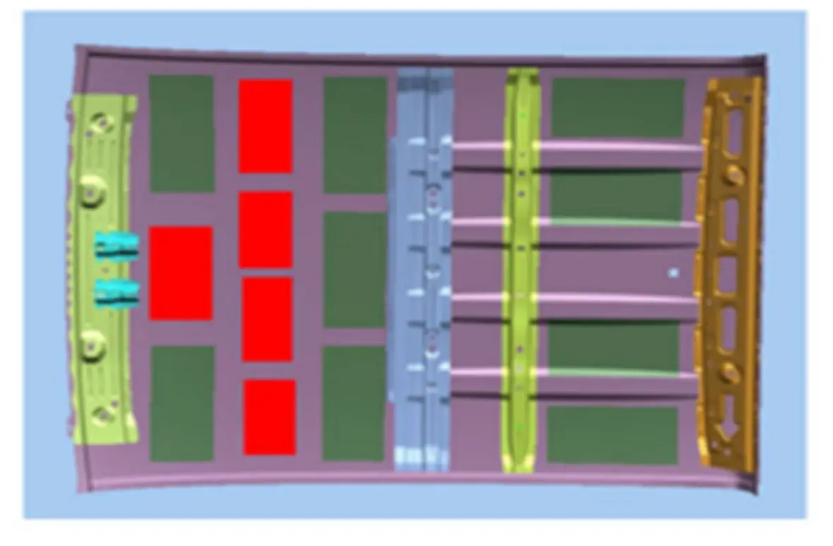

1. Drop the headliner, but do not fully remove from the vehicle.
2. Once the headliner is dropped (but not removed) apply the 5 stiffening panels to the
underside of the roof panel in the RED locations in the illustration above.
3. Once the panels are installed, reinstall the headliner.
4. Verify the condition is corrected.
