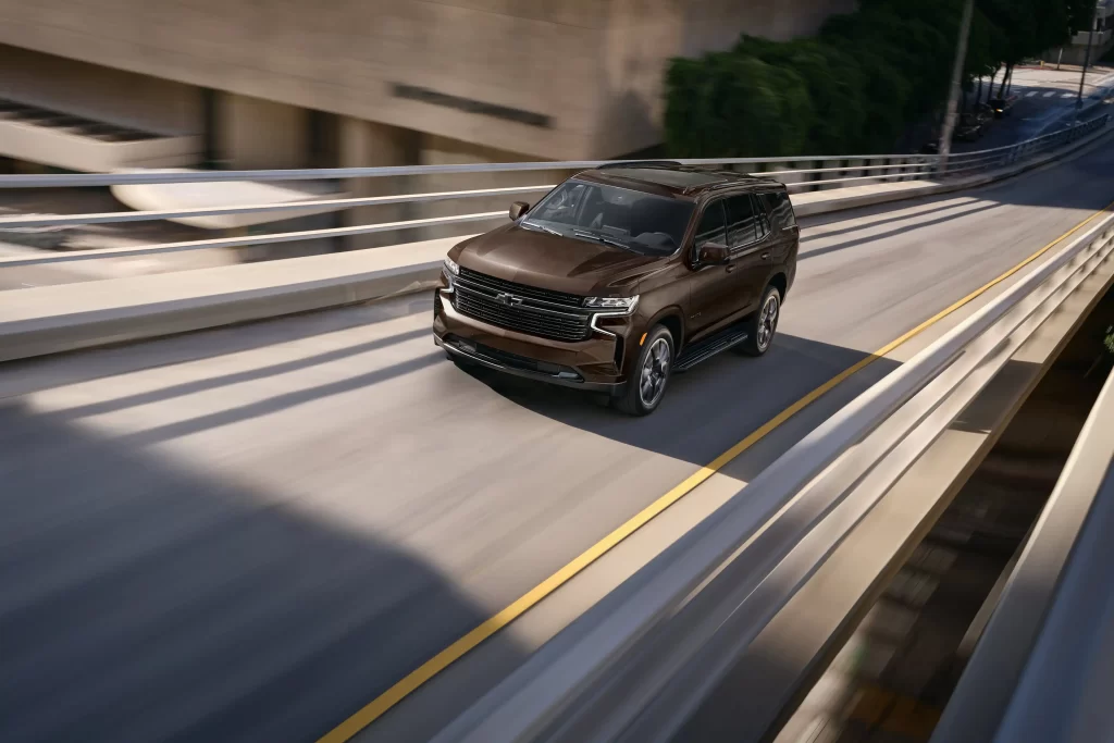

Chevrolet Tahoe on a highway
Some Chevrolet Tahoe owners may find that their vehicles will not start because of a low voltage or dead battery.

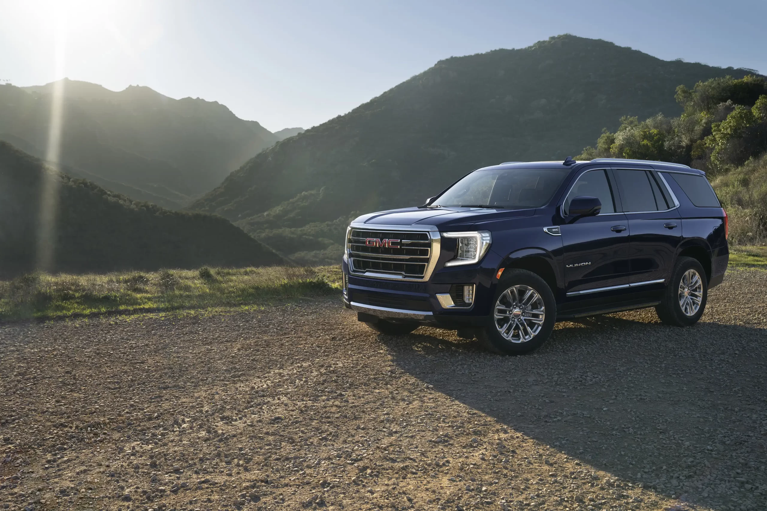

GMC Yukon on a dirt road
Some GMC Yukon owners may have their liftgate randomly open on its own
