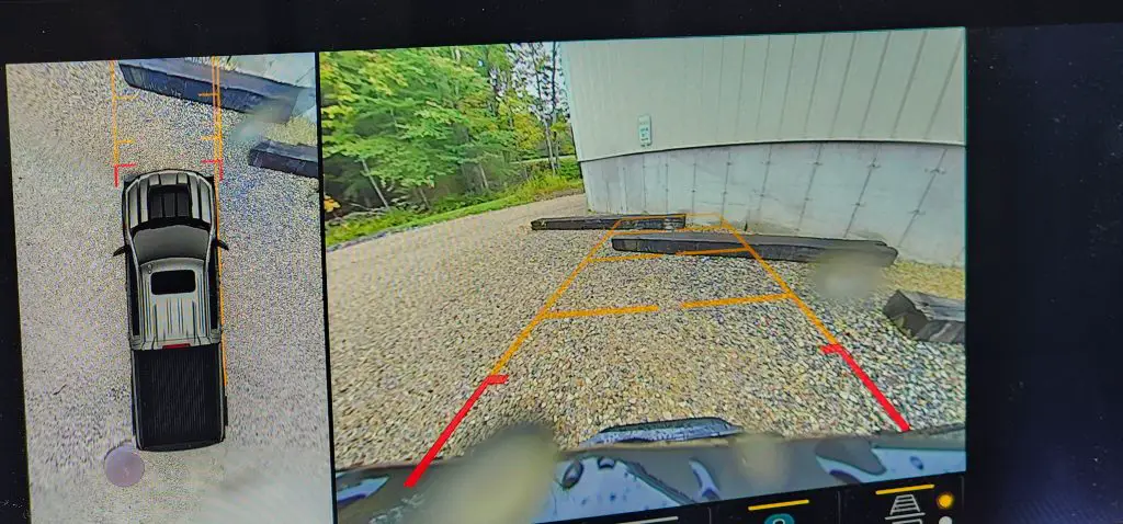

GM’s Surround View camera system is a fantastic piece of technology. It helps you park, tow, and navigate tight spaces in your big truck. The system works by using four cameras: one positioned in the front, one in the rear, and one under each rearview mirror. We use our 2022 Silverado ZR2 camera system every single day.

But as it turns out, some 2022 and 2023 Silverado and Sierra equipped with the system may have a little bit of a dribble problem. According to GM-Techlink, some owners may notice the front camera washer leaking washer fluid from time to time. The front camera uses a washer fluid nozzle to keep it clean during day-to-day use. When a specific part fails, the nozzle may drip washer fluid, obstructing your view in certain situations.
