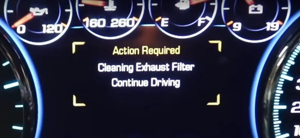

Error Messages You May Encounter
- “CLEAN EXHAUST FILTER SEE OWNERS MANUAL NOW”
- “CLEANING EXHAUST FILTER KEEP DRIVING UNTIL MESSAGE IS CLEARED”
- “CLEANING EXHAUST FILTER CONTINUE DRIVING”
- “DIESEL PARTIC FILTER IS FULL CONTINUE DRIVING”
- and may also be throwing error code P2363

If for any reason the diesel particulate filter cannot regenerate itself, one of the above error messages will display in the drivers information center.
What Can I Do If I Have a DPF Regeneration Error?
If your diesel powered GM vehicle trips one of the above errors regarding the DPF system, driving above 30 miles per hour until the error message disappears is the easiest way to fix this issue. Driving above 30 miles per hour will allow the DPF regeneration cycle to occur. The cycle is not complete until the error message goes away.
