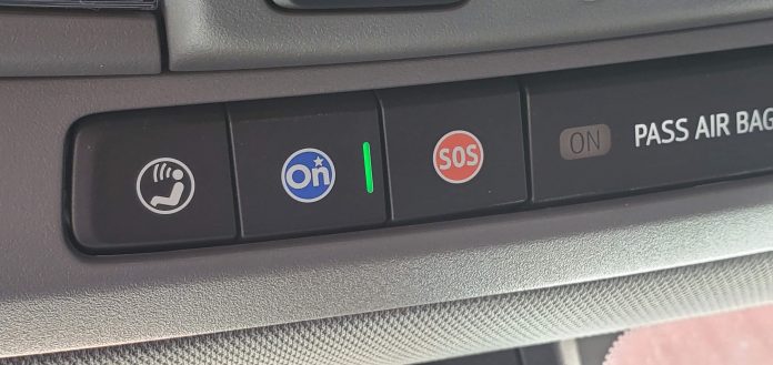

How To Check If The Update Was Applied To Your Vehicle
Unfortunately, this is not easy. Some of the listed vehicles above have a menu inside the radio or infotainment system that lists the software update history. Look for an OnStar Update or Software Update on or about September 10th, 2020.The update version will vary based on year, make, and model.
Our 2019 Silverado’s update screen did not list OnStar Updates or any September 2020 update as of November 3rd, 2020.
What To Do If The Update Failed Or Has Not Yet Been Updated
Try to apply the update again if given the option. If that does not work or the update is listed as “failed” you will need to visit your dealership. If no failed update message is listed it is possible this TSB does not apply to you. If no update is found this may indicate this TSB does not apply to you.
OnStar Modules that have not updated correctly will need to be replaced. Unfortunately, parts for this replacement are not currently available and may take until the Spring 2021 to be in stock.
