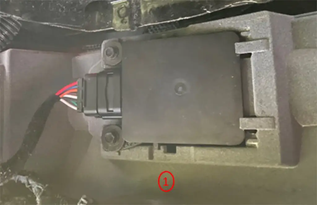

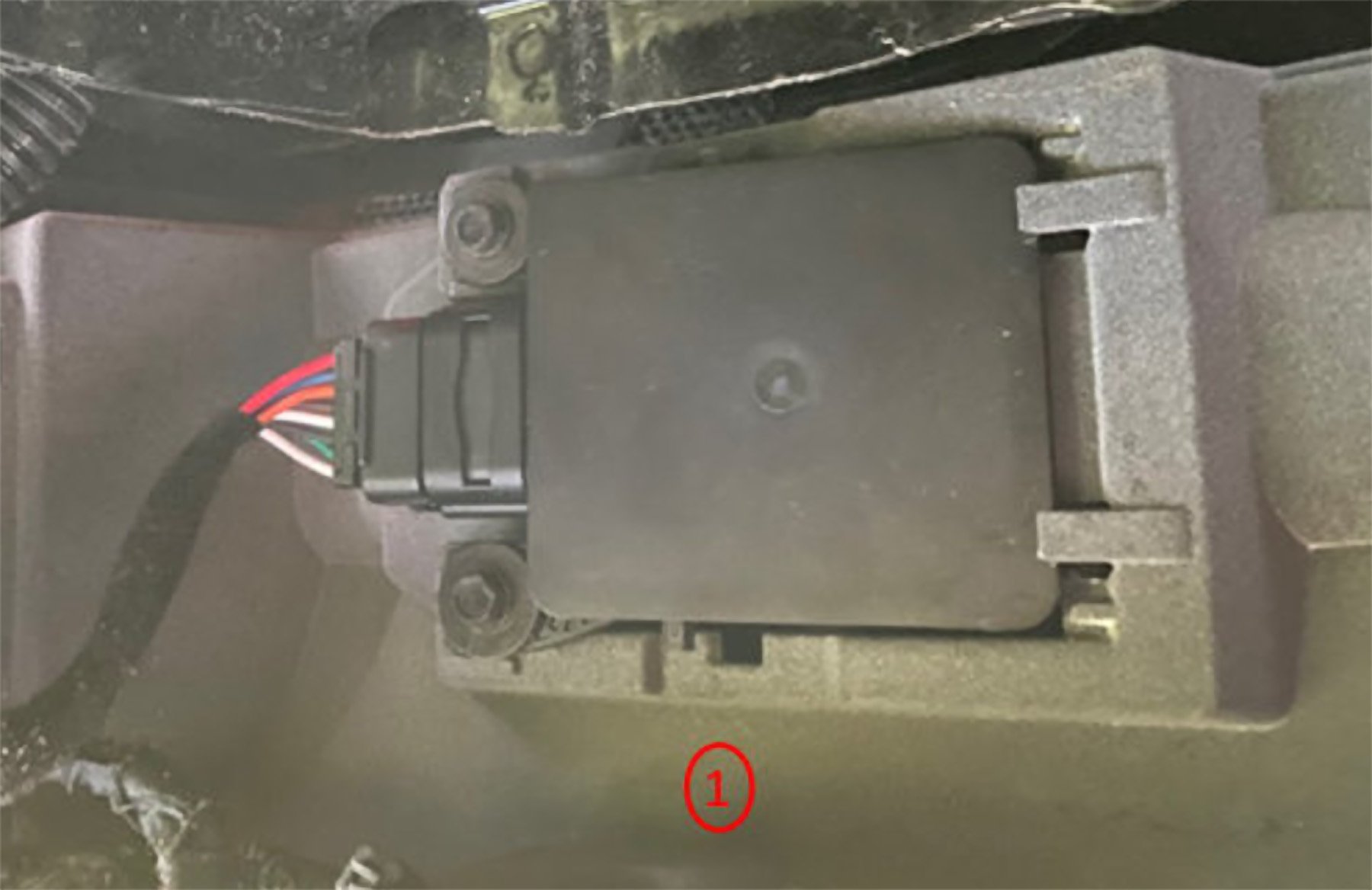

Some of the above vehicles may have an issue with their rear cross-traffic alert and/or blind spot detection system that causes them not to detect every vehicle, not work at all, or to display an error message in the driver’s information display. The system may work sporadically or not at all.
This issue is most common on vehicles that have had bodywork or the rear bumper removed.
Rear Cross Traffic & Blind Spot System Errors – The Fix

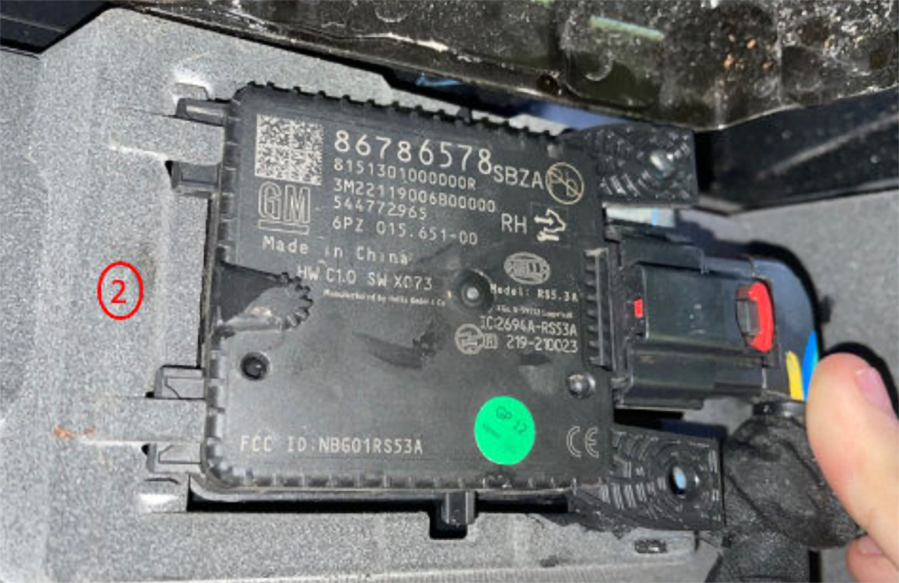

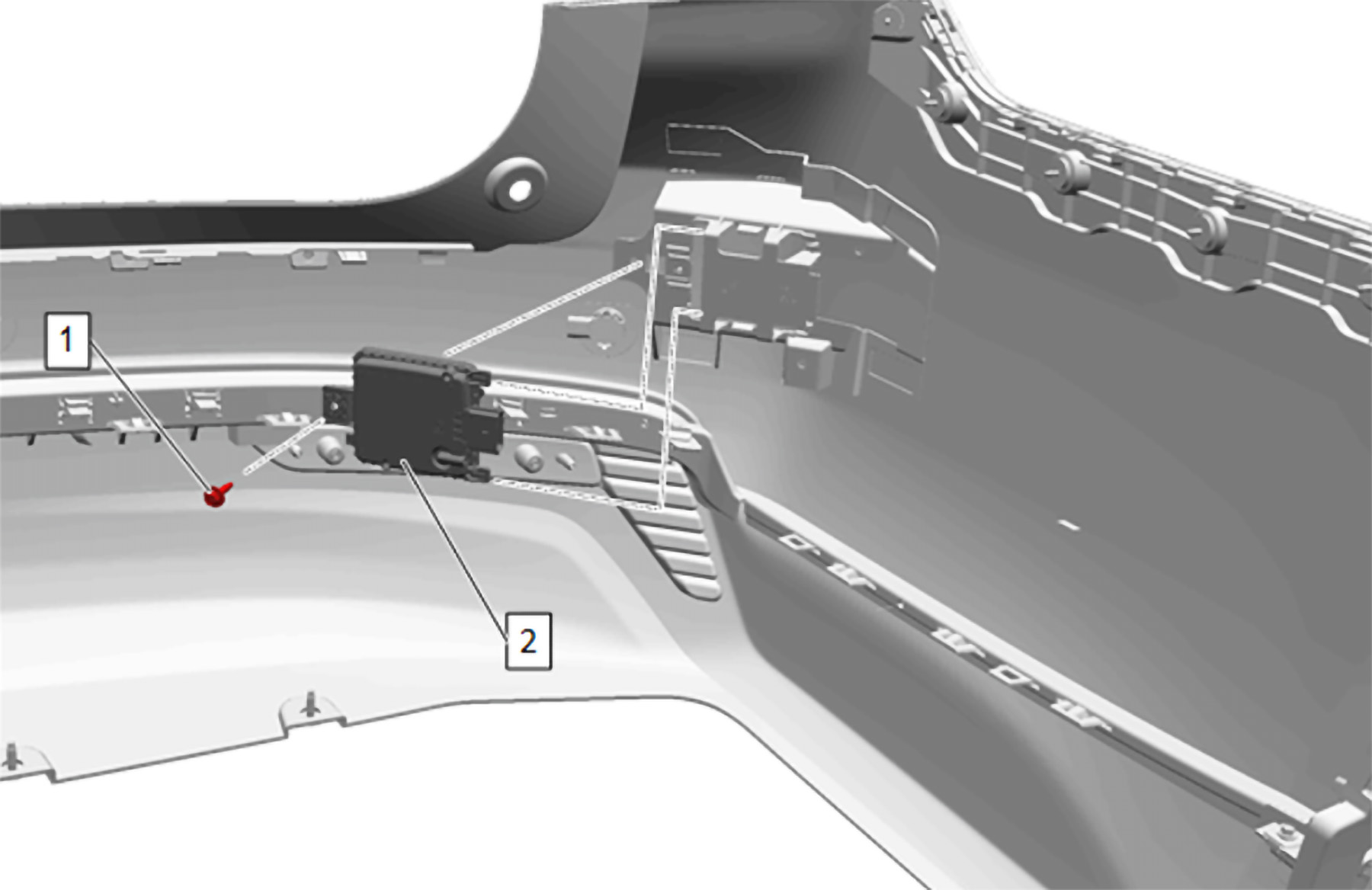

The issue is that one or both of the rear-facing radar modules in the bumper have been installed incorrectly and/or backward. The modules are left/right specific and should be installed with the printed labels facing the front of the vehicle. The side object detection systems can still work with the modules installed incorrectly but will work inconsistently or poorly. This most commonly happens when a rear bumper has been replaced, removed, or damaged.
If you’ve had work completed on your vehicle and this error or problem has begun after the work, consider this a potential fix and ask your technician to refer to #PIT6087 for more details.
