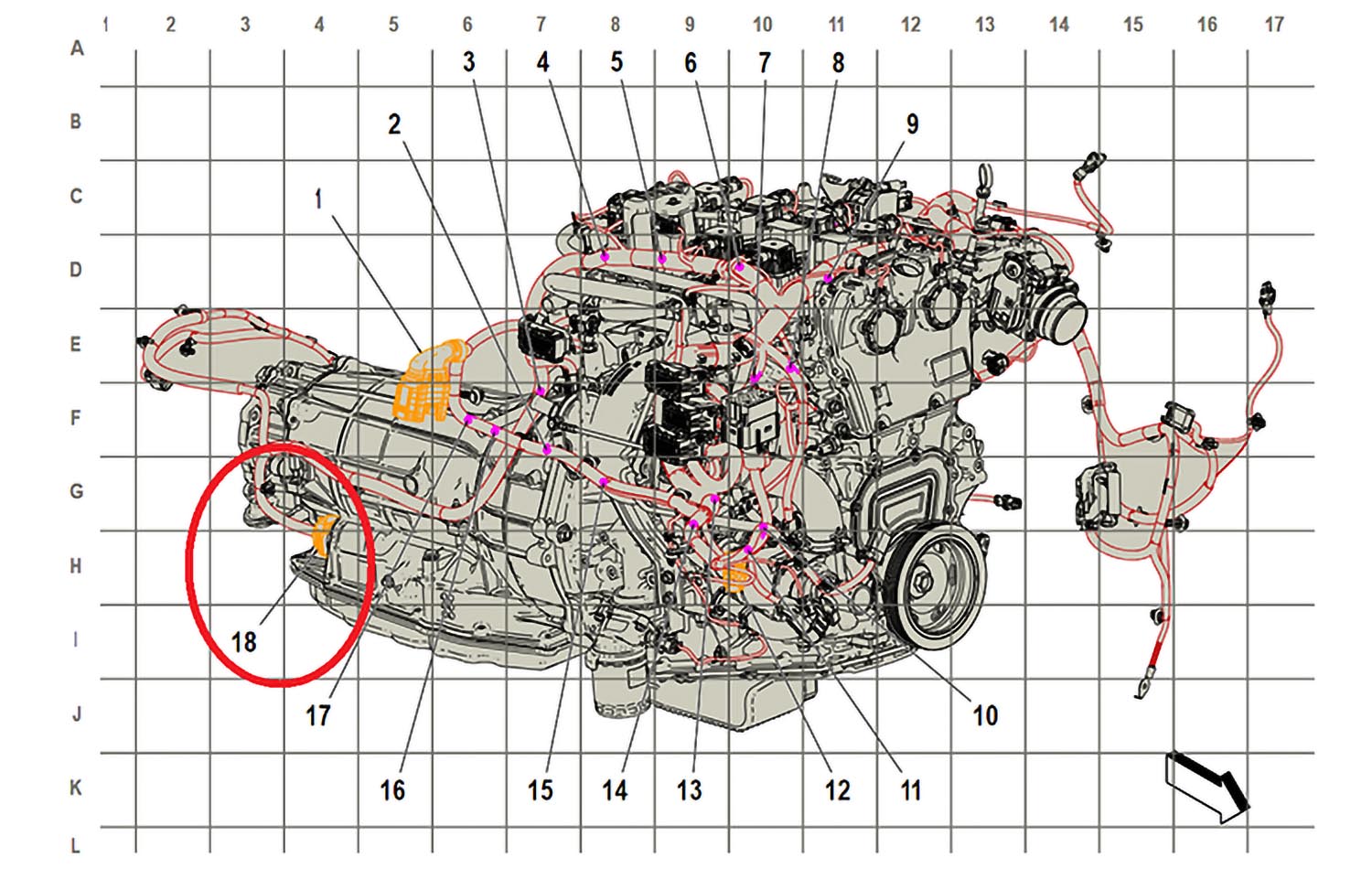

Inspection: Before any engine or transmission repairs, the X175 transmission connector located under the vehicle at the rear of the automatic transmission must be inspected.

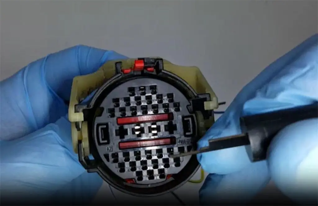

Connector Check: It’s essential to remove the connector and ensure that all terminals are correctly seated.
Terminal Tension Verification: Using the correct terminal tension tool, verify the proper terminal tension as per the Service Information.
Repair or Replacement: If poor terminal tension is identified, repair or replace the terminal as needed and verify the proper operation of the transmission system.
