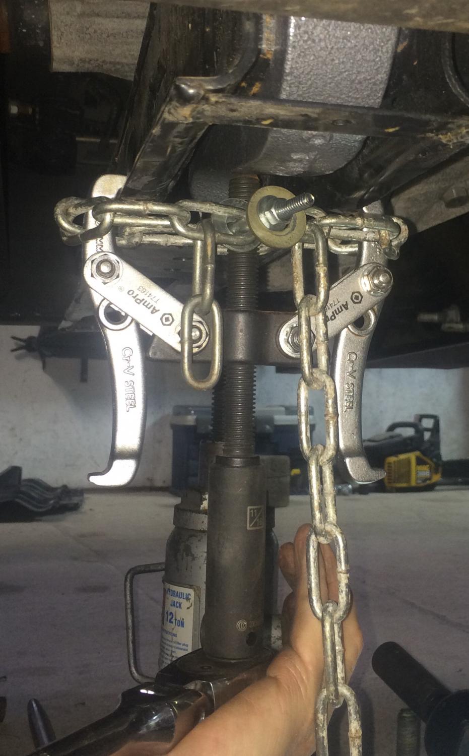

  2. O and I took this pic while I was installing the kit into my truck. Online instructions didn't say anything about a special tool for the keys so I never ordered one,I had to improvise lol. Some of u might get a kick out of it.

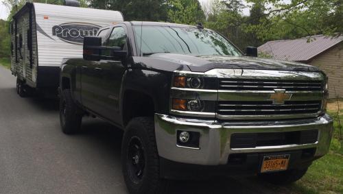

  4. I wish I could afford the duramax, this is the 6.0. As far as tires, I looked for 2 months and I ended up going with toyo at extreams in 285/75/18. They have a pretty aggressive tread but just a bit less then the mt's. Figured they would b perfect for on and off road. I too drive around on the farm abit, just got them on tho and haven't taken them off road yet. It is also an E rated tire and rated for 65,000 miles but we shall c about that.
  5. I had a 2012 dodge 2500 with a 5 inch lift before this truck and ran into that same problem, couldn't buy a 5th wheel bc of the height. you shouldnt have any problem with a 5th wheel on this truck bc it is only one inch in the rear. The tires I went with put it up another 1.25 inch so if you had a little smaller tire you would b fine. I had a 2012 dodge 2500 with a 5 inch lift before this truck and ran into that same problem, couldn't buy a 5th wheel bc of the height. you shouldnt have any problem with a 5th wheel on this truck bc it is only one inch in the rear. The tires I went with put it up another 1.25 inch so if you had a little smaller tire you would b fine.
  6. 3 inch lift in the front and 1 inch in the rear, 18x9 anthem rims and 285/75/18 toyo at extreams! The pic does very little for the truck, i belive this is about the most perfect setup I've done. Love it
