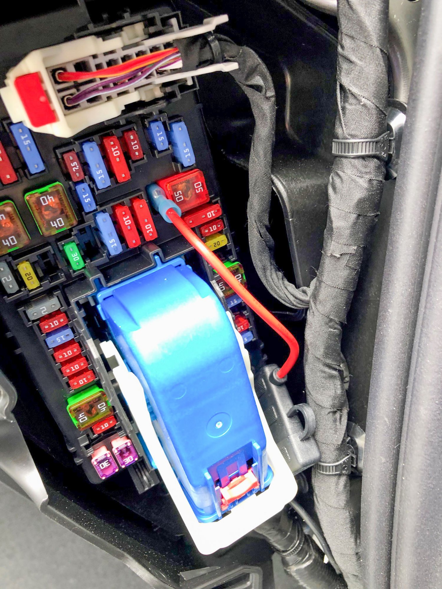

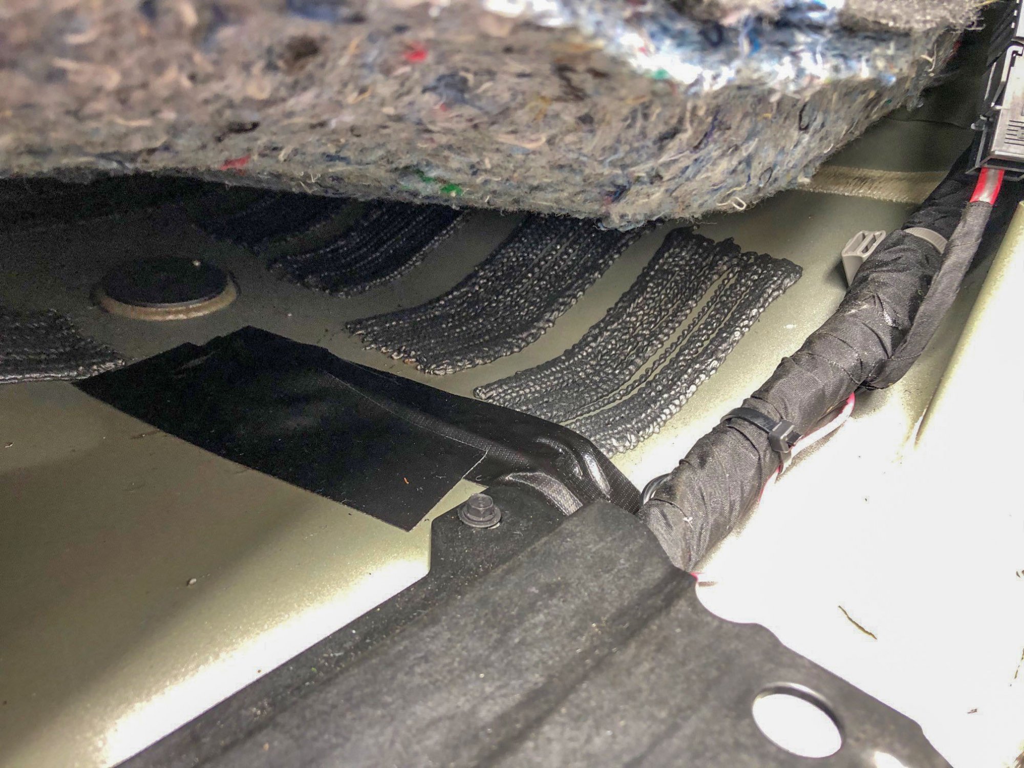

  4. Jeff, Thanks for your photo as it made connecting the pink wire a lot easier to a power source. I had asked Air Lift Tech Support for any information as to what fuse location to use on the 2020 GM 3500HD trucks. The reply was why do you want to use the pink wire and don't even bother. Nice answer.....Not. Why even have the pink wire with it noted in the installation instructions if it's really of no use. I ended up drilling a small hole in one of the plastic plugs in the body under the passenger carpet, placing a rubber grommet in the hole with the wire run through it. I gorilla taped the wire down and zip tied it to a wire bundle. The rest was easy and it works as advertised with a 10amp fuse wired into the circuit. Thanks again for your help.
  5. Are you running the optional pink wire to your passenger side fuse block for power with ignition hot? I have my Wireless One black negative and red positive wired to my battery. Instructions say to connect "pink" wire to a 10amp fuse block that is hot with "key on". Guess I'm just confused as to where the "pink" wire actually plugs into with a fuse tap. Hope that makes sense.
