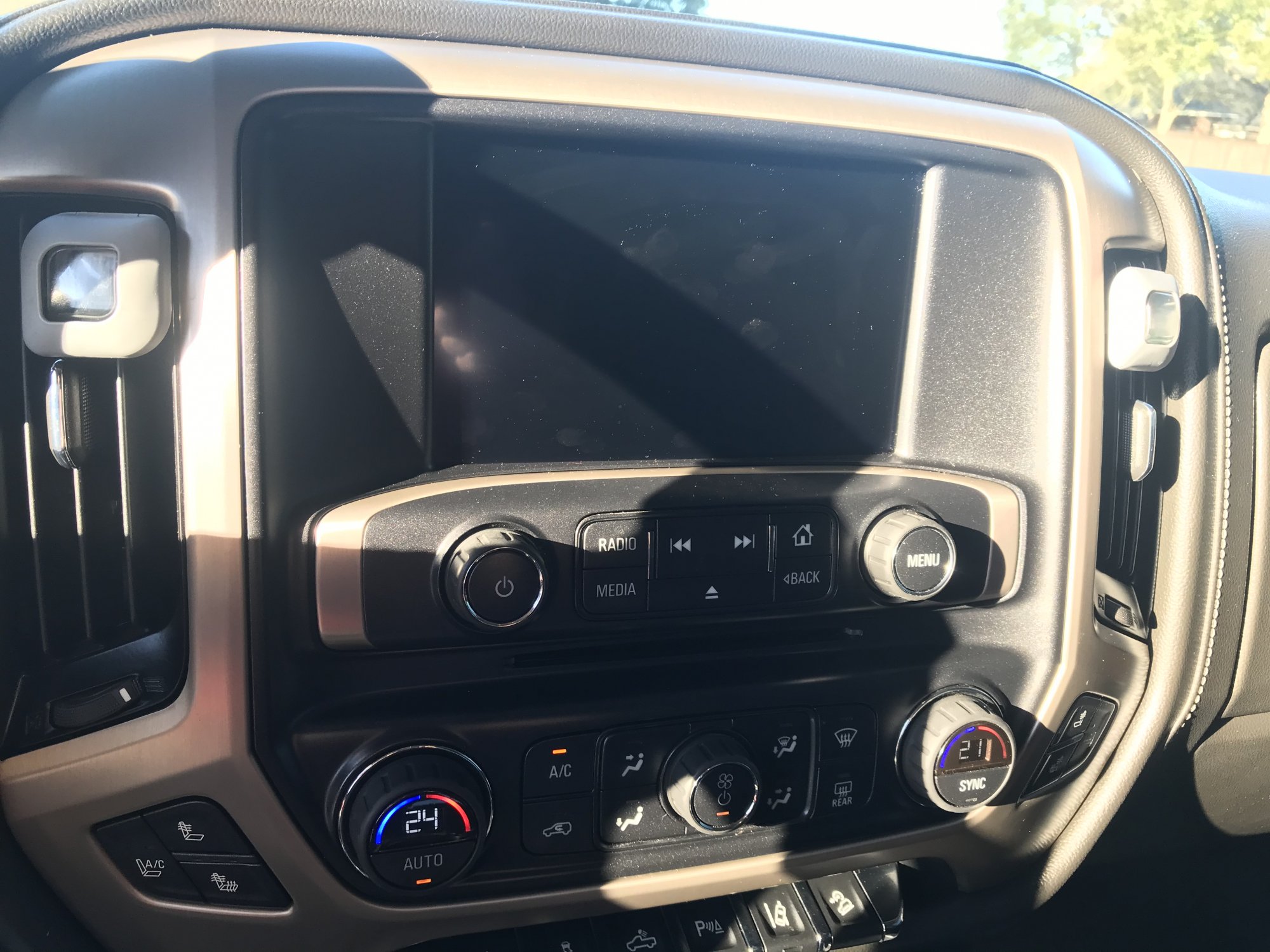

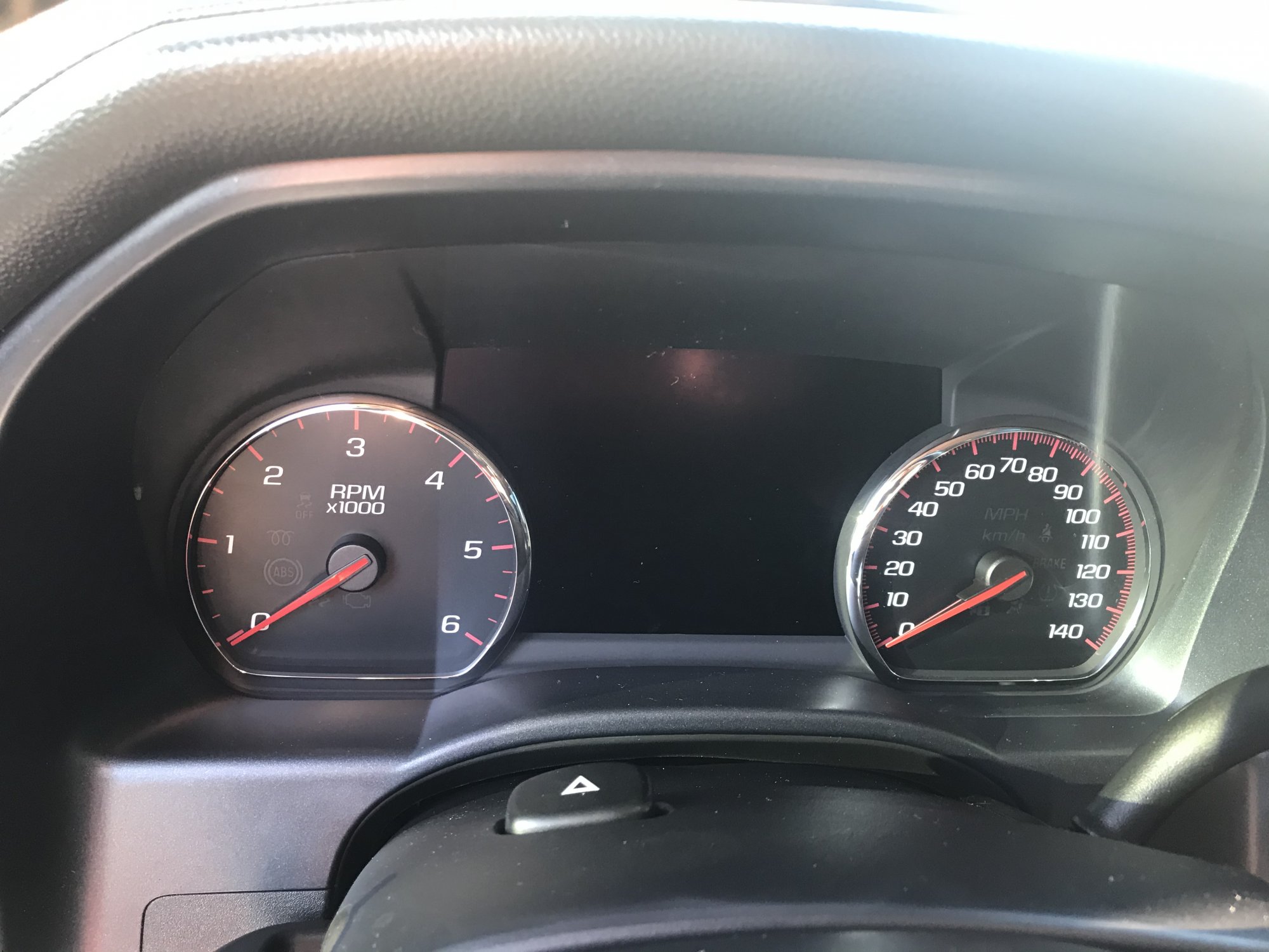

  5. Yes that’s what happens sometimes it freaks out and it’s normal then it does this then it goes off and then goes back to reading temp and such normal.
  6. That’s with the truck running I can see the navigation screen has power but no picture and no thing on the dash at all. Also the other day I started it and the navigation screen icons popped up for a bit but couldn’t press anything . Everything else works fine in the truck .
  7. Works and everything else the only things that don’t as the dash and the navigation screen . And I also can’t hear my turn singles but can see them working on the mirrors

  11. Well I have figured out the issue I’m sure I put in some aftermarket leds headlights bulbs and well I decided to remove them just to see and put the factory yellow bulbs back in and got up this morning and opened the dirt everything is working completely fine . That’s just crazy . So now I have to do some research and get some actual led bulbs that won’t effect that problem from happening again .
