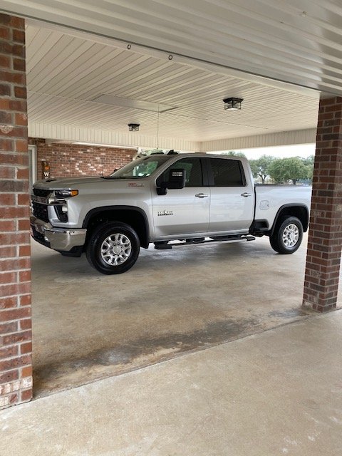

  10. I know when it was factory he was getting about 14-15 avg, I believe he’s getting around 13-14 now. here is a little different angle, at the front fenders I am 4” taller than stock (stock with 20s are 1/2” higher than with 18s because of the tire size)

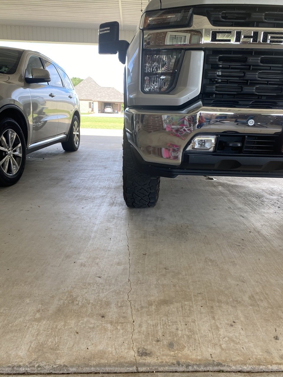

  12. Was finally able to crank my torsion bars and get the 37x11.50s put on today, love the look, they do not rub on the fenders but do rub the frame at full lock, I’m not sure if a 1/2” spacer would help or not
