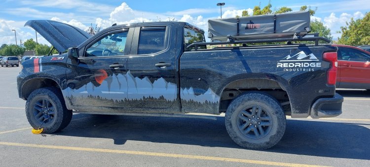

  2. Went to Colorado a couple weeks ago and made some big upgrades before leaving. I needed to get my tent up higher so I could close my tonneau cover. I used 1.5x.120" DOM tubing for the new bed rails. They are mounted to the stake pockets, not the bed side so they can be removed with 4 bolts. After a lot of arguing with myself I used the stock running board brackets and 1.75x.120" DOM for a set of rock sliders. This is not a rock crawler but I did bang them on Black Bear Pass and they survived with no body damage.

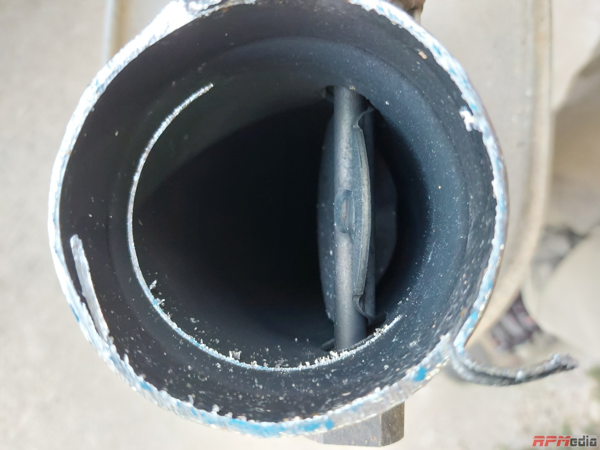

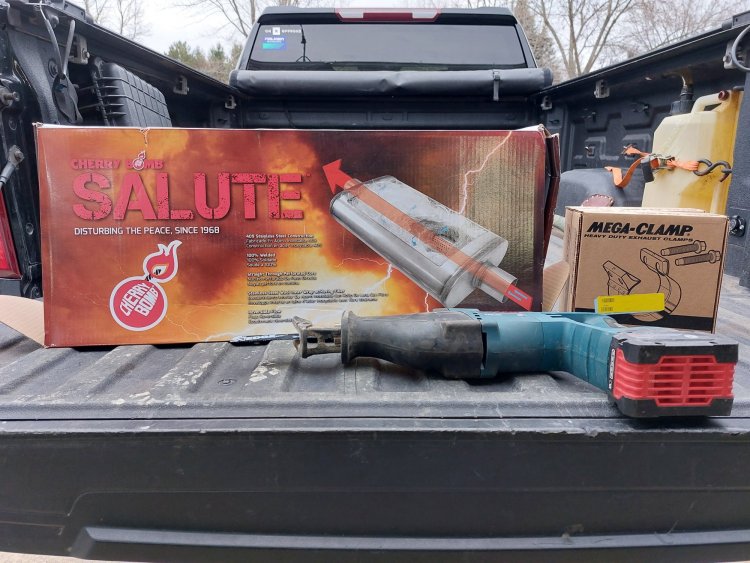

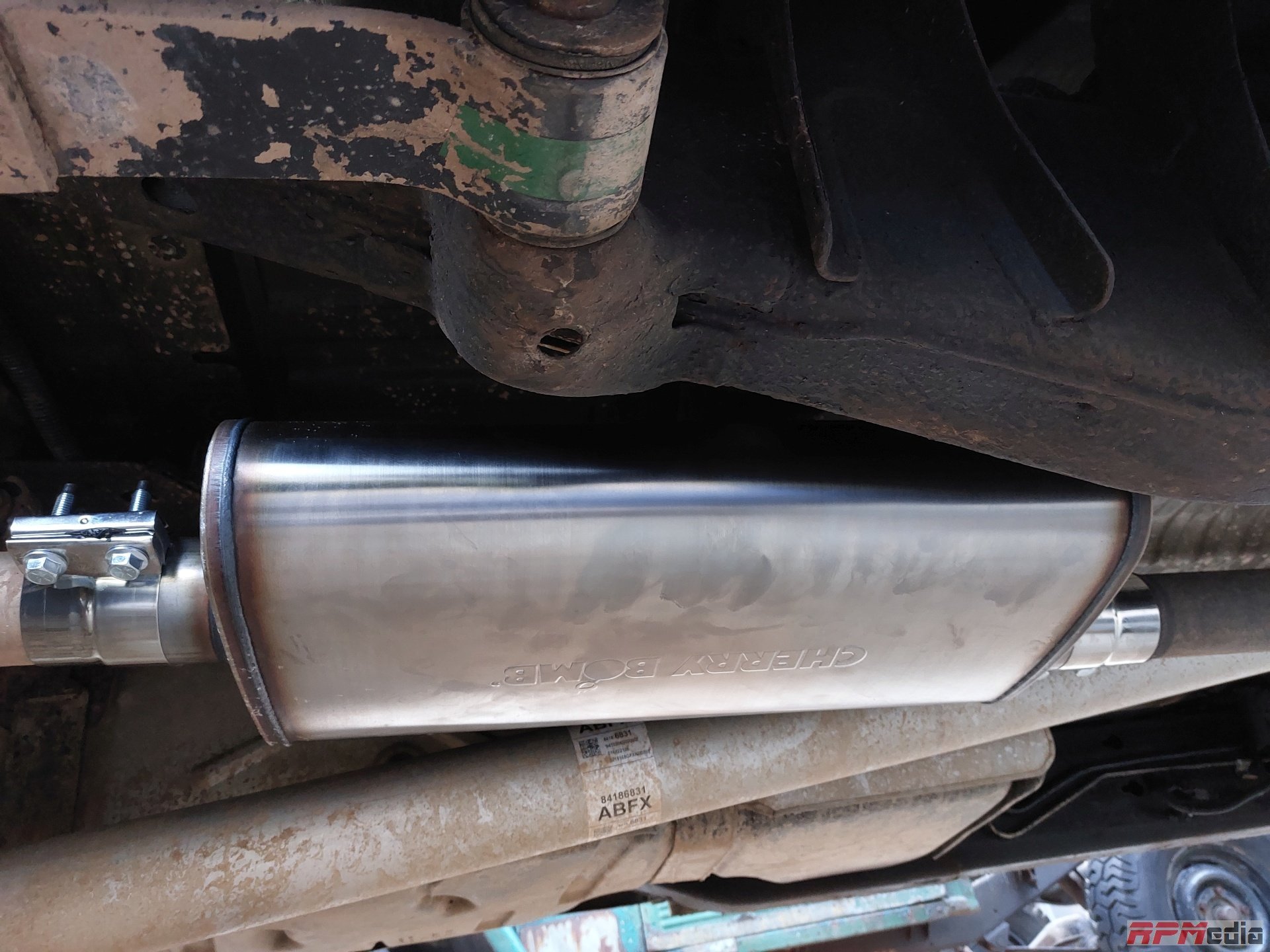

  3. When I went looking for exhaust options for my 2019 Silverado Custom Trail Boss I found plenty of catback exhaust options available, ranging from around $600 to well over $1200, and of course the straight pipe option for around $110. I didn't want a loud exhaust, just something to make it sound better and get rid of the flapper that was killing power. After some searching and some dyno feedback from Engine Masters I ended up purchasing a 3" offset stainless Cherry Bomb Salute Muffler and 2 stainless clamps for a total of $80 from Summit Racing. The removal was straight forward, cut the existing muffler out while leaving as much of the factory pipe as possible. The downfall of the stock exhaust is the 2.75" diameter pipe that needs to be stretched to 3" to slip fit the muffler. I bought the Astro Tools pipe stretcher to stretch the pipes and it worked flawlessly, another tool I should have bought years ago. You could take it to a muffler shop to have them do the same thing if you didn't want to buy the tool. Install is simple, slide the clamps on loose, fit the muffler to the factory pipes, and tighten the clamps. You can save yourself a little money by welding the muffler if you have the capability to weld stainless, again a muffler shop can do this for you. Overall, sounds near stock at idle and moderate throttle application. At WOT it is noticeable but not wake the neighbors loud. There is no drone but it did increase the cabin noise at highway speeds. The best part is I noticed a huge improvement in throttle response, especially in city driving, and my fuel mileage increased by a solid 1-2mpg. My only regret is not doing this when I bought the truck.

  8. Using your truck for Overlanding/Camping/Light Offroad duty? Post your mods and details of products here. Truck: 2019 Trail Boss Custom with 5.3 and 6L80 Rear Rack: I cut up a 2000 Suburban factory roof rack and placed it on custom stake pocket mounts. I then used the widest Thule Probar and matching feet to mount to the factory roof rack now serving as bed rails. Tepui Kukenam 3, Smittybilt 6.5' Awning, X-Bull Hi Lift mounts Bumpers: I have a GoRhino BR5.5 Winch bumper fitted with a Smittybilt X2O 12k winch. I added the light bar mount recently(no pic). Suspension: Rough Country leveling kit, AirLift airbags in the back. Currently planning to add the Daystar airbag cradles after a little mount modification to make them fit. Tires: Cooper Discoverer AT3 XLT in 295/70R18 Lights: Sealight LED's in headlights, LED's in reverse lights, Nilight Flushmount LED's in fog light pockets, Hella 500FF's, Auxbeam Amber LED Driving lights Electrical: Auxbeam 8 gang switch, Rear 12v outlet in bed Other Accessories: Risk Racing 3.5 gallon fuel can, Apache weatherproof case for tools, Remington Weathertight tote for tools and offroad equipment.
