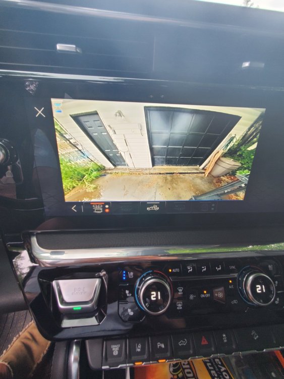

  6. Thanks. The turn signal view works without the red carpet, it says drive to calibrate. None of the trailering featurs work. I have even deleted the trailer checked measurements and set up again. You tried to help me with the camera install in another post. Emailed GM and It is going into the dealer at end of the month. From other groups apparently the blue hourglass in top left in the below picture is a problem.

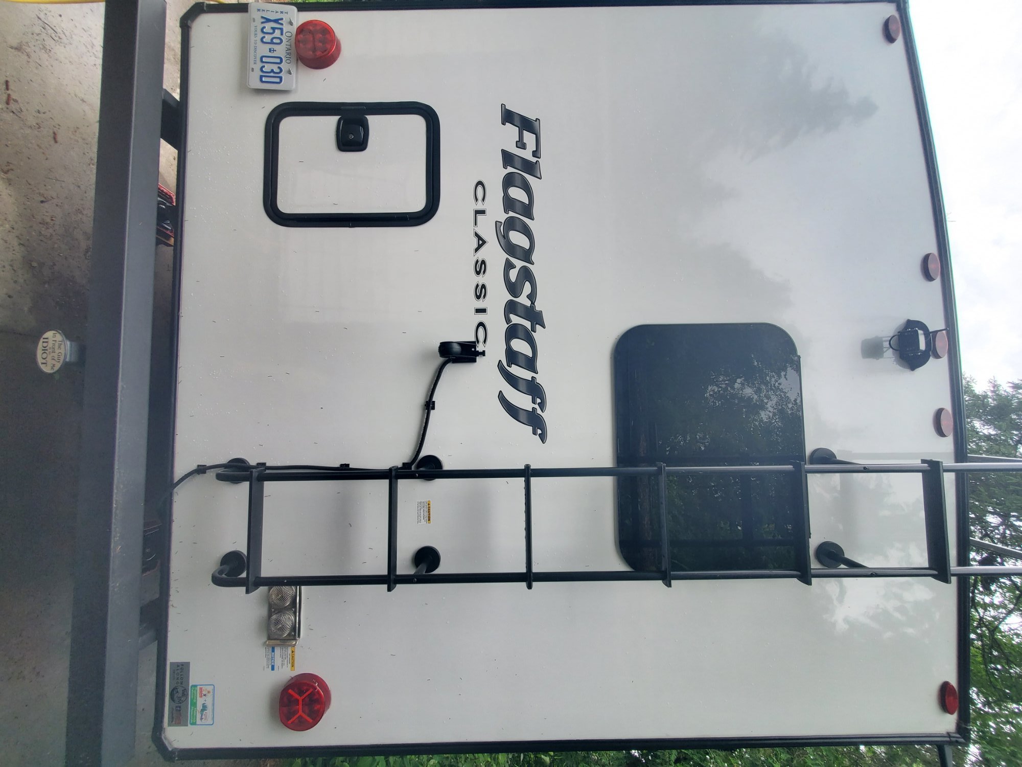

  8. Thanks, It was set up a conventional hitch, and for type it was set as travel. Picture with measurements, sorry I don't know why the picture uploads upside down

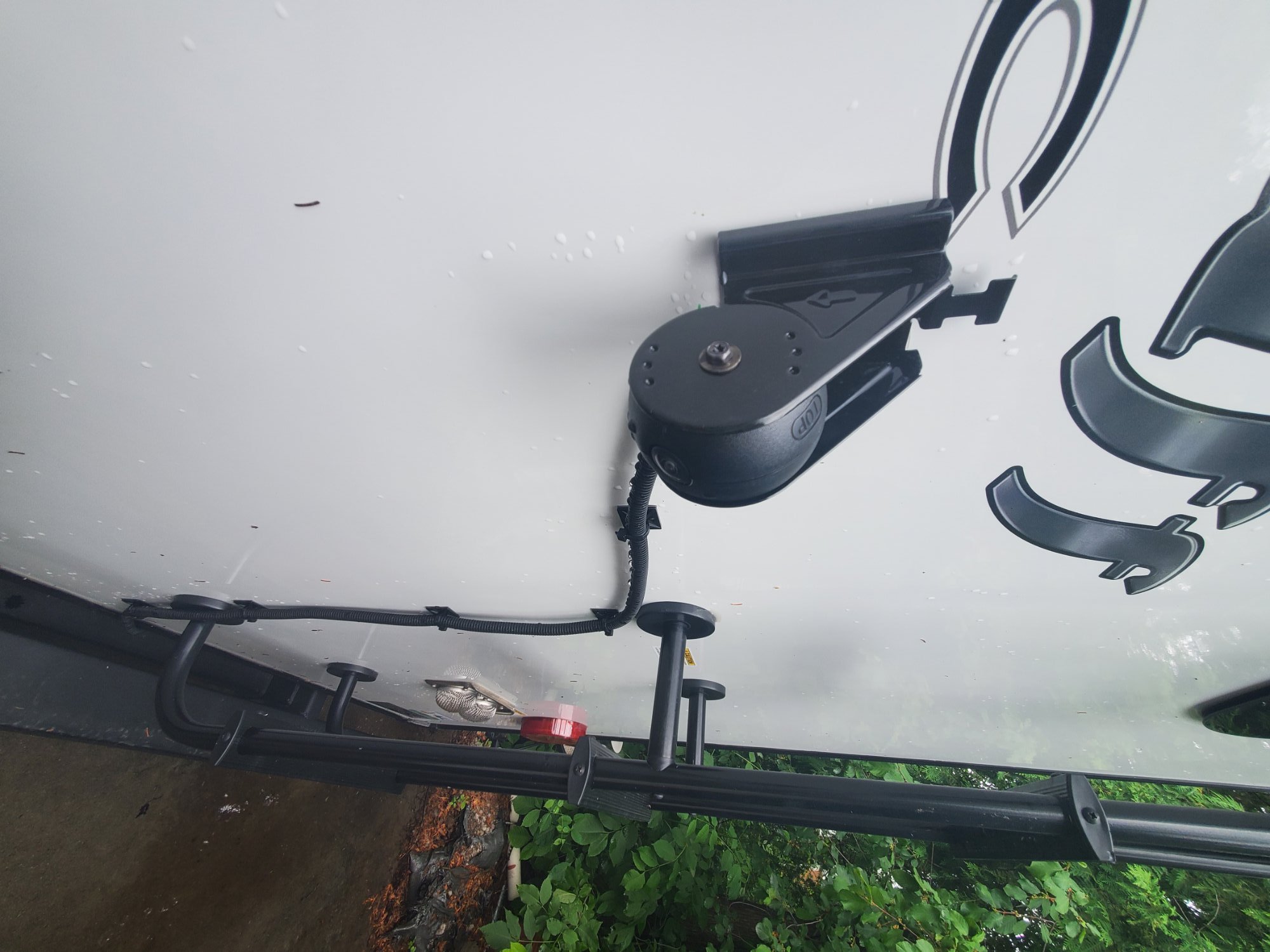

  9. Hello Installed the camera on my travel trailer and can not get the camera to calibrate. The transparent trailer icon is grayed out, the camera is working in the other view. Truck is 2024 GMC Sierra 2500, yes I drove slow and straight, no progress bar anywhere. Thank you for any help
