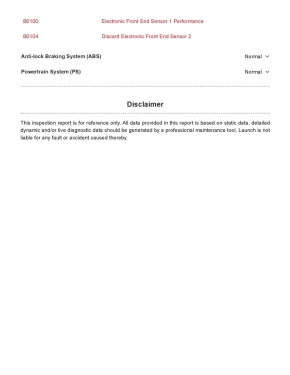

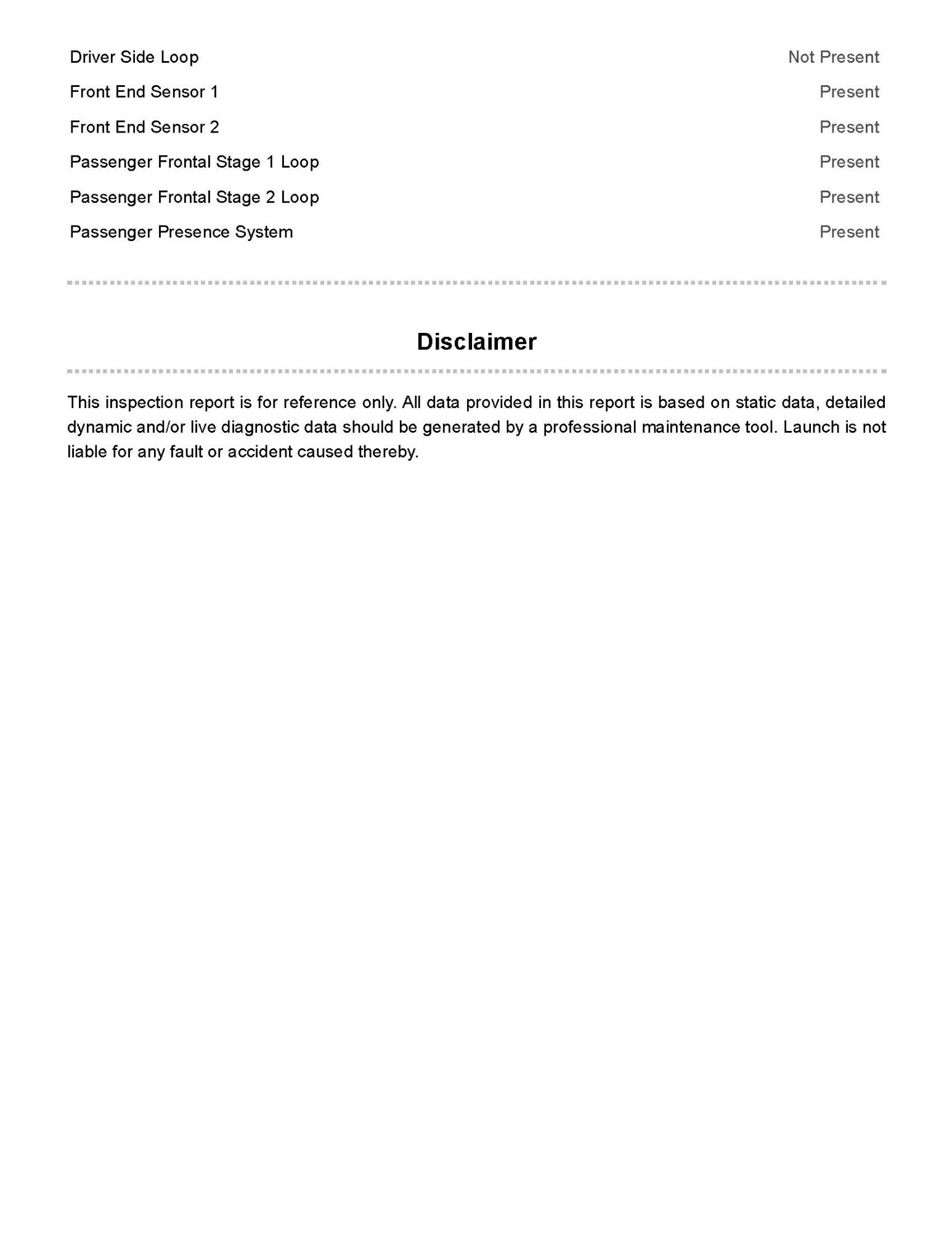

  3. Have a B0100 and B0104 code. I removed both impact sensors and checked them for resistance and they were both around 12 ohms. I ordered some used replacements off of Ebay that came in around 13 ohms. Neither worked. I checked all wiring underneath the seats and checked all connections of plugs to make sure they were snug. I ran a diagnostic tool on the SIR and it came back Active Switch not present and Driver Side Impact Sensor not present and Driver Side Loop not present. I included the PDF's of the Scan along with JPEG images of them. I am at a loss on this one. There is a switch part number 15115221 underneath the passenger seat. Any help would be greatly appreciated. Josh Silverado1.pdf Silverado2.pdf
