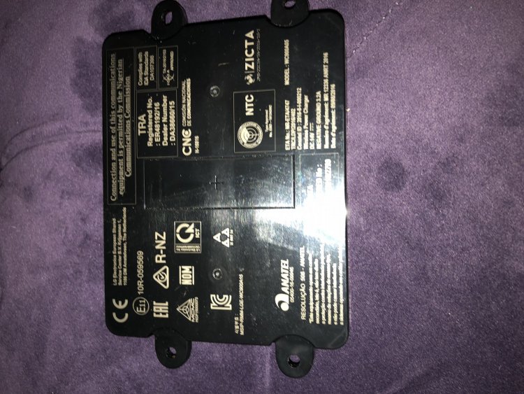

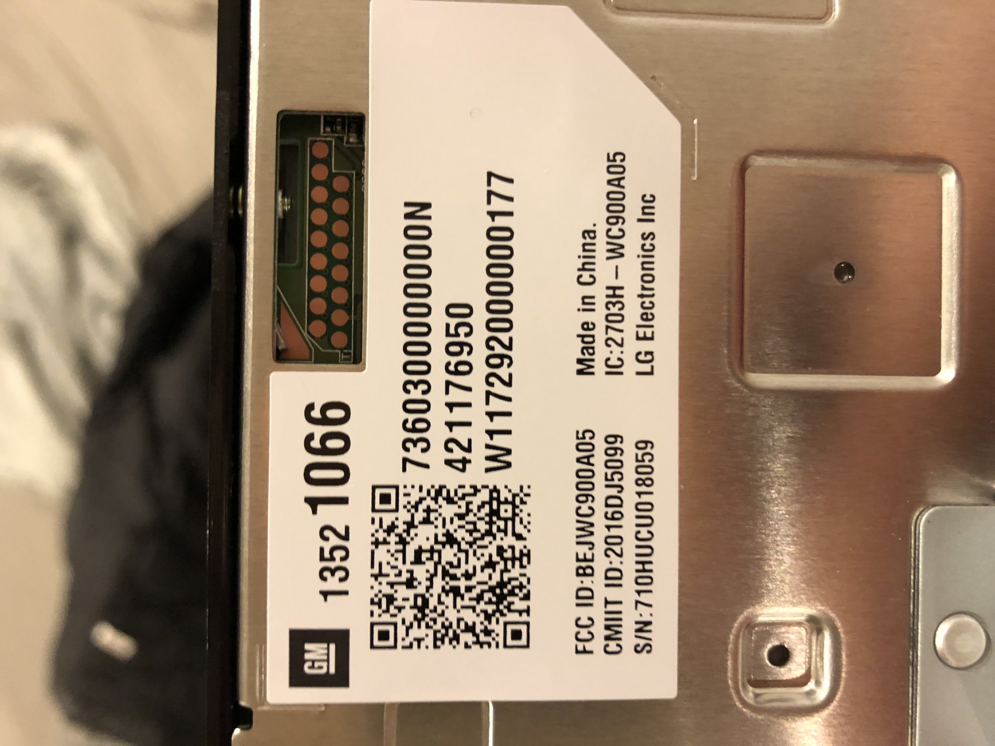

  9. So after messing around with this forever, I think I finally have it working. I have a 2017 Denali HD that came with the wireless charger that wouldn't work with my iPhone 8. I ordered the wireless charger module for a 2018 Denali HD part number 13521066 from needgmparts.com. (On edit: I had to email the company as the part number was not listed or found in a search). It was 97.65 plus shipping. The new charger module has a different plug but uses the same 3 wires. I ordered the new plug from Mouser electronics part number 571-2035363-4 . It cost 71 cents. I easily unpinned the old connector. When installing the new connector, the pins on the wires had a little "nub" sticking out on one side that wouldn't allow me to slide it into the new connector. I took a small pliers and just squeezed these "nubs" down so they were flush. The pins then slid in easily and clicked in place securely. Plugged the new wireless module in and put the lid for the center console back together and it seems to be working the way it should now. Little green lightning bolt shows up on the screen when phone is on the charge pad. I can pick the phone up, set it back down and it starts charging again immediately. Thanks to all the users on here for the information they provided regarding the parts, connectors, correct part numbers, etc. new module below
