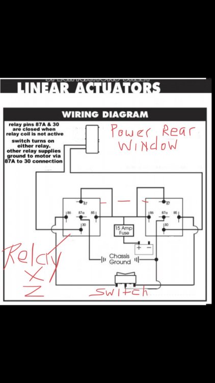

  1. If you are interested in installing a power sliding rear window in your truck here is the schematic so it will work with no programming whatsoever. You will need: power rear window and regulator (regulator may need mounting brackets fabbed if your truck doesn’t have them) SPDT (single pole, double throw) momentary rocker switch with 3 terminals (2) 5 terminal relays in-line fuse holder and course some wire, terminal ends, heat shrink, solder Connect the relays together with switch first. You can test this before completing the entire install. After you complete the relay wiring, you will need to locate the two power window motor wires. They will plug into the last two terminals on the relays. Of course, all of this will mount at your desired location. Connect the ground wire and 12v positive wire and this will work just like factory without having to program anything. If you have questions you may email me at: [email protected] Robert Merrill
