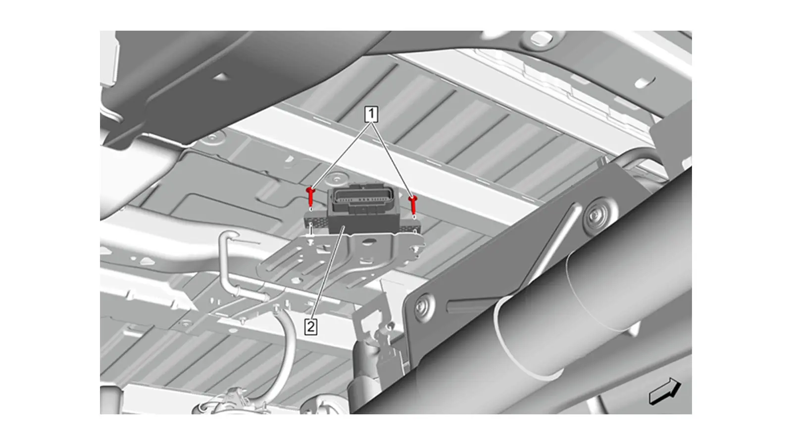

The module in question is the K111 Fuel Pump Driver Control Module (FPDCM), which GM also calls the Fuel Pump Power Control Module. It typically lives on the frame, and on trucks it is mounted under the bed area (GM’s own service illustration shows a Silverado 1500).

GM’s guidance to technicians is refreshingly direct. If the symptoms are verified, DTCs P129F and/or P023F are set, and diagnostics do not point to another cause, replace the K111 FPDCM. After replacement, the new module must be configured with the proper software setup, so this is not a driveway parts-swap situation.
