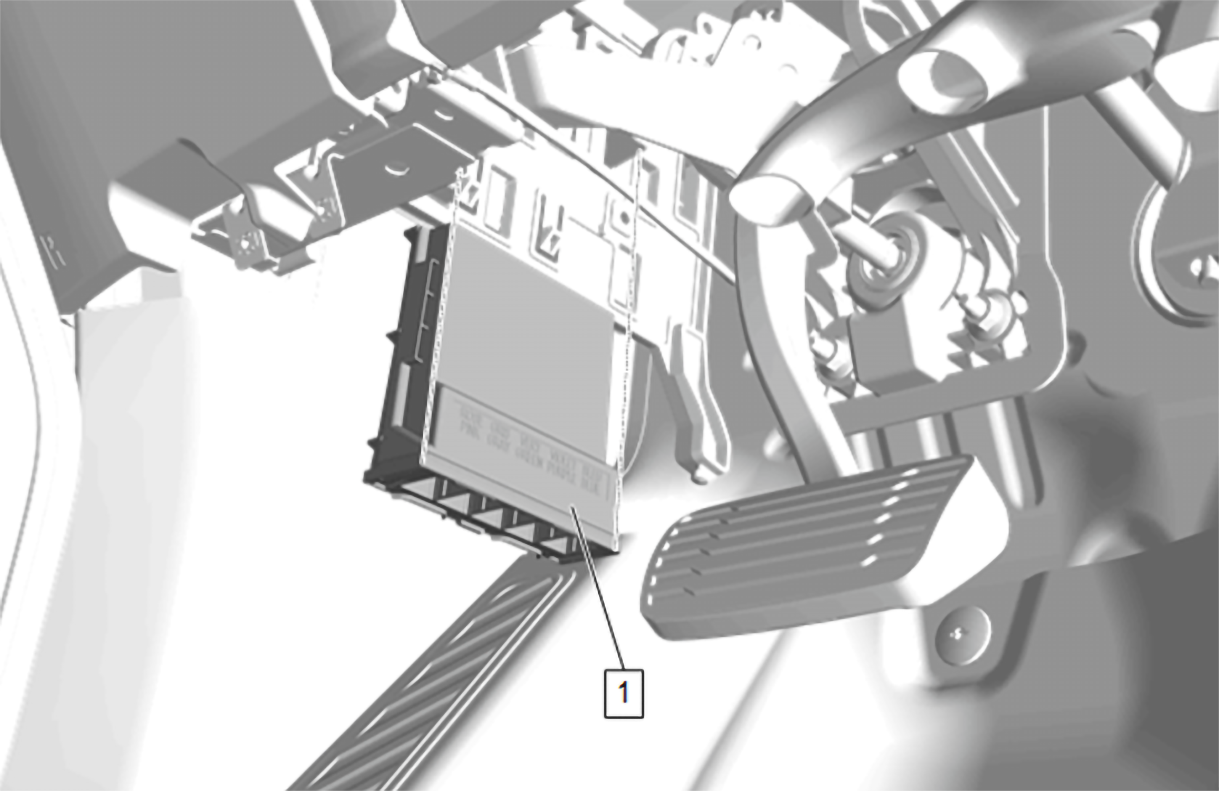

The Body Control Module (BCM) communicates with the Lighting Control Module over CAN to request headlamp illumination and wiper operation.
If the vehicle’s battery goes below the threshold in the Lighting Control Module during a cranking event or the battery is discharged and needs a jump start, the Lighting Control Module may go into a reset every 8-10 seconds, causing the headlamps to flash.
If the headlamps are flashing, do not replace the Lighting Control Module. (Fig. 4) Test the battery following the recommended testing procedures in the appropriate Service Information and replace the battery if necessary.
To correct the flashing headlamps and clear DTC P0606, disconnect the battery, which will reset the Lighting Control Module.
