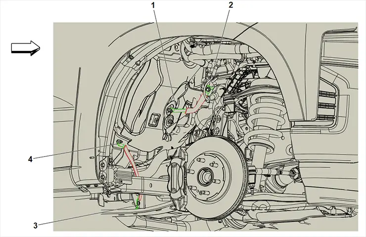

GM Engineering has determined that in some pickups, there may be a high resistance on the “G132″ and/or ” G133″ grounding straps located behind the front wheel liners on the passenger side of the vehicle.
According to GM-Techlink, along with reduced or lost Power Steering Assist and/or Power Braking Assist, “DTCs B127B (Rearview Camera Input Signal Circuit), B1325 (Control Module Power Circuit), B3205 (Driver Window Motor), C116C (Front Brake Pad Wear Signal Circuit), C1595 (Trailer Brake Signal to Trailer Brake Power Control Module Circuit), P25A2 (Brake System Control Module 1 Requested MIL Illumination), U0420 (Invalid Data Received from Power Steering Control Module) and/or U0422 (Invalid Data Received from Body Control Module) may be set.”
Grounding Strap Fix
If the grounding straps are loose, corroded, or stripped, or high resistance is found, repair or replace the grounding straps.
Owners who suspect they are experiencing this issue on their truck can ask their dealership to reference Technical Service Bulletin #23-NA-201.
