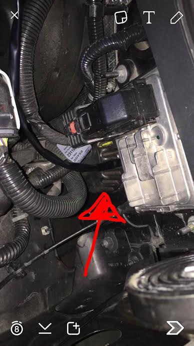

This is the nipple where i ran the wiring harness through the fire wall into the cab. It is on the driver side. I pulled it down with a flat head, and then threaded the wiring harness through with a wire hanger.
