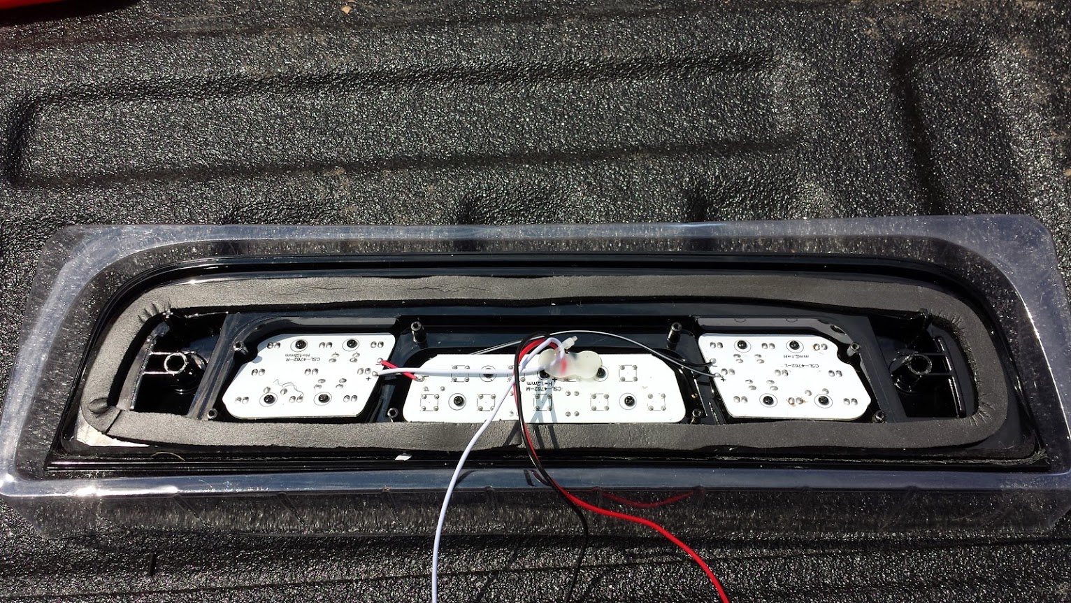

Gasket Installed - Rear Plate Removed
I cut down some wider gasket material I had to make the light waterproof. The rear plate on the light also needs removed to make it fit tighter.
