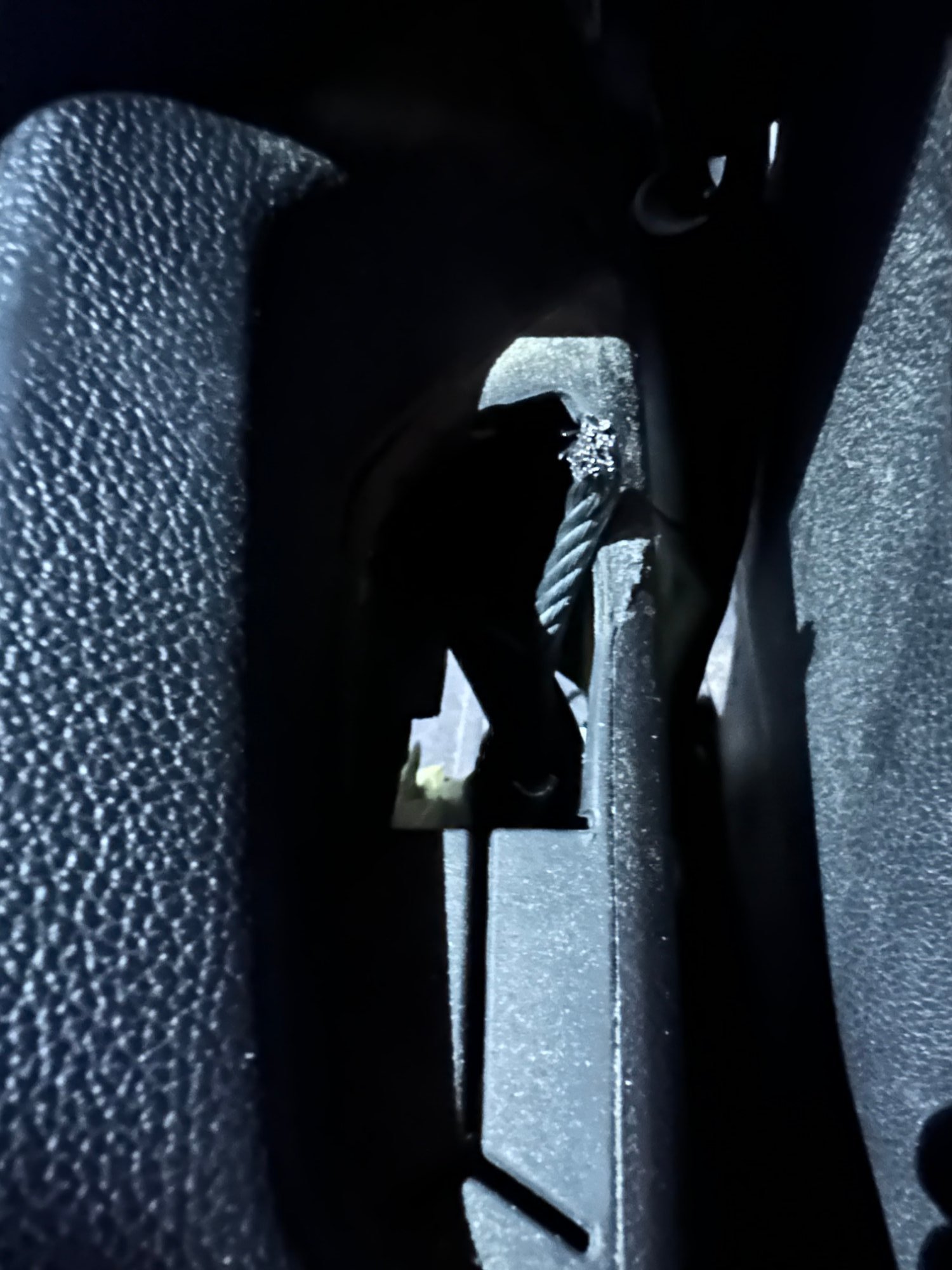

I had my appointment at the dealer today. The guy told me they had to analyze the situation to see if it fell under the special coverage. But there was a condition. If they determined it wasn't covered, then there was a $180.00 fee for investigating. There was no way to tell if it was covered otherwise. Wouldn't you know it, my broken cable wasn't covered. I asked them to put it back together and to get me the number of the zone manager. This just doesn't sound kosher. The special coverage # is N192289390. Any suggestions?
I spoke to the service manager at the dealership. He told me the seat belt pre-tensioner was still covered for my truck. I have an appointment scheduled for Monday morning. Thank you BigBadSierra. Now I just have to see if I can cancel the part I ordered
I had the 2016 recall done. According to the GM Recall and Warranty Center: "No Incomplete Recalls" Looks like I need to call my dealer,
After further review, it appears that is not the part I need. I really need the seat pre-tensioner. But I still don't understand: a) what makes the seat belt hazmat. b) what programming/setup procedures are needed
I went to buckle up today and the drivers seat belt pulled loose from the floor. I noticed the steel cable had broken just above that piece of plastic they cut up back in 2016 to prevent the cable from breaking. I've never seen this before. I only have 156K on the odometer. The actual reason for this post is that I went online to GMpartsdirect to order a replacement belt. The part number I found after entering my VIN was 19351689. I was surprised to receive an email from GMparts telling me my order was on hold because the "seat belt is classified as hazmat and is a nonreturnable part. Hazmat items must be signed for upon delivery." Now I admit I'm and old man. Heck, I was driving before the use of seat belts was required by law. But I don't understand what is in a seat belt that is considered hazmat. Can anyone enlighten me?
