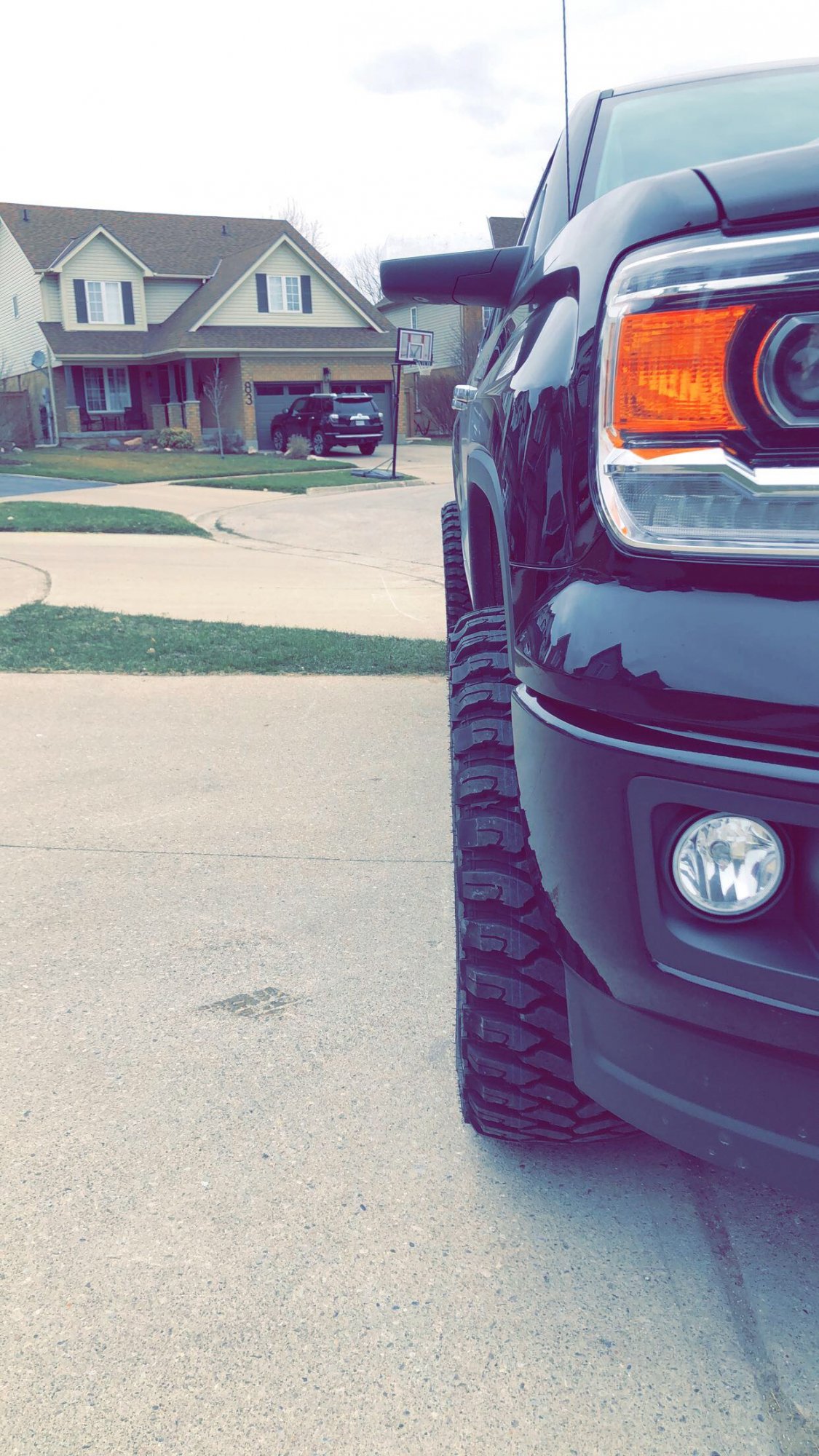

  1. Hey Whaley, i honestly think you'll be okay.. the G2's arent a super luggy tire (correct me if im wrong).. i currently have the 2.5" level, 20x10-24 with 33x12.5's.. they are the comforser MT's so they are quite luggy and i only rub a small bit of plastic (inner cab corner) in reverse.. seeing as how the 285/55R22 equals about a 34x11.2 I really think you'll be okay.. the stock tires that came on my stock 22's were 285/45R22, you're really only going up in height and staying the stock width!

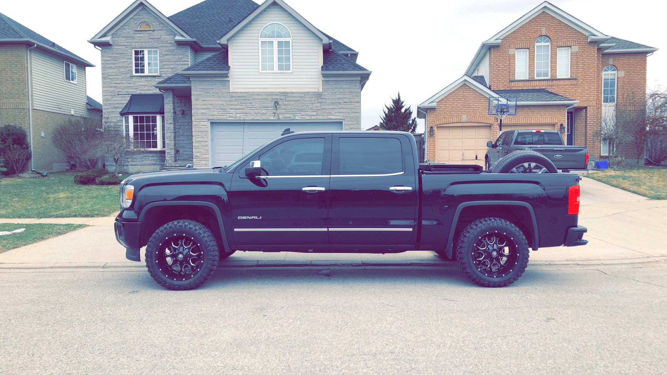

  2. I have been in and out of this form and a few others so I thought I’d post an update.. i ended up going with the SuspensionMaxx 2.5” level in the front for now.. I intended on using my stock 22’s.. however, I came across a sweet deal on new Mayhem wheels and new rubber.. I couldn’t say no! Lol here she is now.. very excited with how it turned out! The brackets for the Magride make it ride basically the same as before!
  3. Well I thought I would post an update.. I decided going with a 2.5” level in the front.. and ended up getting a sweet deal on new wheels and rubber that I couldn’t turn down.. heres a pic of her now! Very excited and turned out better than I expected!! It’s squatting a bit in the rear with the oem wheels in the back lol once they were out it was back level lol
