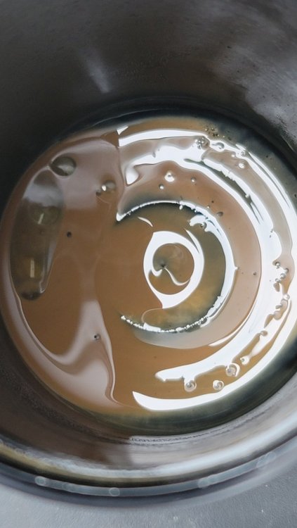

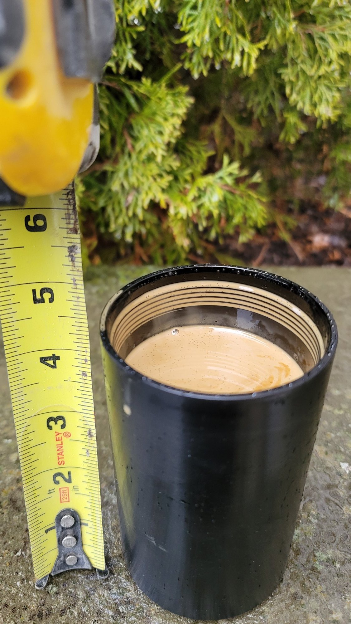

  3. The catch can works! Especially in the cold winter of the Adirondacks in NY. After a r/t of 650 miles to Lake Placid mostly highway up the NYS Thruway. Results were a full can after r/t. The construct was 80% light color and 20% black oil color. In warm weather only about 3/4" and no 'light color' just black oil color.
