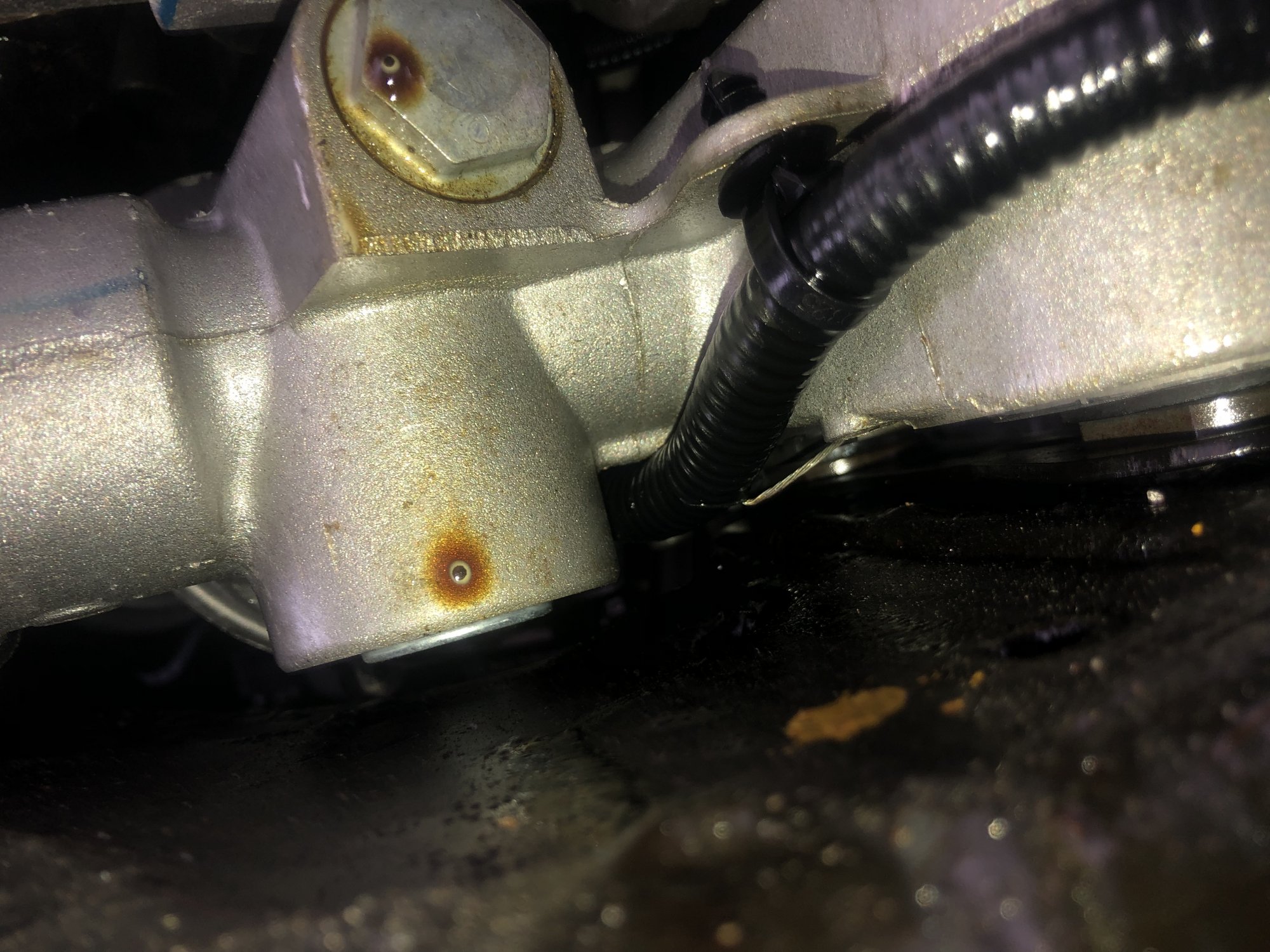

  5. Thanks for the reply... on your advice I ordered a similar tool....I know it’s only a few bucks but it just chaps my hind parts that I have to buy a tool for this. On my other gm vehicles over the years it was easy to do without any tool. Also got an early Christmas present. upon removing the cheesy plastic skid plate I discover that I have a nice sized oil leak. Not just seepage... it’s actual drops on the plate and you can see them on the steering as well. This is a 2018 truck with 3100 miles on it. I realize all I need to do is go to the dealer and tell them to make it go away but it’s annoying lol

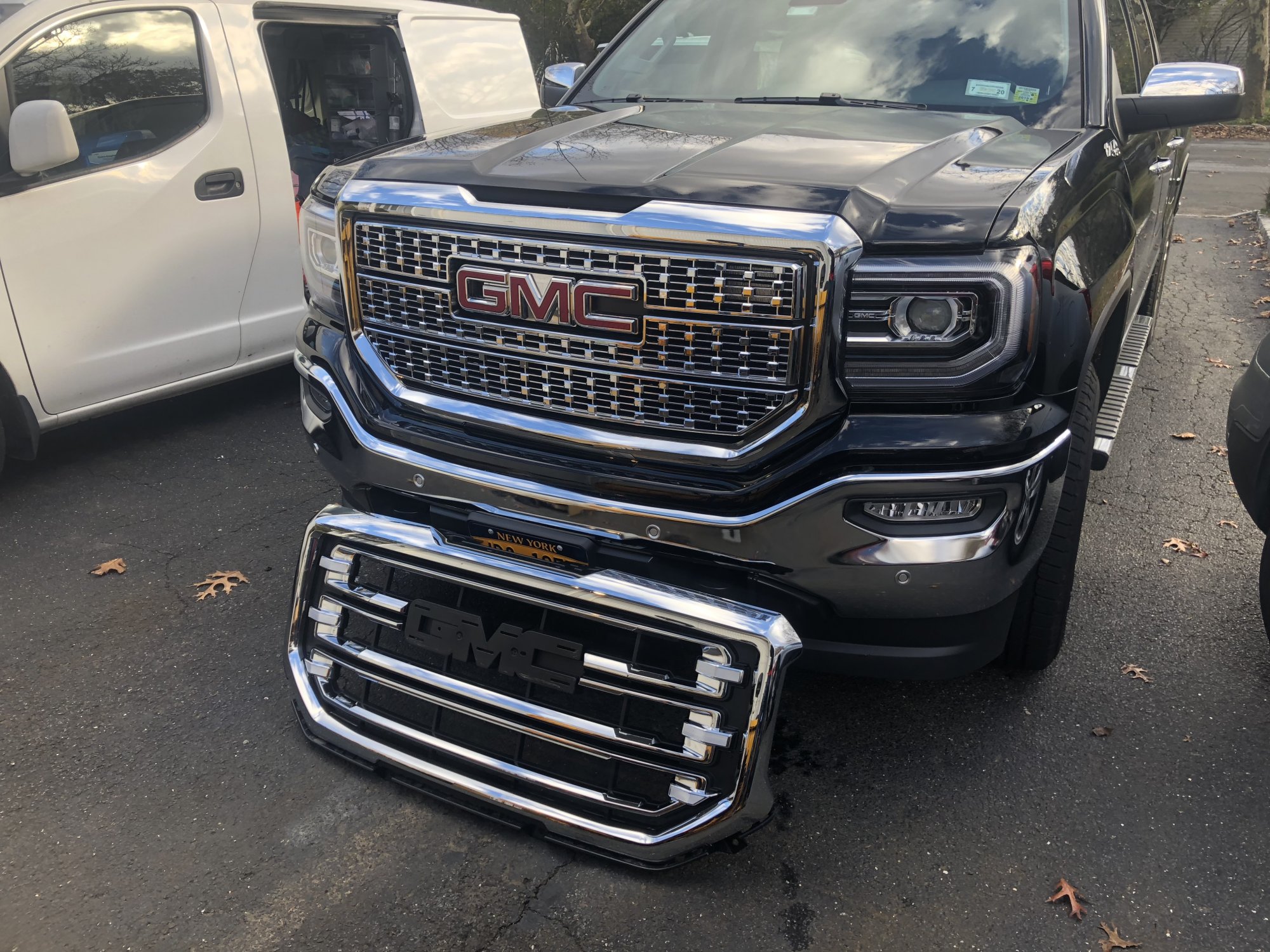

  7. Difference between stock grill and Denali
  8. 1st post ever here. I bought a 2018 slt crew over the summer. So far I installed a Dinali grill, leveled it with 2” rough country kit, and installed replica GM 22” wheels with 285/55/22 terra grapplers. Rubs only in reverse at full lock. Very slight and I think it’s on the inside rear of wheel well. There’s a little room to tie that back or maybe hit it with heat gun. Not much room for it to go because there’s metal behind it pretty close. Anyway. I’m so happy with how it looks. I used my diablewsport to calibrate the speedo. It was 4mph slow. Now it reads 2mph fast which I sort of like
