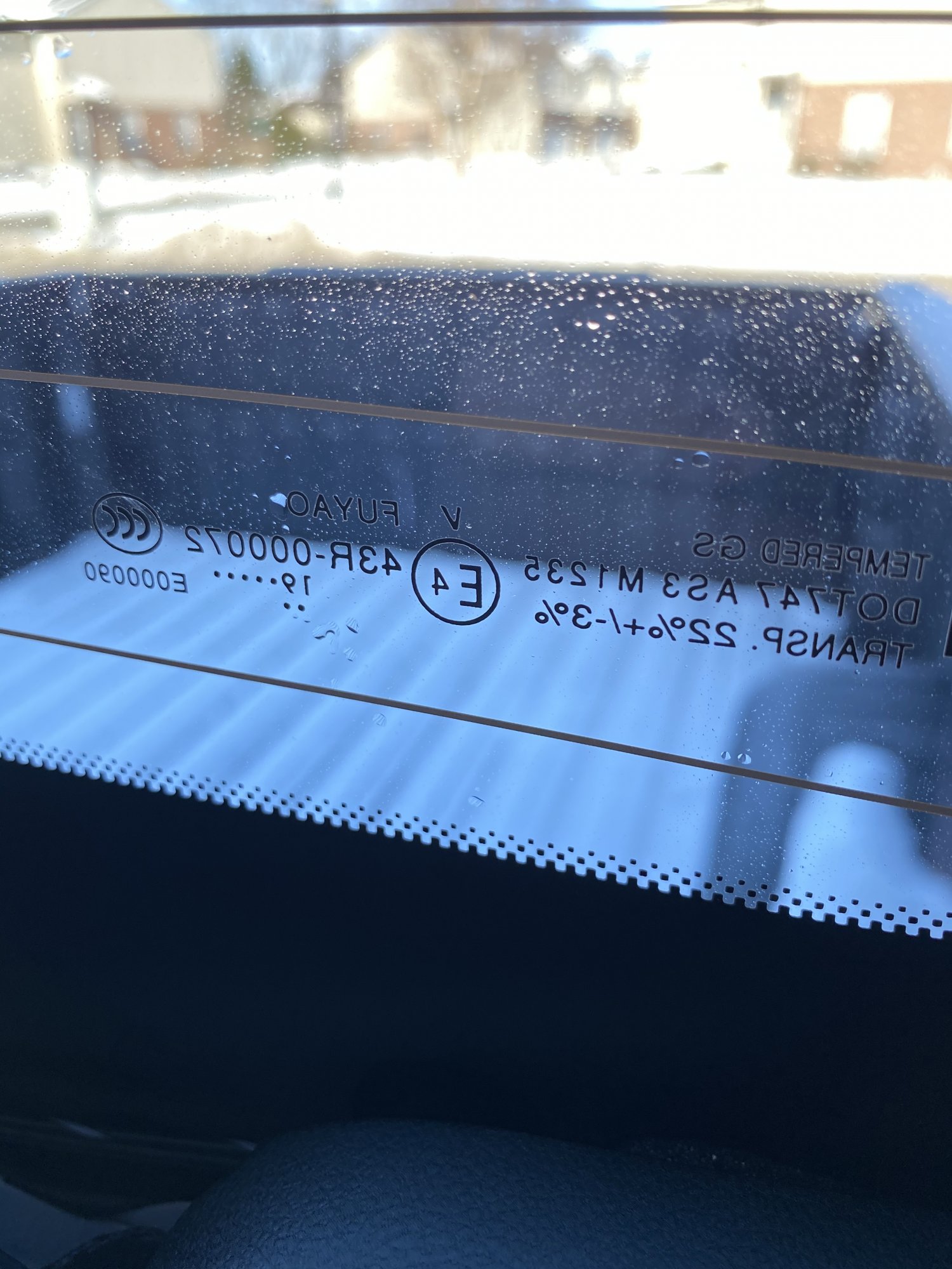

  10. Just picked up my truck, and from what i can see, looks like the dealer/window installer did a good job. Headliner and trim pieces look good. The part number of my new window is the FAYUO 43R-000072. The same that other members have received. So time will tell if this window leaks as well and as always will keep everyone posted

  13. Could these numbers on the window be lot numbers rather than model numbers? My window that is currently leaking has different numbers than the ones posted in this thread.
