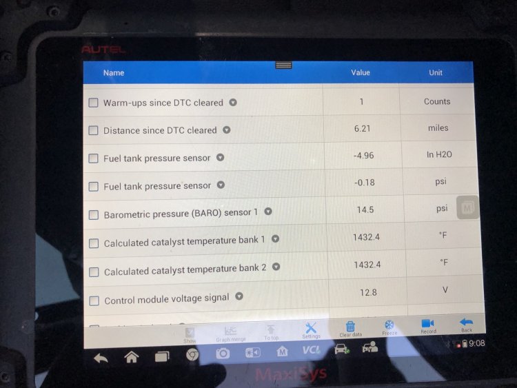

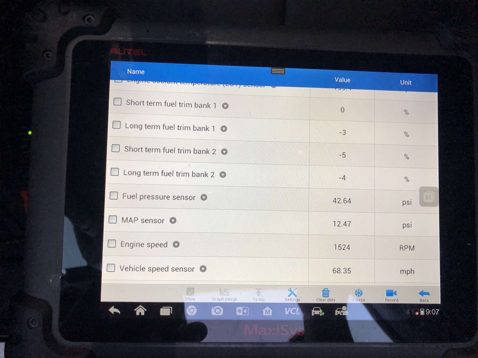

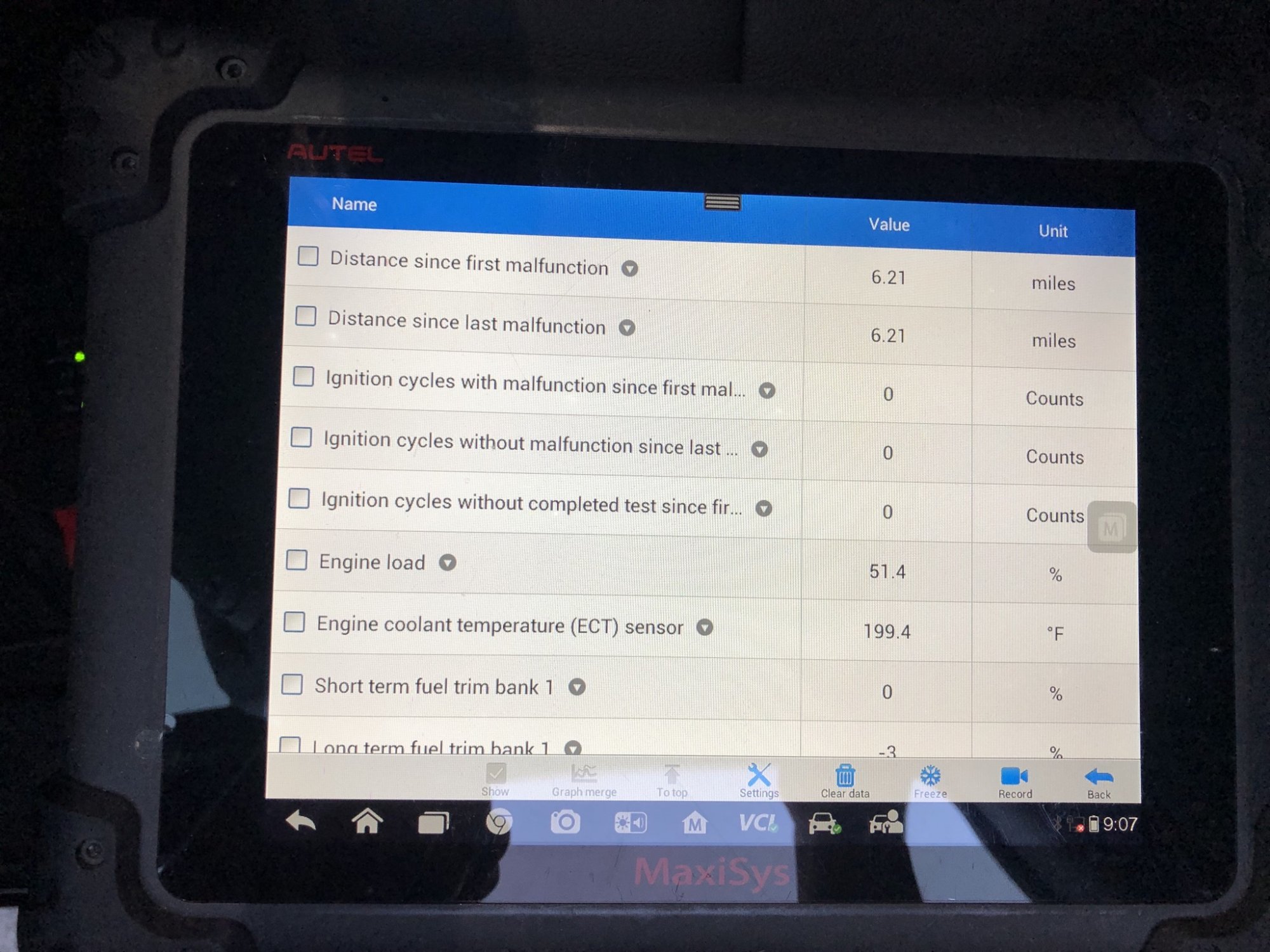

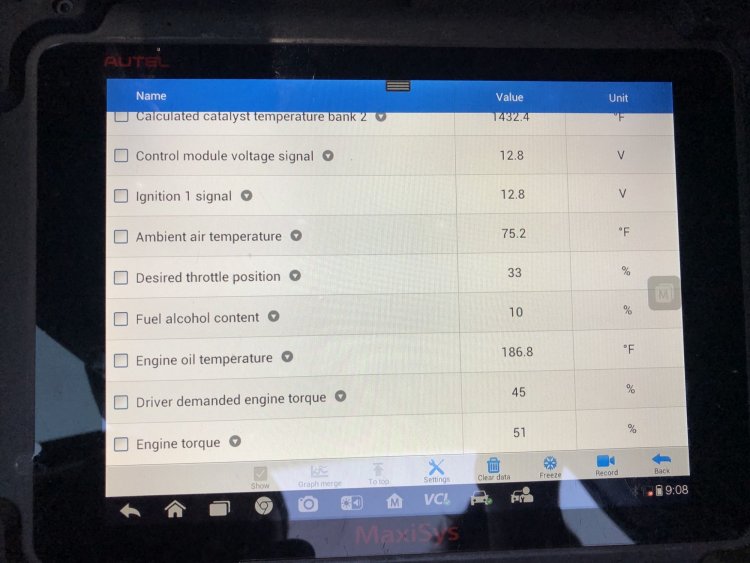

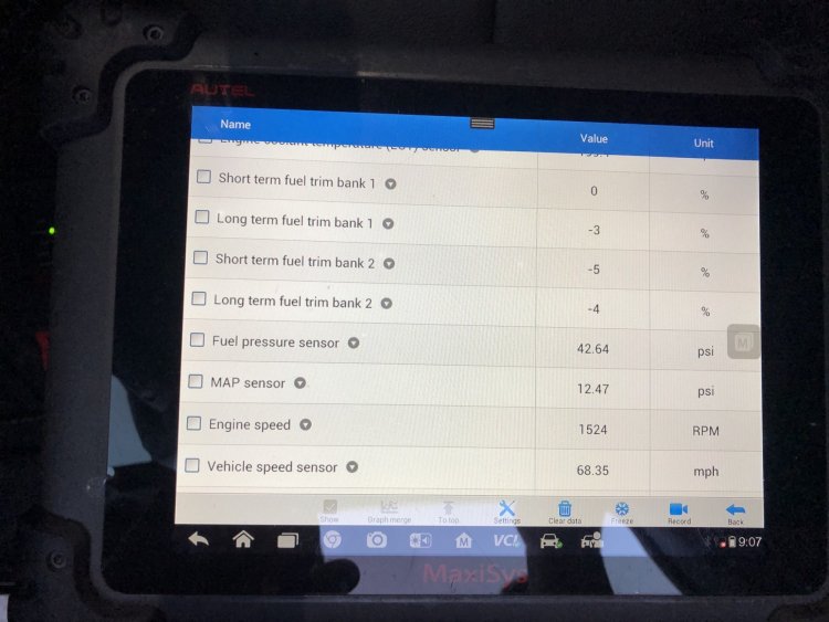

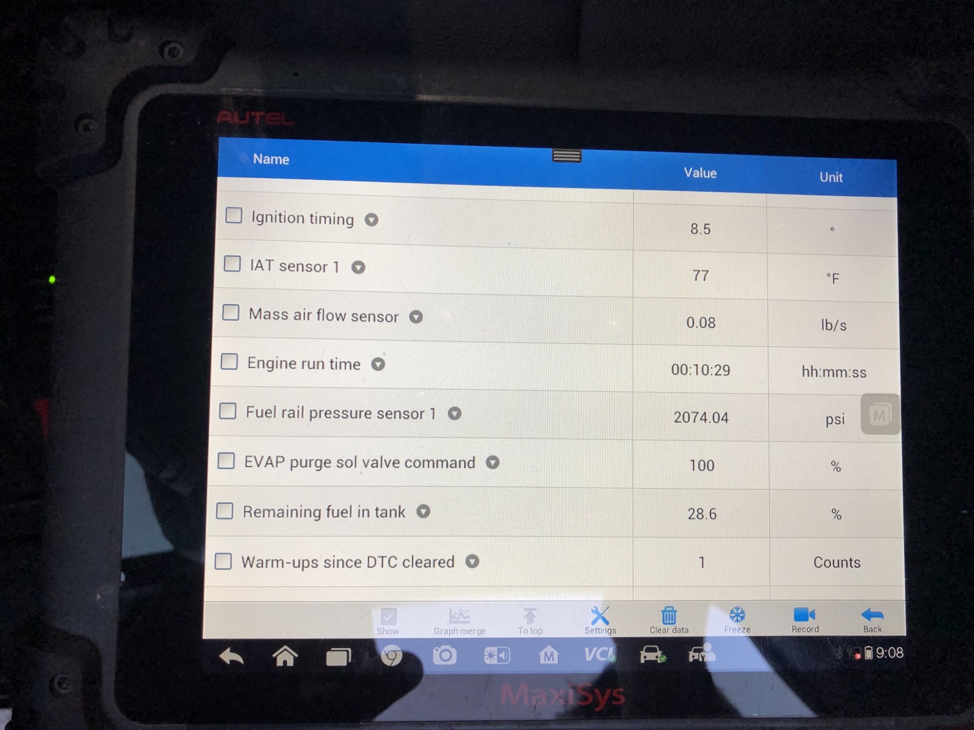

  6. Customer complaint - flashing check engine light under light throttle check engine light flashes for roughly 10 seconds. 2020 Chevy Silverado 1500 5.3 10 spd bone stock has 3800 miles on it first time bringing it in they pulled the codes and said that you have a p0300 random misfire 28 counts on cylinder 8. Cleared codes and moved on. Drive the truck 200 miles and light comes on again (flashing). pull codes and have p0300 again cylinder 8 120 counts. Ill attach pictures of the freeze frame data. Seams to run good only complaint is chugging under light throttle when going 40-60 range Very upset about this.
