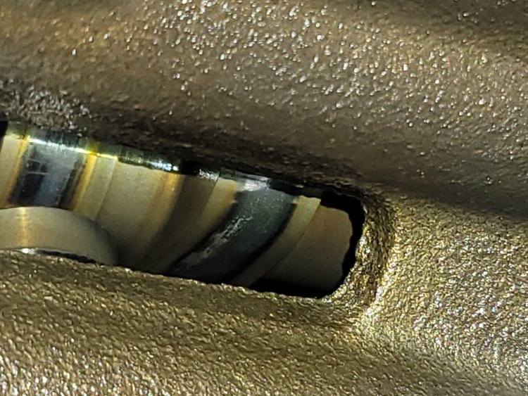

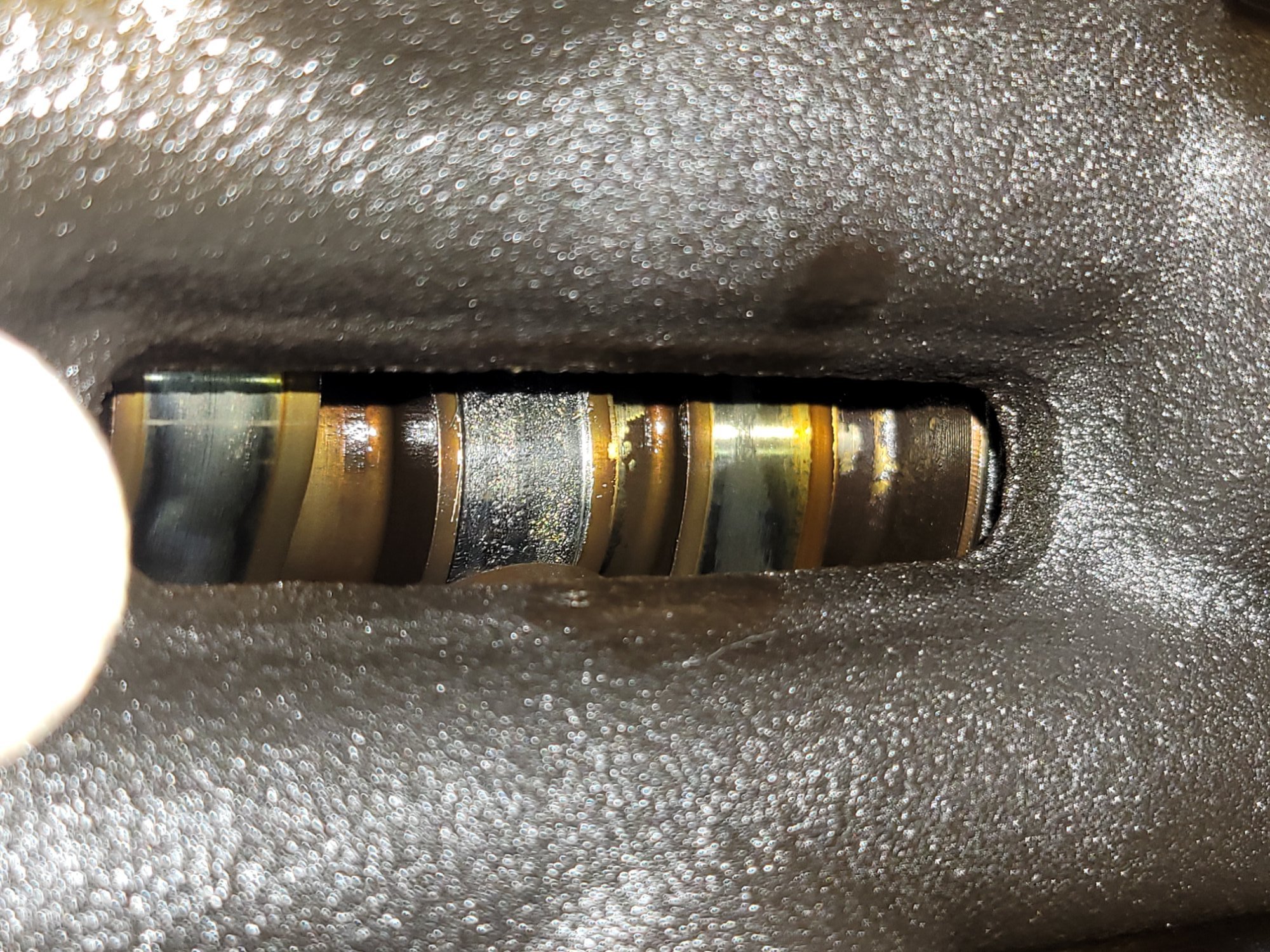

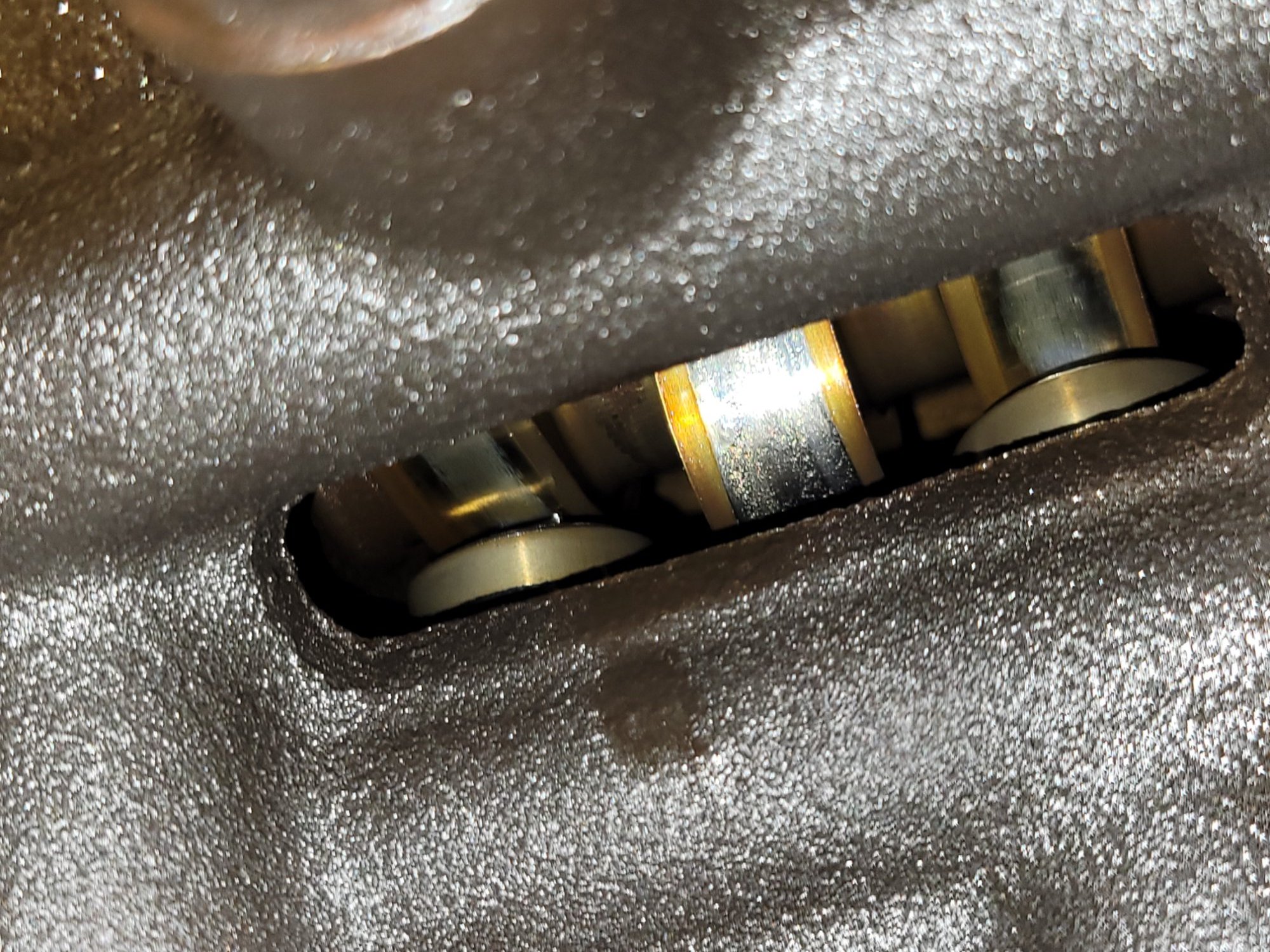

  3. Found it, looks like a lifter failed and destroyed a lobe on the Camshaft. Also slightly bent pushrod and scoring on another cam lobe. From how deep the groove in the cam is I assume there has to be metal debris in the engine. Seems i should replace the long block or rebuild this engine entirely short block and all. Only other option I can think of is pulling and cleaning put the oil pan, replacing just lifters/pushrods/cam and praying no oil galleys get blocked.. Any advise appreciated!

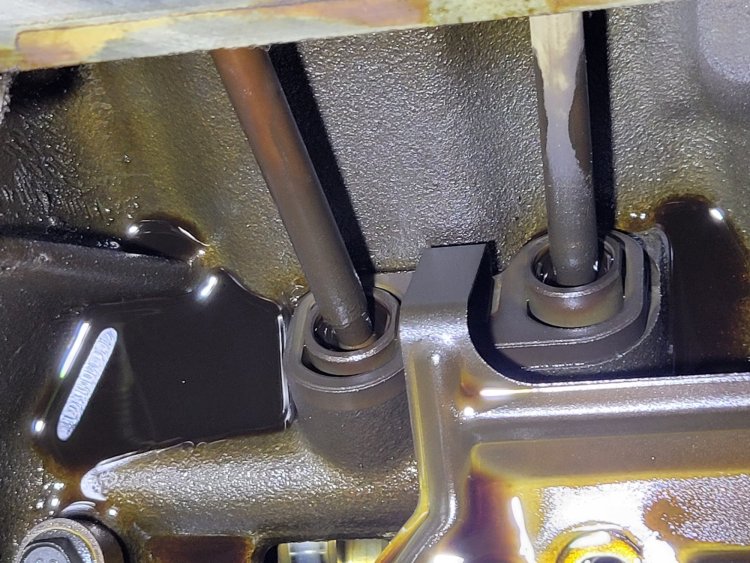

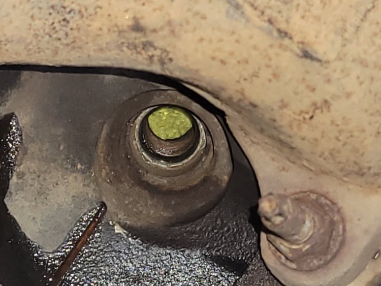

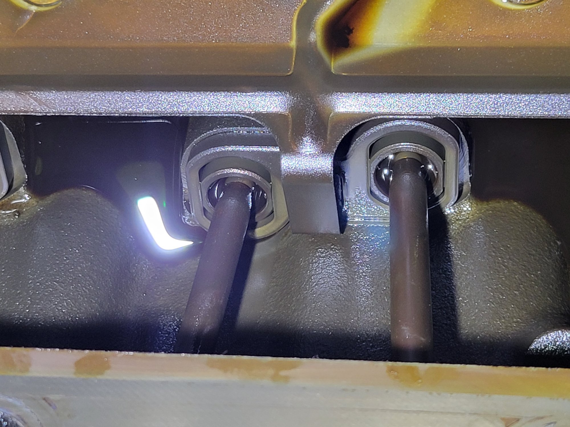

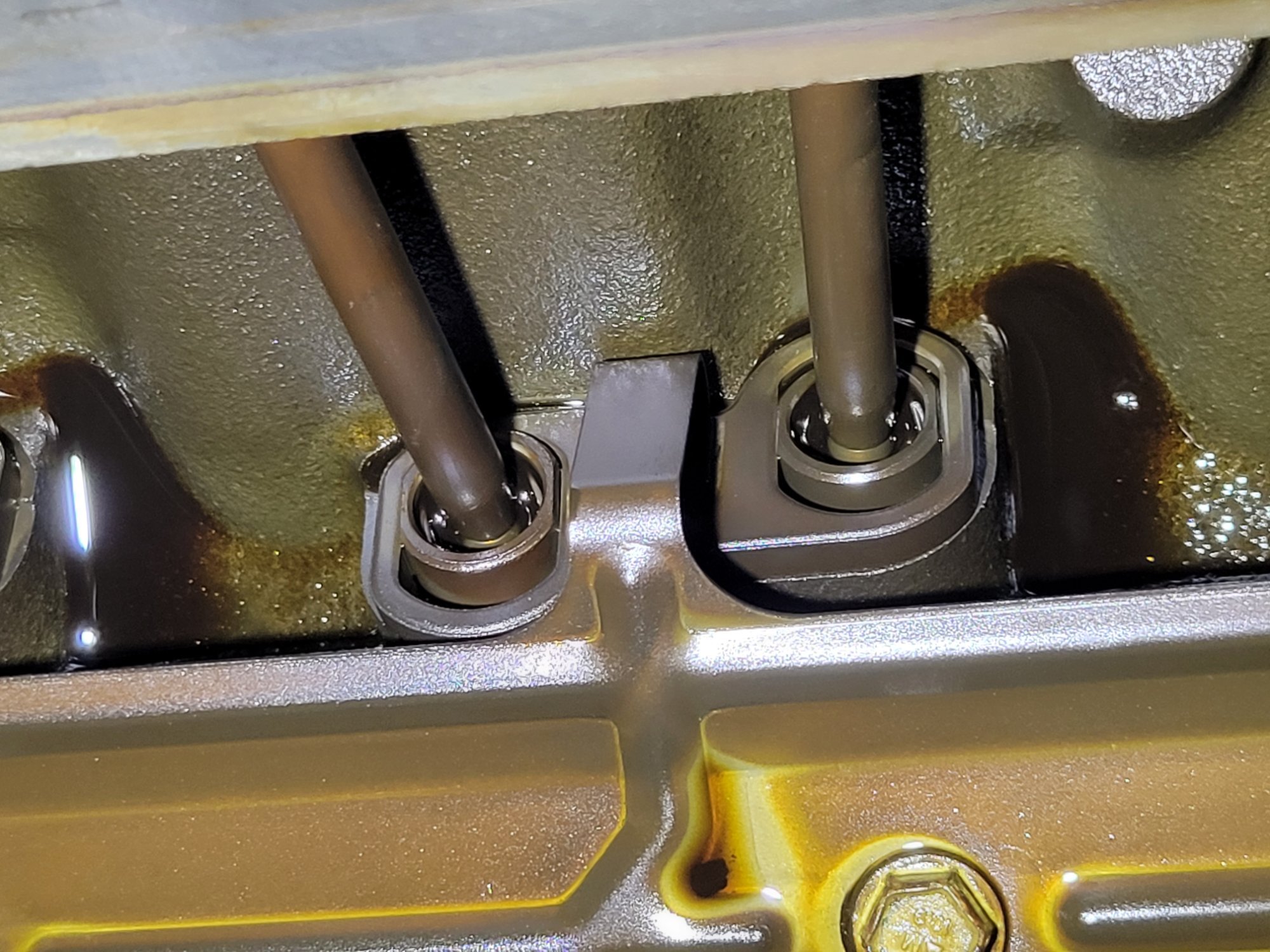

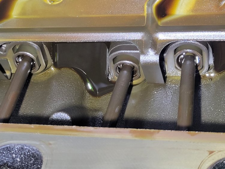

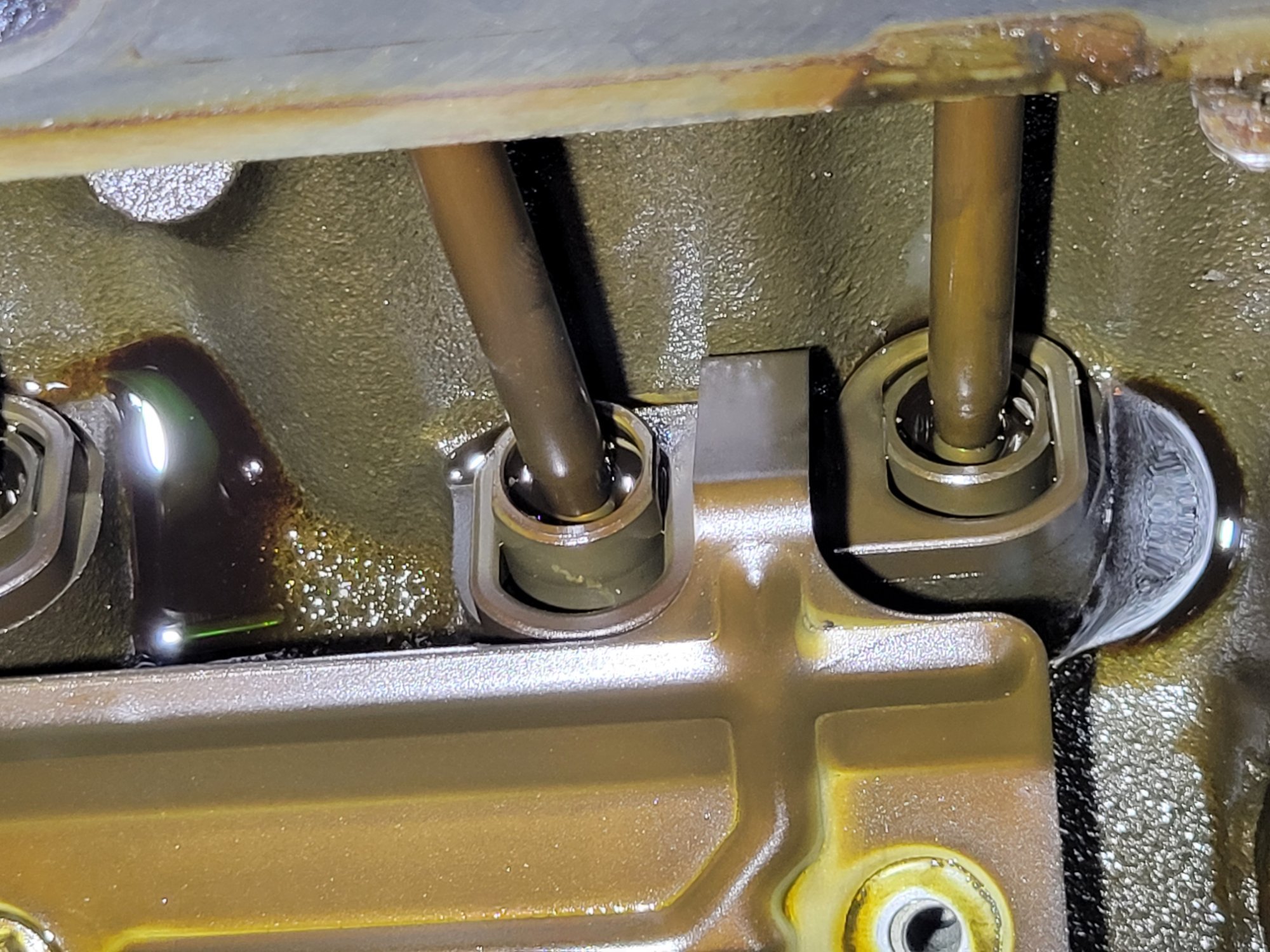

  4. Hey all, my 2002 Silverado 2500HD 8.1L w/ Allison transmission recently started making an intermittent but rhythmic squeaking/scratching noise that seems to be coming from engine internals. Video of engine noise https://drive.google.com/drive/folders/1ANVafHeQLibrg7velXbiScdqP4Fb3hlF Noise is about the same through rpm range. Engine has 240k on it, no aftermarket modifications. Fearing lifter failure I went ahead and pulled the intake manifold to inspect lifters, did not see any loose retaining clips and felt all pushrods, none have excessive play. Attached pictures of lifters. Cam lobes that I could see looked fine. When I get off work I will spin the engine over, feel all pushrods for play as the bad one could be compressed and not showing play currently. Also will pull the valve covers and inspect springs/rockers. I know I jumped the gun by tearing down but has anyone else had experience with this noise? Sound seems to be coming from top end, not a deep noise like bottom end. I do have a one snapped off exhaust manifold bolt, rest are tight but doesn't sound like an exhaust leak to me. Appreciate any input thanks.
