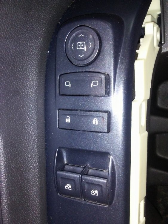

  5. Here's the Sierra driver power door panel switch assembly. I have a 2 door regular cab.

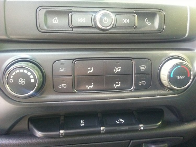

  6. You said, " There is a separate power wire for the power adjust switch." Can you please clarify what the "power adjust switch" is? Is that for the power mirror? I'm going from base W/T manual mirrors to DL8 power mirrors. What door jamb pin provides the DL8 mirror power? I did grab the different A/C switch assembly from the center dash on the Sierra that has the heated mirror button.
