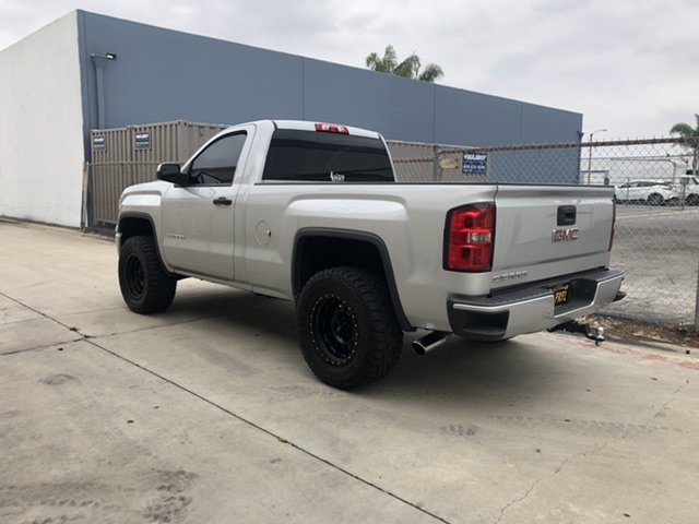

  4. So i decided to purchase the Denali tail lights to put on my truck and was wondering if someone has actually wired up the resistors themselves rather than buying a harness, kinda want to try it out and do it myself, trying to learn something new and save a few bucks, i know i have to sets of new resistors sitting in my garage but not sure if those will work out 2D86FEDB-D7D1-462A-9C5D-638CF1C97979.webp

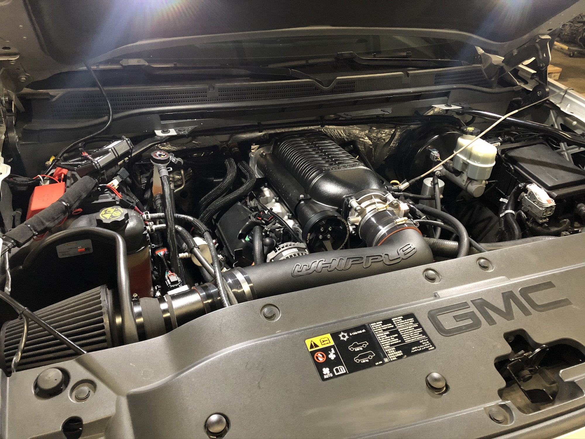

  6. I paid $6,450 shipped for my 2.9 Whipple, hit up terry at beefcake racing for good prices you can get 15% off right now with the christmas sale https://www.beefcakeracing.com/search/search-results/#?Year=2014&Make=GMC&Model=Sierra+1500&search_return=all&Category1=Superchargers
  7. Little update so I ended up just putting in the whipple without upgrading the fuel system, decided i wasn't going to run E85, and yeah the kit came with spark plugs that we gapped to .20 i went with a custom tune, i had them gapped at .32 or .30 as whipple instructs but the truck would sputter, so my tuner decided to go with .20 and the truck runs flawless also went with the 4.125 pullet which put me at 11pounds of boost
  8. Nice, thanks for the info, i purchased LT4 fuel injectors and the LT4 high pressure fuel pump, also bought the aeromotive 450 in tank fuel pump, kinda had to upgrade everything since im planning on running E85
  9. Yes it will be a custom tune, im not sure what map sensor it comes with but, i should just run it on 91 oct then right?
  10. Ah ok i see, i will do a little research and see which way i go, kinda want to run it on e85 but ill see which way i end up going, cool i will look for them and see what i find, thanks for the help, ill let you know what i end up going with
  11. Ah ok i see, i purchased this fuel pump today and have it in hand Should i just slap it in to be on the safe side? I usually run e85 on my truck https://aeromotiveinc.com/product/340-fuel-pump-center-inlet/ Do you happen to have a part# to the spark plugs or what years of the zl1 or supercharged corvette plugs should i use

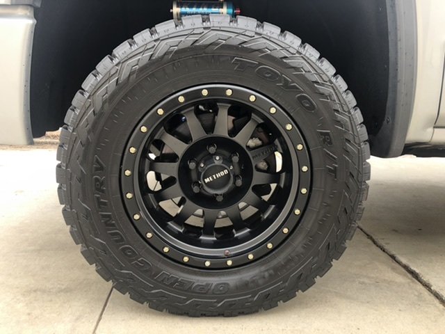

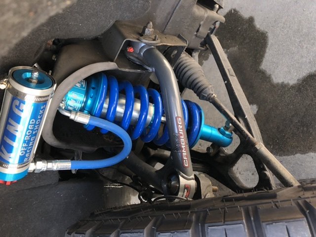

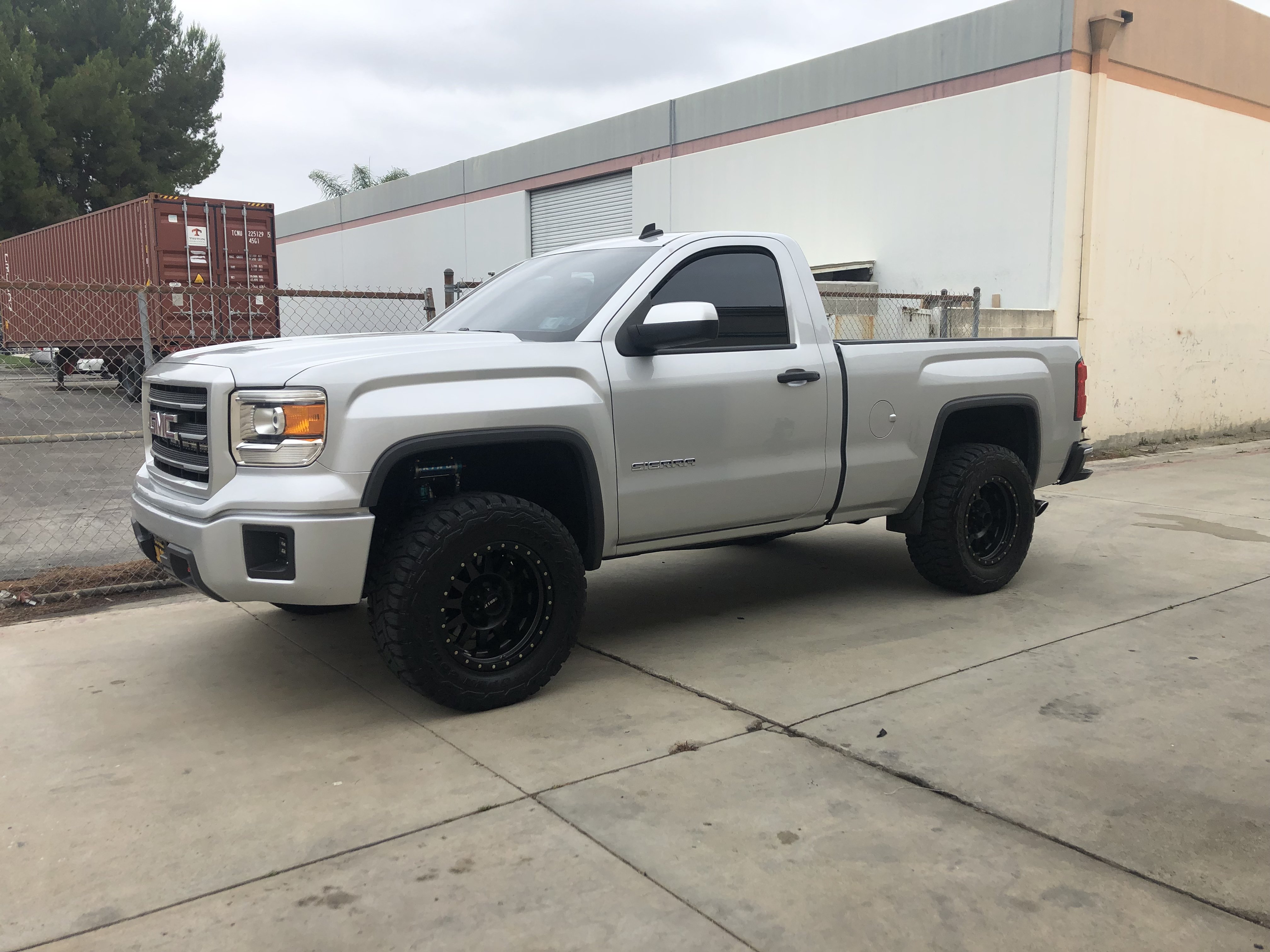

  12. Hey guys new to the forum here, i have a 2014 GMC Sierra 5.3 RCSB on 2.5” king coilovers with camburg uca Running on 33’s and just ordered a 2.9 whipple supercharger for it and was wondering what Mods i will need in order to have it running good,, eventually i will max out my coilovers and go with 35’s i have a bout a 1-1/2” more to max them out, so far i have a k&n cold air intake and a Borla s-type cat back exhaust system tuned on 91 octane, would I need to upgrade my fuel system/in tank fuel pump or should i bee good to go? i hear the aeromotive 11540 kit is good enough but someone told me that i need to go with a 450lph instead of the 340lph Due to the starvation of the motors what do you guys think? Any help is appreciated, thanks!
