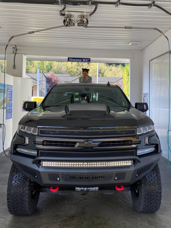

  1. Another update. Its been a few weeks. Lots of rain here in the Northwest and still no leak after the window was replaced. I took it to the self car wash(it needed it). Soaked the top and got it all shiny again. I didn't find a drop inside. I hope it stays that way
