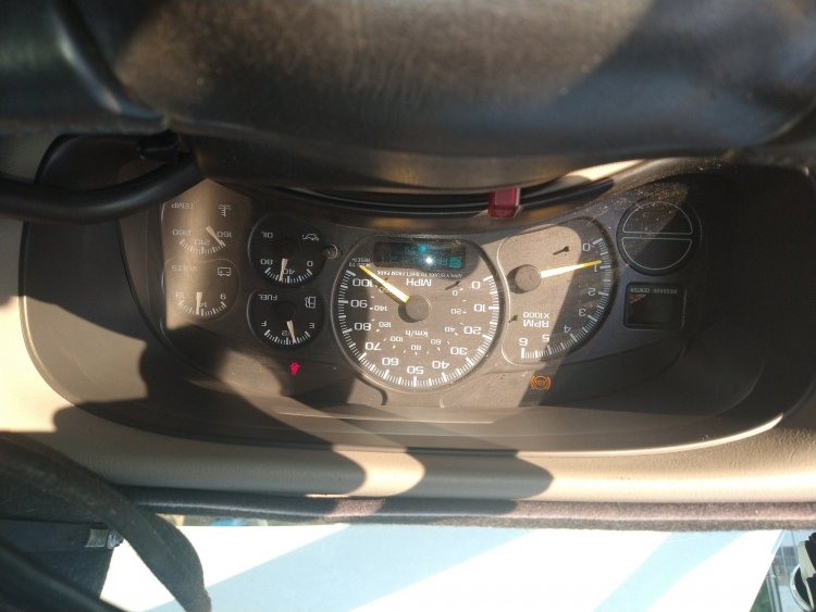

  2. Ok so removing the fuse dident work. Resetting the gauges dident work but what did work to reset the gauge was too remove positive and negative terminal and ground them together then the gauge reset
  3. So I was doin some maintenance and replaced my battery when I jumped in to redo my settings i noticed my speedo is maxed out . Is there a way to reset my dash? I tryed the turn ignition on tap gas 3 times to the floor but nothing happened.
