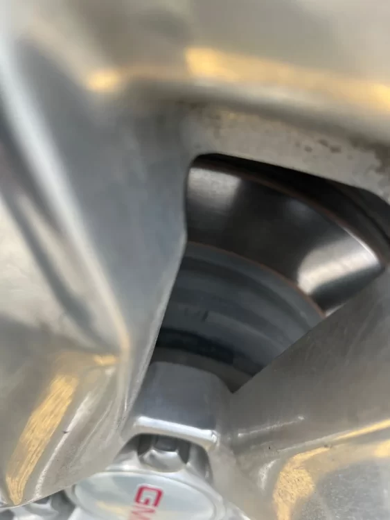

  1. I know the OP was asking about the caliper clearance and spacers which the info transient linked is still applicable but just saying that if someone is concerned about UCA clearance this applies as well.

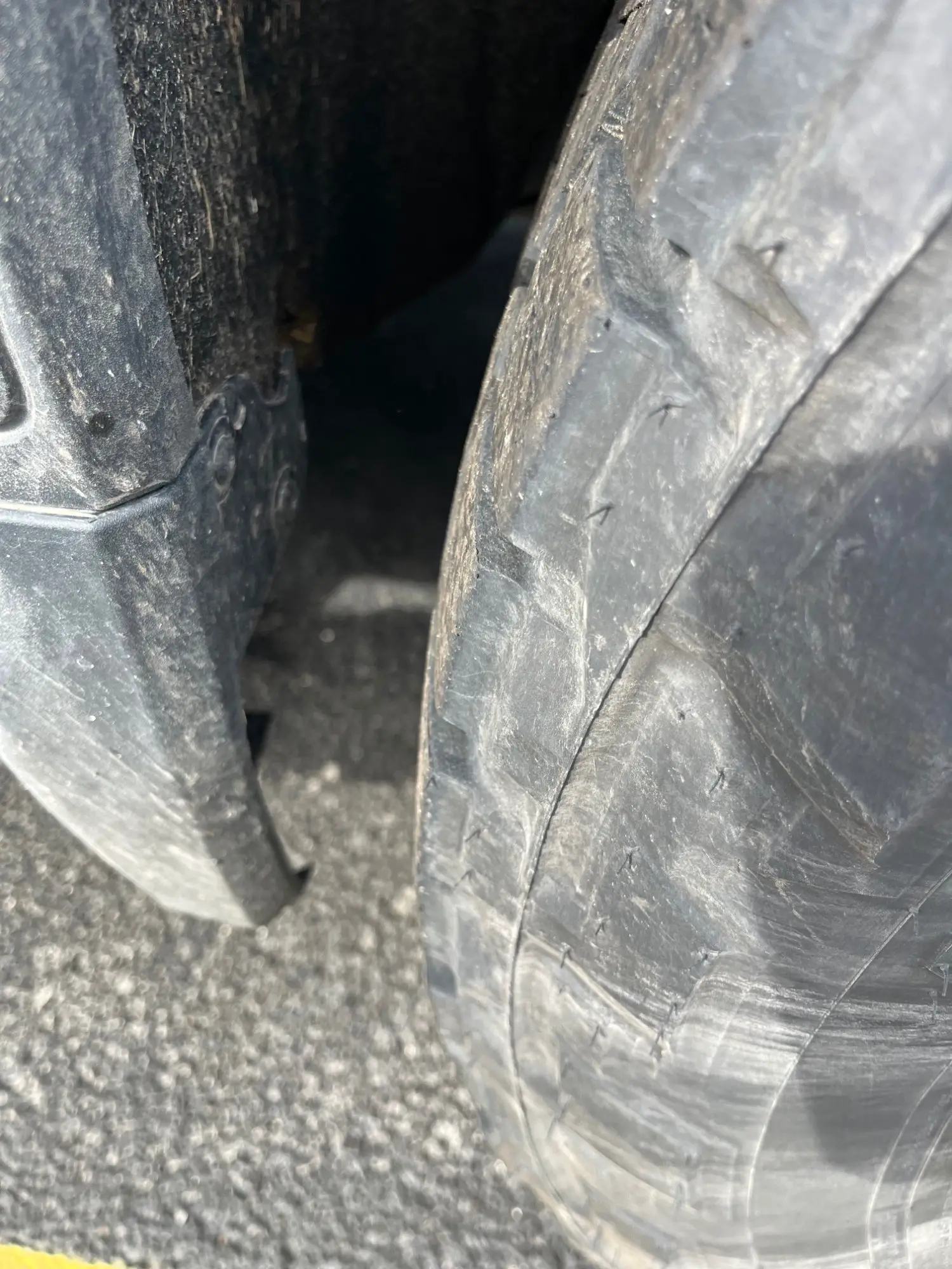

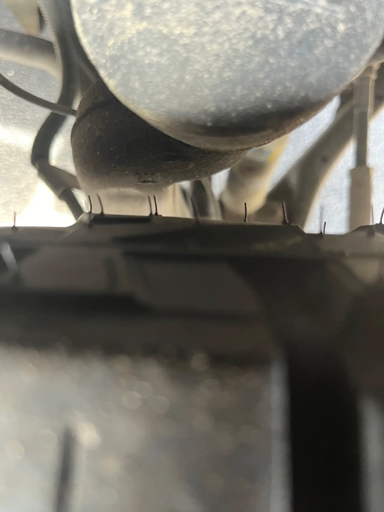

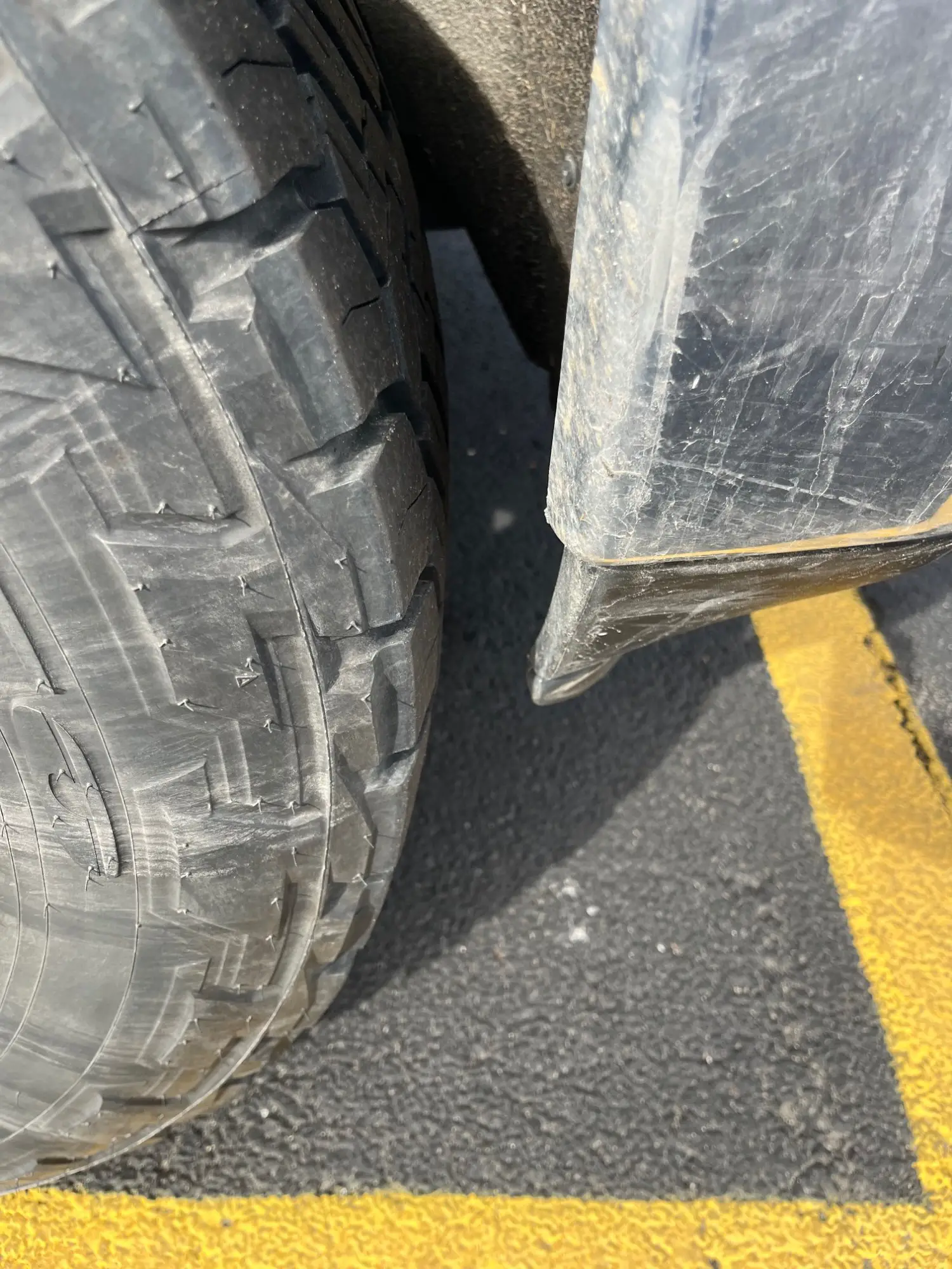

  2. The caliper is not where I was concerned about clearance the tires rubbing against the UCA was my concern. The factory 275/60R20s are very close to the UCA from the factory anything much wider and the outer lugs of the tread could rub under certain conditions. I put the 1/2” hub and wheel centric billet spacers on to compensate for this and have just larger than the factory gap at the UCA.

  5. This gives you an idea of the clearances with the above listed modifications. Please excuse the salt residue from our wonderful DOT team.

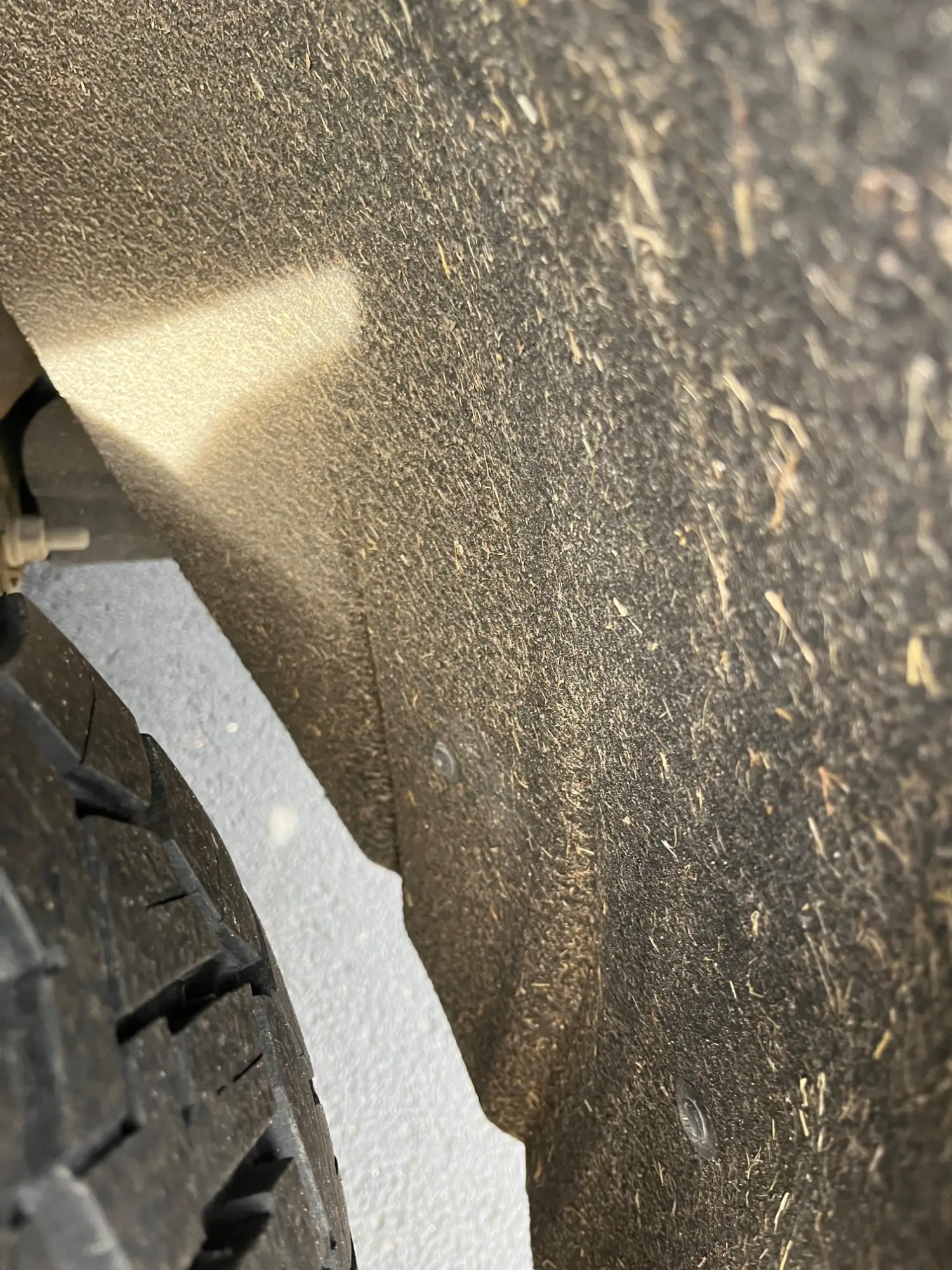

  6. Let me preface by saying I do not have a Denali. I have a 22 SLT that I installed an AT4 lift onto. I placed 1/2” pucks on the front essentially giving me 2.5” of lift in the front and 2” of lift in the rear. I also installed Rough Country UCAs. onto the truck do to the fear of factory UCA catastrophic failure. Along with the lift I used hub and wheel centric billet 1/2” spacers……. Wheel studs are from an early 2000s super duty….. yes they fit. Front replacements are Dorman 610-530 M14-1.50 Serrated Wheel Stud - 15.90mm Knurl, 78mm Length, Rear replacements are Dorman 610-490 M14-1.5 Serrated Wheel Stud - 15.7mm Knurl, 69.75mm Length. These front and rear replacement wheel studs are just under 5/8” longer than stock studs. This allows you to have the same thread engagement with the lug nuts as stock. As well as the lift and wheel spacers I had to trim the front fender well. Here is the write up I used for trimming. https://wheelsasap.com/gmc-at4-oversized-tire-trimming-guide/ My tires are 275/65R20 Nitto Recon Grappler. Overall diameter is 34.09” and Overall width is 10.98”. My tires are 3/10 of an inch shorter and 3/10 of an inch narrower than what you are looking at doing. I had to do all of the above to fit my tire without rubbing. The stock 20” SLT wheels and the Denali Ultimate 22” wheels have the same backspacing and offsets.
