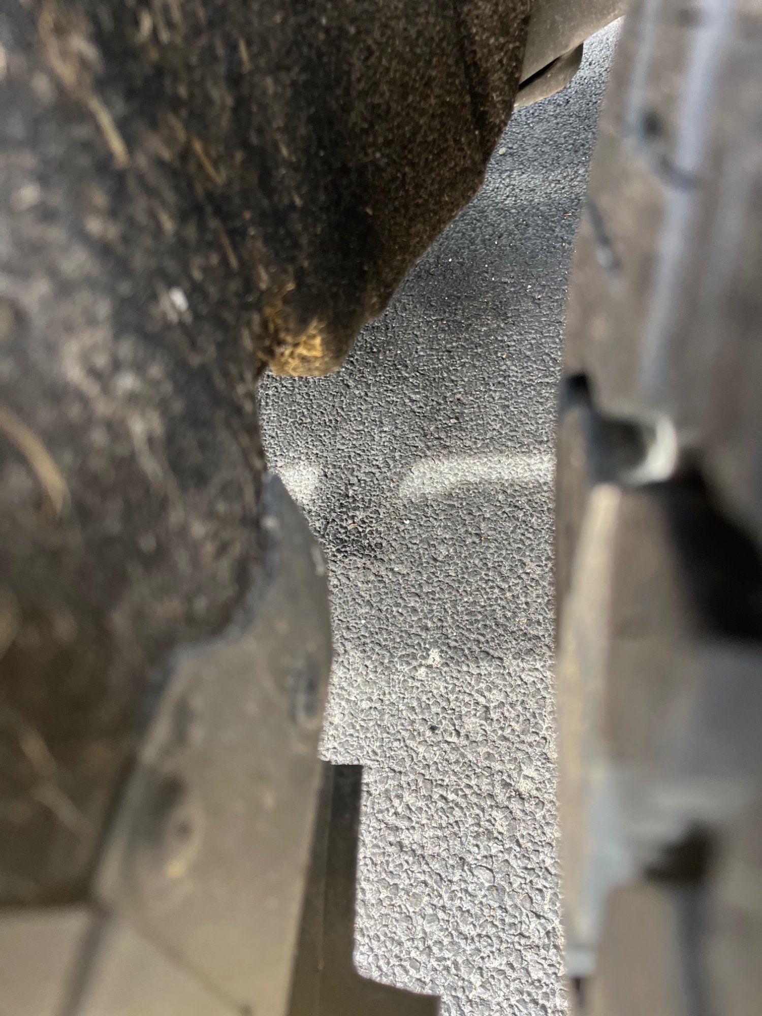

The caliper is not where I was concerned about clearance the tires rubbing against the UCA was my concern. The factory 275/60R20s are very close to the UCA from the factory anything much wider and the outer lugs of the tread could rub under certain conditions. I put the 1/2” hub and wheel centric billet spacers on to compensate for this and have just larger than the factory gap at the UCA. -

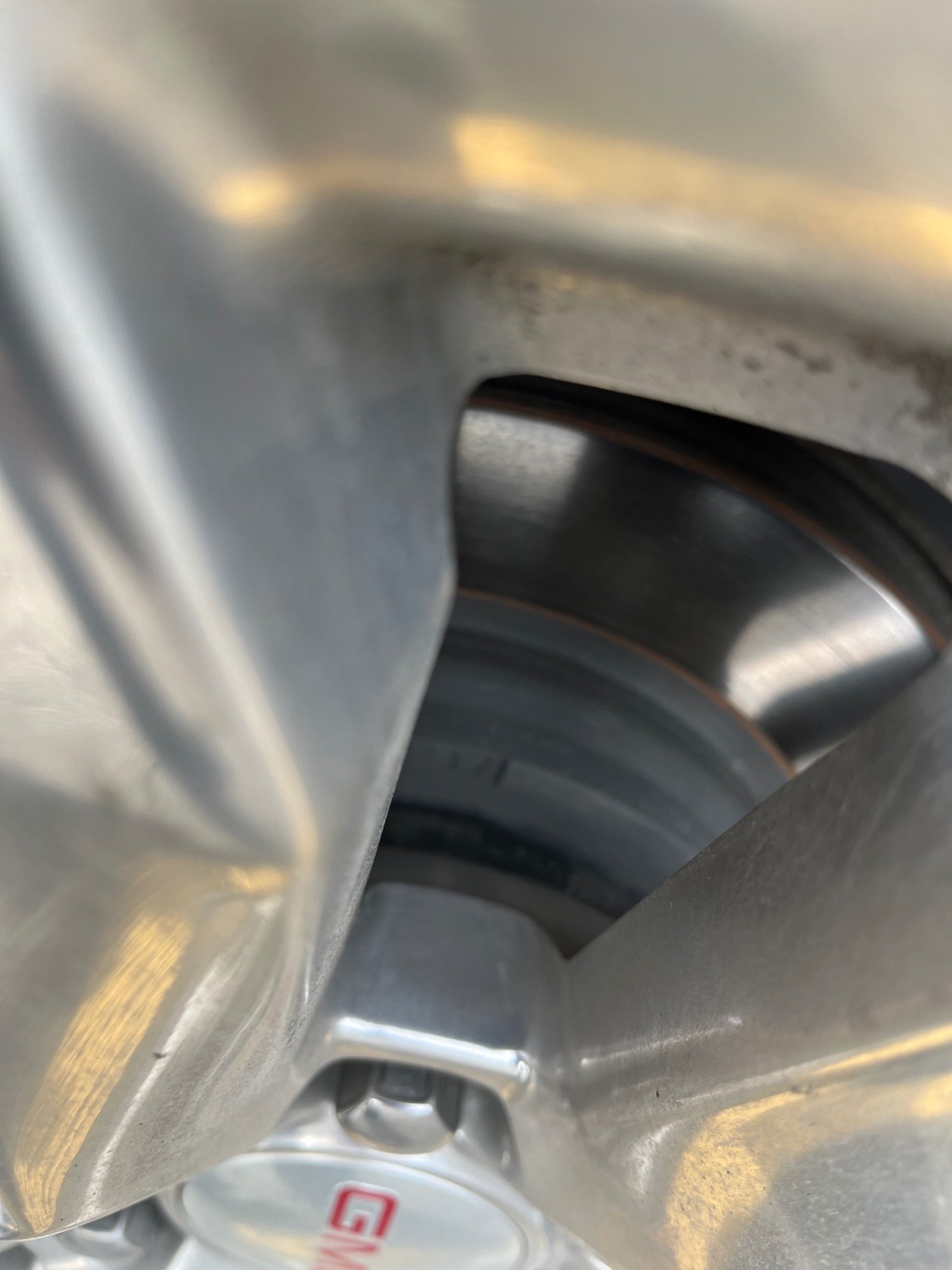

This gives you an idea of the clearances with the above listed modifications. Please excuse the salt residue from our wonderful DOT team.

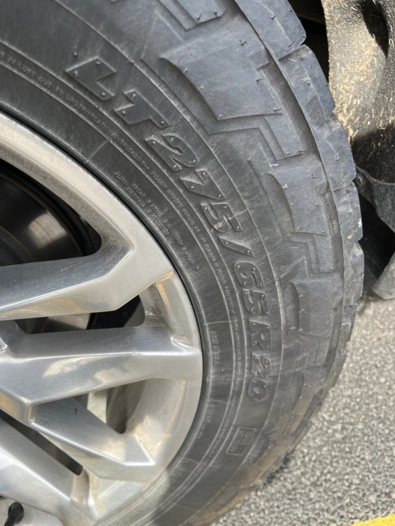

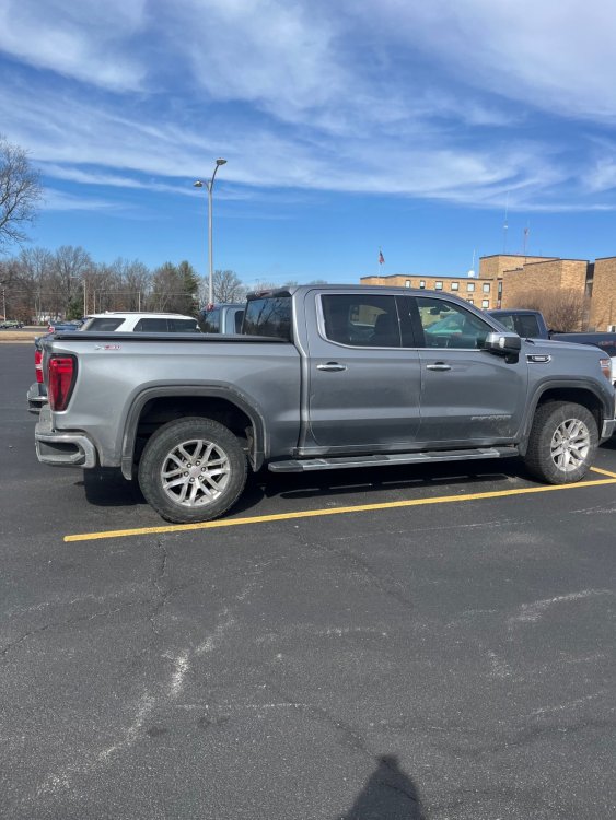

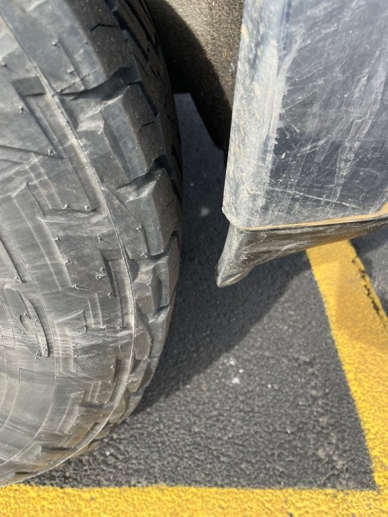

Let me preface by saying I do not have a Denali. I have a 22 SLT that I installed an AT4 lift onto. I placed 1/2” pucks on the front essentially giving me 2.5” of lift in the front and 2” of lift in the rear. I also installed Rough Country UCAs. onto the truck do to the fear of factory UCA catastrophic failure. Along with the lift I used hub and wheel centric billet 1/2” spacers……. Wheel studs are from an early 2000s super duty….. yes they fit. Front replacements are Dorman 610-530 M14-1.50 Serrated Wheel Stud - 15.90mm Knurl, 78mm Length, Rear replacements are Dorman 610-490 M14-1.5 Serrated Wheel Stud - 15.7mm Knurl, 69.75mm Length. These front and rear replacement wheel studs are just under 5/8” longer than stock studs. This allows you to have the same thread engagement with the lug nuts as stock. As well as the lift and wheel spacers I had to trim the front fender well. Here is the write up I used for trimming. https://wheelsasap.com/gmc-at4-oversized-tire-trimming-guide/ My tires are 275/65R20 Nitto Recon Grappler. Overall diameter is 34.09” and Overall width is 10.98”. My tires are 3/10 of an inch shorter and 3/10 of an inch narrower than what you are looking at doing. I had to do all of the above to fit my tire without rubbing. The stock 20” SLT wheels and the Denali Ultimate 22” wheels have the same backspacing and offsets.

My statement is still true. the diameter of the wheel has nothing to do with the tire size. He said he went from a 17” wheel to a 20” wheel and gained three inches …… the wheel had nothing to do with it. The difference in tire ratios did. I understand completely how aspect ratios work on tires. My statement was also that I went from a stock 275/60R20 (32.99 x 10.99 inches per Goodyear) to a 275/65R20 (34.09x10.98 inches per Nitto) the Nittos are the recon grappler. My stock Slt was lifted 2” in front and had 1/2” wheel spacers on stock 20” Slt wheels and I rubbed the fender liner, leading to it needing to be altered …. So everyone can speculate all they want but I speak from experience I doubt a 275/65 tire will fit a non at4 or trail boss truck with out modifications
I have attached photos for reference…… should any one be interested…… I used hub and wheel centric billet spacers 1/2” spacers……. Wheel studs are from an early 2000s super duty….. yes they fit. Front replacements are Dorman 610-530 M14-1.50 Serrated Wheel Stud - 15.90mm Knurl, 78mm Length, Rear replacements are Dorman 610-490 M14-1.5 Serrated Wheel Stud - 15.7mm Knurl, 69.75mm Length. These front and rear replacement wheel studs are just under 5/8” longer than stock studs. This allows you to have the same thread engagement with the lug nuts as stock. The AT4 and Trail boss suspension parts can be found pretty plentiful on eBay as new take offs from 4x4 shops. You will also need the upper control arm as well as they are different on the AT4 and Trailboss. Here is the write up I used for trimming. https://wheelsasap.com/gmc-at4-oversized-tire-trimming-guide/ My tires are 275/65R20 Nitto Recon Grappler. Overall diameter is 34.09” and Overall width is 10.98”. If you have any further questions please ask.
Also the 275/60R20 is a stock tire/ wheel combo as is the 255/70/17 so both are stock configurations. This is why they are interchangeable. I am not saying the 275/60 is not slightly larger than the 255/70 because I believe it is about 2” taller what I am saying is he is asking about a larger tire than stock. My truck had 275/60 on it stock and very little “extra” room. I put the AT4 suspension on my truck which is a 2” over normal lift and 1/2” wheel spacers with longer wheel studs, I had to trim the front mud flap and zip tie the inner fender liner to get 275/65 to fit with my stock 20” slt wheels
