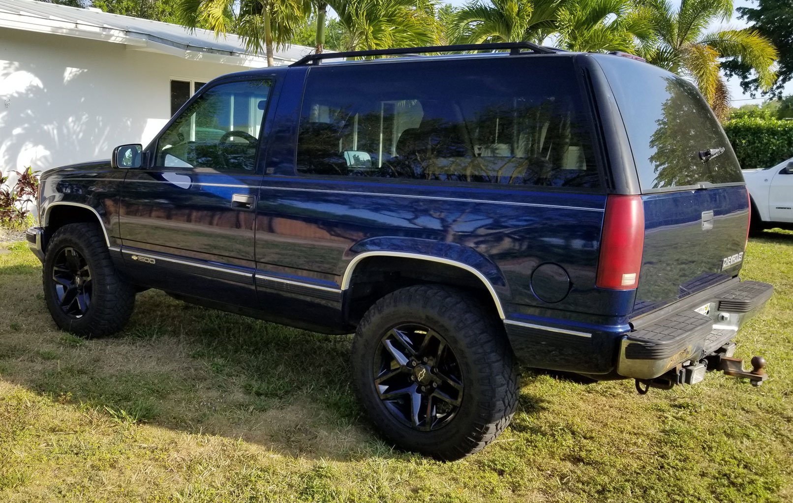

  1. Well, I got some 18" trailboss rims with stock 275/65/18 tires, they fit fine, seem to have plenty of room.
  2. Got the cat replaced, no more rattling. I just rebuilt the whole front suspension, brakes, new shocks, etc. My next project is to upgrade the wheels and tires, I'm trying to figure out what will fit best. I'm looking at some factory 18's or maybe 20's off of the newer trucks, they are readily available. My truck came from the factory with 265/75/16's, with 16x7" ET 50mm rims. Newer 18's come with 265/65/18s, the rims are 8.5x18 ET 26. The height works out about the same, and from what I can tell, the additional rim width pushes mostly to the outside. https://www.wheel-size.com/calc/?wheel1=265-75-16X7ET50&wheel2=265-65-18X8.5ET26&fcl=1in&wcl=1.25in&scl=2in&sr=0in Are there any issues with this setup? Could I get away with any larger tire than the factory width/height if I go with the 18's?

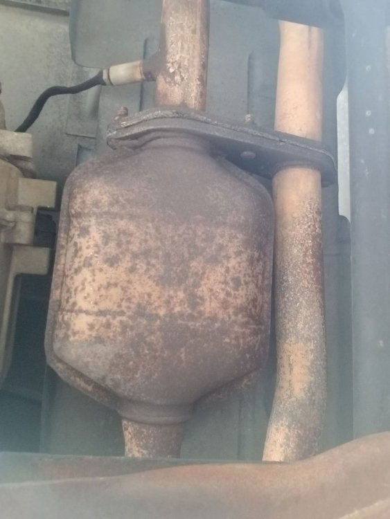

  3. Ok, good point, I can just cut out the whole flange and re-connect the other pipe.
  4. One of my catalytic converters started rattling, any suggestions on replacements? I see there are some cheap ones on amazon, anybody have experience with them? Also, how hard will it be to replace the rear one that is right up against the flange? I believe the forward one is making the noise, but I would just assume replace them both.

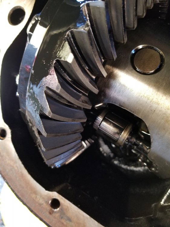

  5. Ok, just to finish the story here, I finished up the rear end. The pinion bearings were both bad. I ended up buying the True Trac, Amazon had a decent deal on a "used" one, which is just one where the box was all beaten up. I bought the USA standard gear diff overhaul kit, they make one that comes with the larger carrier bearings needed for the True Trac. I will say that I had to put in about .005" less shims on each side. I think most of the difference was due to the different bearings, so make sure you get a kit with a selection of carrier shims. Now I just hear funny noises from the front end...

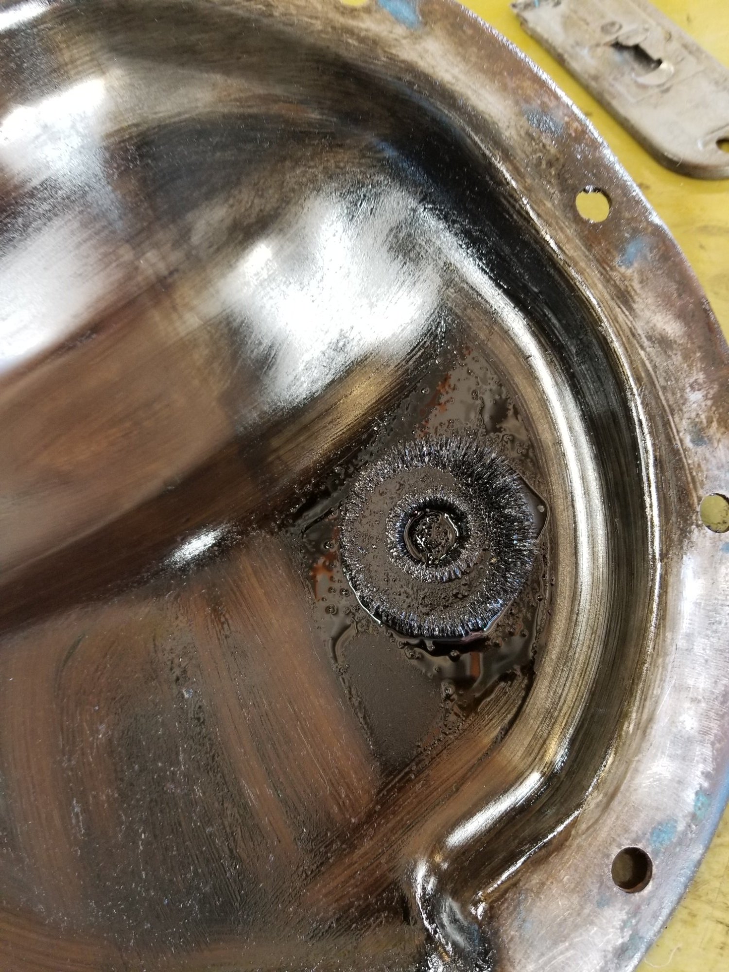

  6. I looked into the Napa door handle, but they didn't seem to have the right color. Got the OEM, looks and works perfect. I noticed some noise coming from the rear end, so I pulled the cover off, it looks like one of the bearings is on it's way out. I guess that's my next job. I checked the backlash, its at .008", so I don't think the R&P has seen much wear. There seems to be a lot of options for rebuild kits from Rock Auto, should I pull out the bearings to see what brand they are before I order a rebuild kit? Or are all OEM bearings Timken? Also, I have the gov lock differential in there, it seems ok but I know they have a bad reputation. Should I replace it with a true trac? Or should I just leave it alone? I would rather not spend the extra money right now if I don't have to, but I don't want to risk a failure here either.
