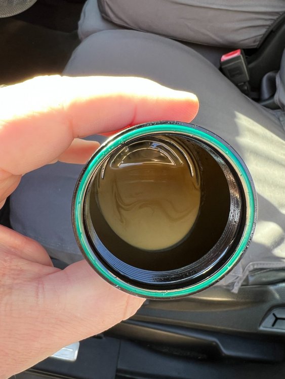

  3. Good afternoon gents, I finally got off my fat arse and installed my can. I think these pictures where around 7 days of collection. May be 2 weeks I honestly can remember. Maybe around 500 miles max. I'm in south Georgia right on the Florida line. We do have a lot of temperature fluctuations with humidity. This seems like an awful lot for such a short time. Means this has been going into my intake for 144k miles? This about normal for my year? 2014 Silverado 5.3 Thanks Martin
